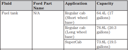

Regular or extended cab? That's the break point, the longer cab allows for the much longer fuel tank...
p.231 of the 2004 owner's manual

Thank you, without knowing the capacity or if the fuel gauge was accurate or not I was timid to run it to low. At least now I know about how far I can run it low one time to see where the fuel gauge gets to. Plus I can let me knucklehead son know "about" how many miles he can drive and to not totally trust the gauge in this one.
