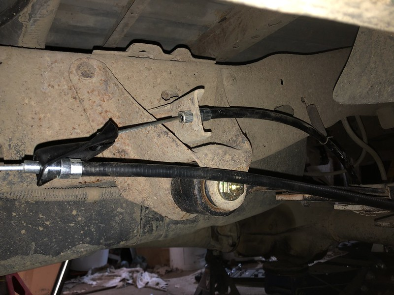

There are a few different ways to do this on a Ranger I believe.... but this is what I was talking about.
46873
The factory comes up with some cheesy ways to do things sometimes. I guess it's all to save a buck per truck or a couple of seconds putting each one together. I personally would set it up like the f150's if the cables would mount in a frame bracket. I always home make my repairs on the system using u-bolts, and common hardware. They live a rough life on the outside of the frame.

Very Cool! I appreciate the photo (every picture tells a story, don't it!). I also appreciate the do it yourself advise. I typically do one" off things" to most of my projects but only if I understand the operations and effects of what I'm doin! So, thanks to all for your inputs. This site has been a huge benefit for sourcing info, experience, and parts. Oh yeah, and opinions too!😂
Would ya happen to have a part number for that equalizer piece? It didn't come with the Dorman cables I purchased.
Ford (6L1Z-2A602-AA) ??

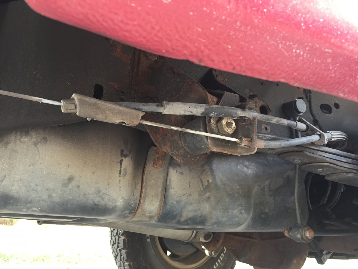

Here is a picture of my cables for you.
46915
What a rig. Looks like the fat cable slides in the frame bracket. When you pull on the cable up front, the large cable just slides in the frame bracket, and it pulls on the smaller cable, applying that side e-brake. When those shoes on that side get tight, the small cable stops, so that stops the large cable sheath from sliding and as you continue to pull it starts pulling on the large cable guts and starts applying the e brake on the other side. I suppose it works.
Thanks guys, I now have a clue!! Not sure about what, but I’m definitely havin a clue 😂😂
That is the exact set up I described. driver cable should have a return spring to the frame to pull it back.... just saying.
