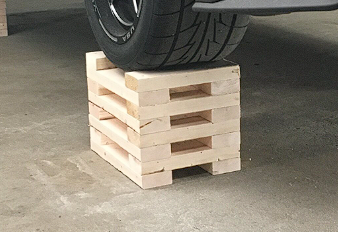

I made two sets of wooden wheel cribs like the below for the front tires, and then two 6 ton jack stands on the back and it is plenty high and very stable.

on my cribs I drilled vertical holes at the corners and ran threaded rod top to bottom with large washers.
keeps them good 'n tight and allows for height adjustment.
