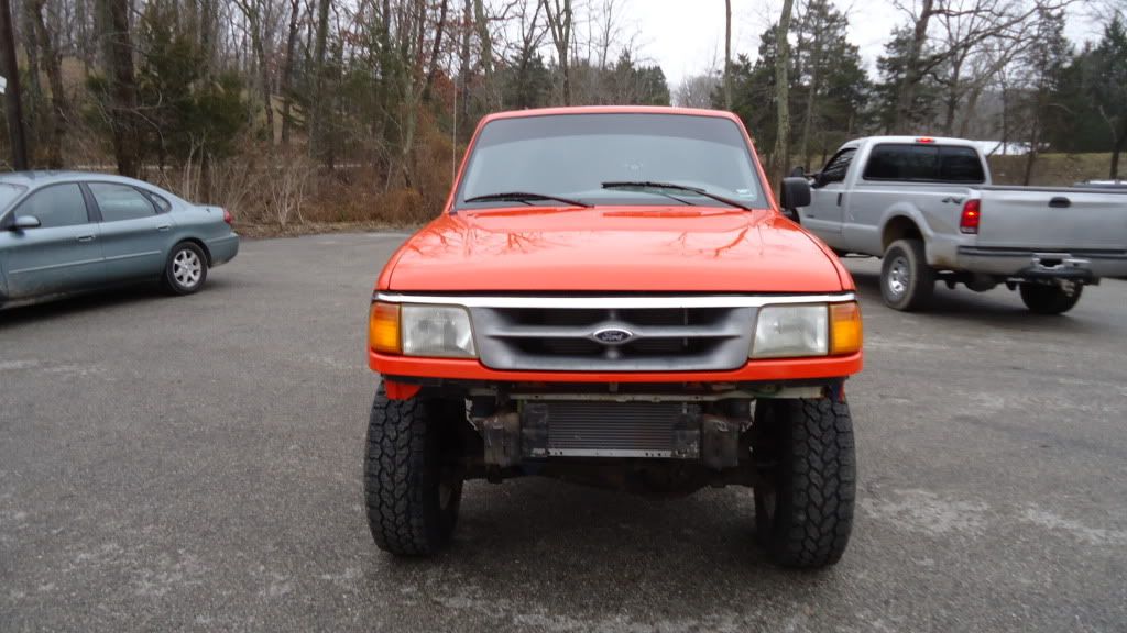

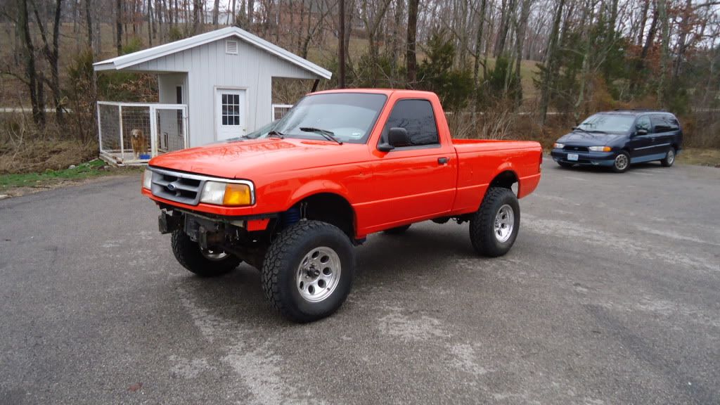

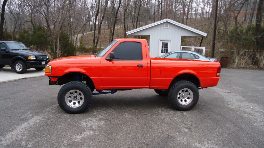

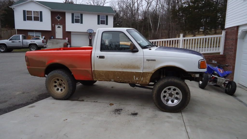

That looks really good, a little tall for a short course truck though, isnt it?
that's still a sweet truck... i LOVE that color!!!!!!
but i agree with benny? is the height right?
It is in fact a bit tall. I have about 4" of lift and around 8 inches of up travel with 35" tires. I can clear the 35's lock to lock. I also have gobs of ground clearance. I don't know what the rules and regulations are for what you plan to run. I am using a 10" stroke coil over shock. I can move the upper shock mounting to run a 12" stroke shock to allow for some more down travel.. But with stock steering it'll be useless...
These trucks already have a ridiculous roll center.. Raising the COG just makes things worse...
Yea , its kinda turned directions a little as far as short course racing goes, i will enter it and be careful, but more geared toward dual purpose now, gonna do some trails with it also and drive it on the street.

I may have missed it but what series are you going to be racing in? maybe its different out here in az but when we built a short course truck we did a 2" body drop, 1.5" deaver lift springs up front and a low profile progressive deaver pack. we have around 11 to 12 inches of travel and run 32s.
yea this is prolly way diff than what you all have, theres really no rules, and the competition, is just usually stock beater vehicles, like geo trackers, s10 blazers, no rules, otrher than windows down, must have seat belts and good brakes. Its Tuff truck series that runs along side with some figure 8 mini car racing, but it pays well $500 for 1st, won that in stock ranger so should be able to again in this truck.

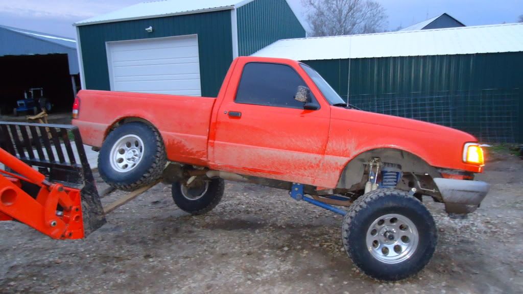

Giving little flex test, mainly gonna run trails at this point, I'm hopping to eventually move to Arizona and then more go fast suspension mods will be needed :)
