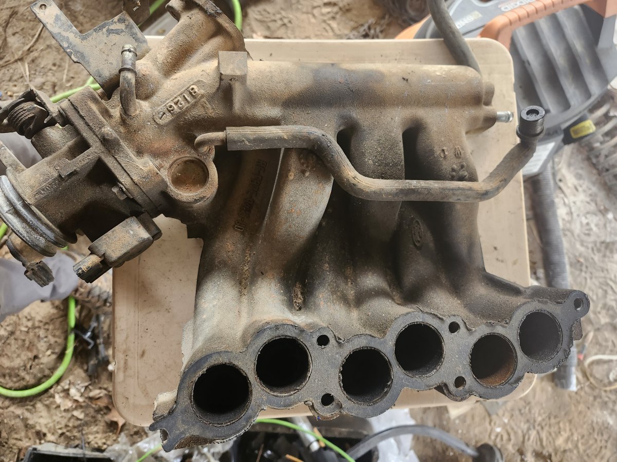

Good morning, I need some clarification regarding my 95 rangers upper intake manifold. I have a 3.0 that I got from Facebook that I've got together and in the ranger. However, neither of the upper intake manifolds I have seem to fit. I've tried doing my own research and parts finding but with little luck. Any guidance would be appreciated.

The 3.0l Vulcan was also used in FWD Taurus/Sable so different intakes
Head gaskets were also different
