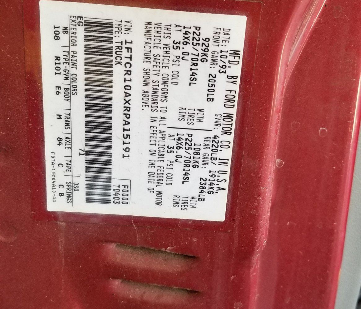

Here is the door tag and the size of tires on it

With the originally sized tires, my 1998 with the 2.5 worked well with a 4.10 rear end (same size as what your door post sticker says). Going from a 26" tire to a 29" tire is a pretty big step but looking at this chart: https://www.therangerstation.com/how-to_pages/gear_ratio_tire_size_chart.shtml
It looks like you might be ok. The Lima engines need all the help they can get, so going lower might be a better option.
If you look at the chart, the 4.10 gear threw the 1998 right at the bottom of the power towing band. So it will hurt fuel mileage. That being said, my 1998 was getting 21-22 mpg with the original 3.45 axle and was struggling to get out of its own way. Going to the 4.10 axle, there was no change in mileage and the truck was no longer struggling. Just something to keep in mind for your project.
Finding an axle with a limited slip might be tough with the 7.5. If you find one, try to go with one that has a Torsen. They use gears for operation instead of clutch plates. So no clutch plates to change when they wear out and no additive required for them to work. I don't remember when the cut off was for the smaller pinion flange being installed on the 7.5. If yours has the bigger flange, going to an 8.8 might be the better option. More axles out there and more options. There is nothing wrong with the 7.5. So if you find one with what you want in it, don't be affraid to grab it up.

An 8.8, from '93+ Ranger, bolts right in. SuperCab with 3.0/Auto would be prime source for R7, FX4 would be almost guaranteed to have one. Now, the R7s probably have 10" drums and yours will have 9" (based on Regular Cab/2.3/Manual/Payload Pkg #1 off your Federal Sticker), so rear brakes will do a little more work (Might lock up in panic stop with box empty in wet). If you are really concerned about it, you can pull the axles and install your existing brakes on the 8.8 (an option if you would sooner change the differential oil rather than bleed brakes in any case - also makes axle more "portable/cheaper" from recycler if you leave axles and brakes behind).
Axles and brake mounts are identical for all Rangers from '93 to '09 with exception of the FX4 lvl 2, so swapping is option.
