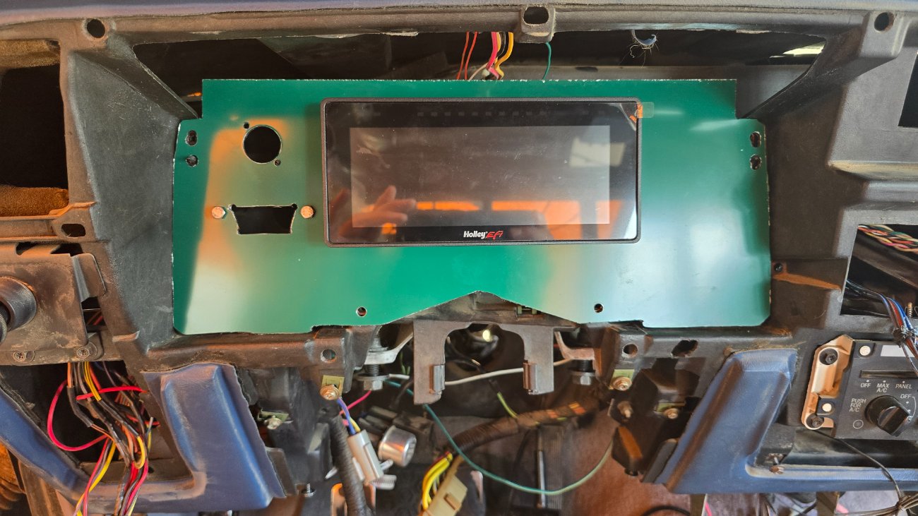

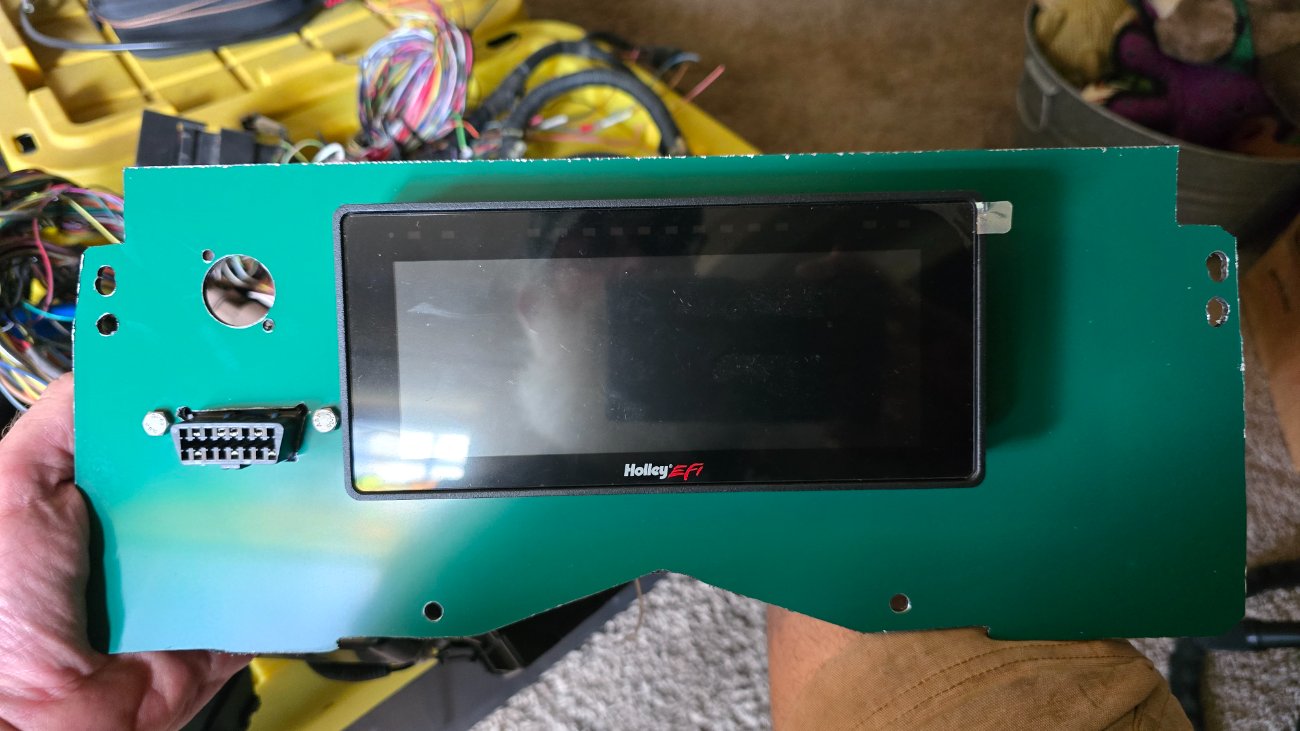

Decided to work on the instrument cluster/screen thingy. I was originally going to design a piece to be 3D printed that would hold the screen, it's remote USB ports and my OBD II port. But it was difficult to get accurate measurements for the mounting points. I might still do that one day. But, I remembered that I had this aluminum/plastic/aluminum sandwich material that worked so well for my custom visors. So, I made the mounting plate out of that. It's not petfect. But it's a good, snug fit and will look good with the trim bezel put back in place. Warning; NOTHING is symmetrical about this space and the way the gauge cluster mounts. Do not assume symmetry anywhere.

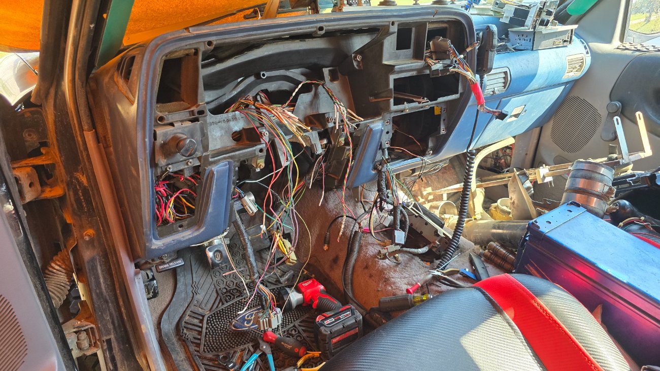

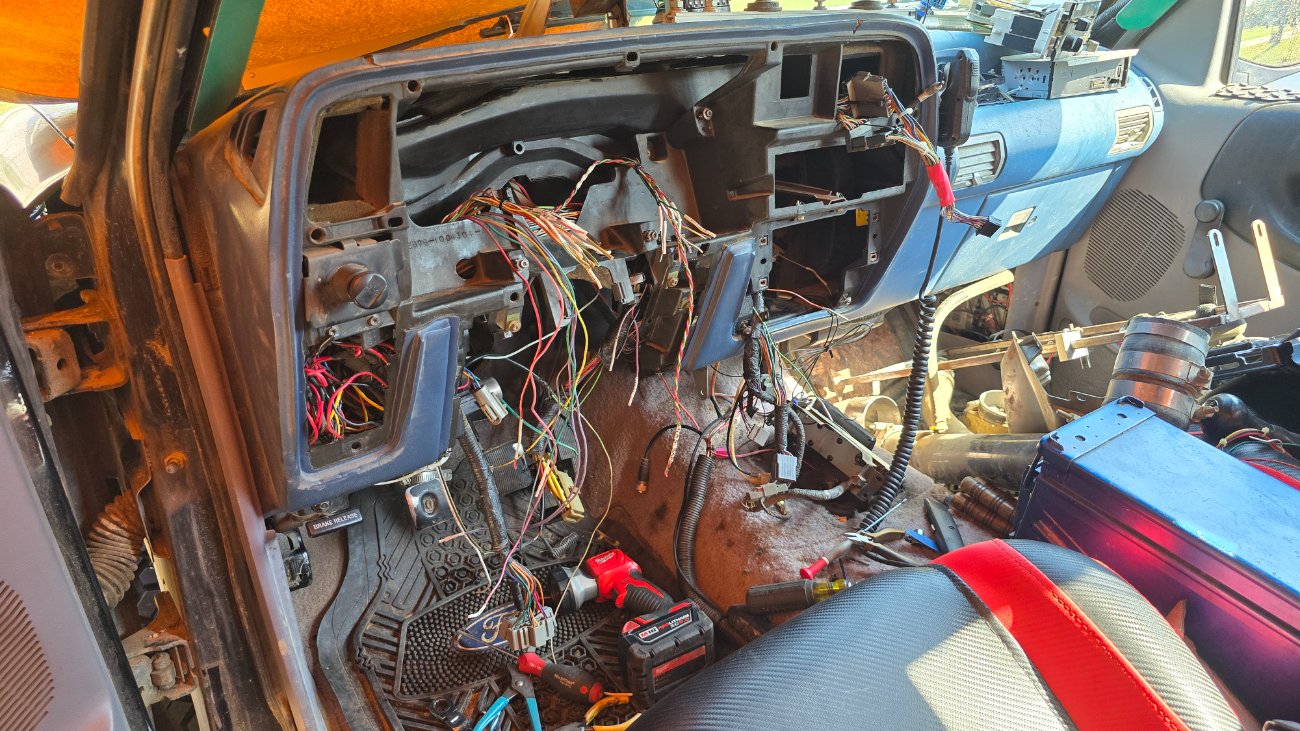

After the rain, I went back out and worked on removing obsolete wiring. I got the rest of the transfer case controller wiring removed. Also started removing the RABS module. There's not a lot to remove and I'm not pulling the dash for complete access. So, some dead-end wires will remain in place. But I want to get as much out as possible to clean things up. A few things may get re-purposed. Plus, I need to sort out the gauge cluster wiring and prepare whatever will be re-used with the digital dash package.
More wiring cleanup today. RABS is removed. All the gauge cluster wires are cut away from their connectors and labeled for easy identification. Some extra wires are pulled out of the harness. But I want to get them free all the way back to the firewall connector if possible. I believe the engine is electrically disconnected from everything.

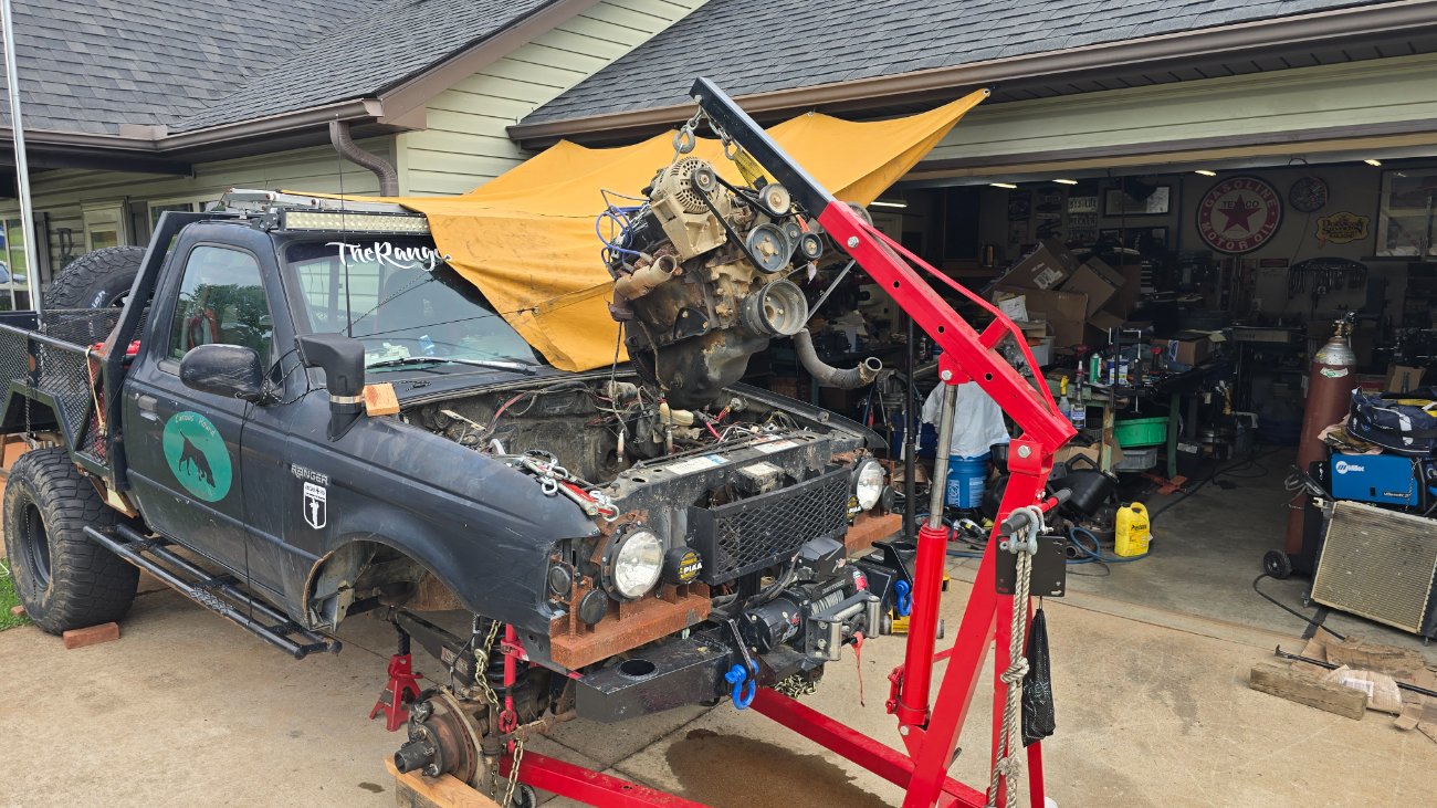

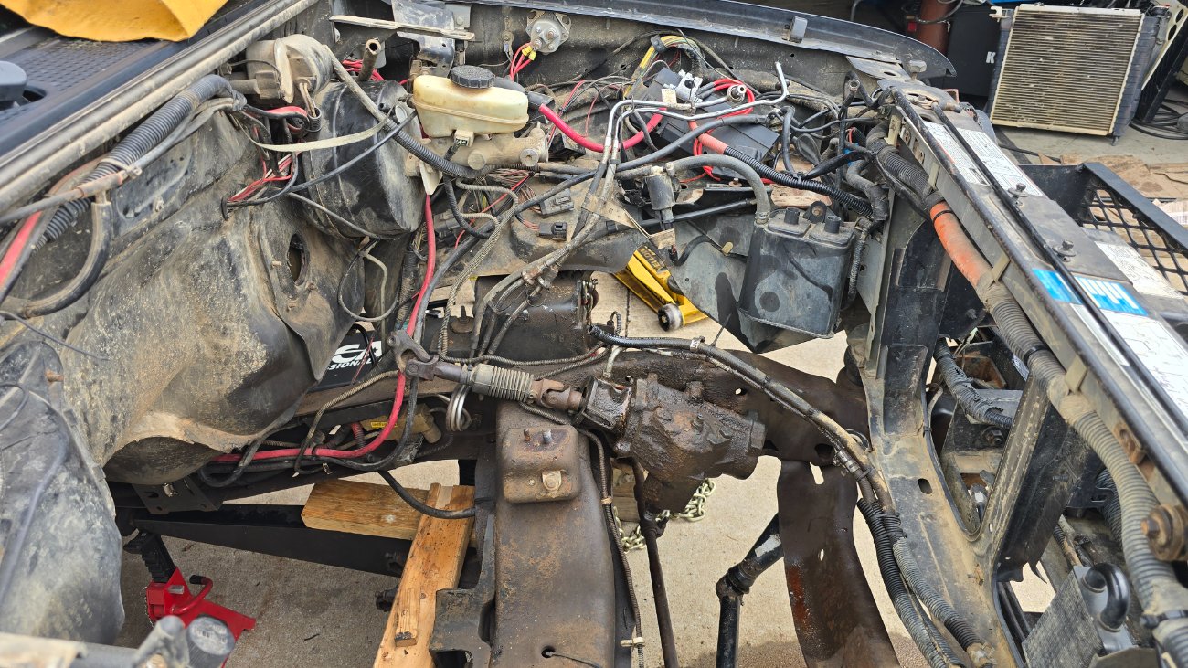

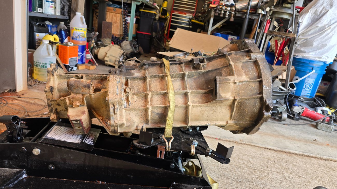

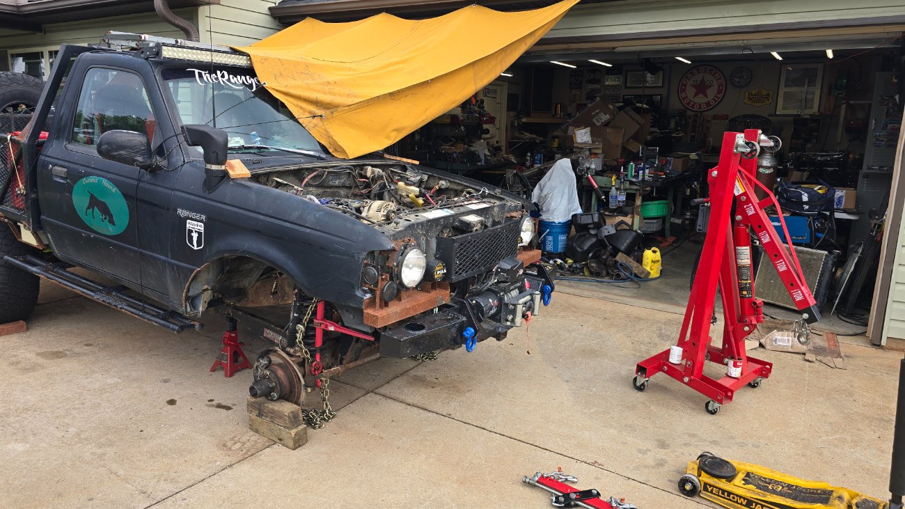

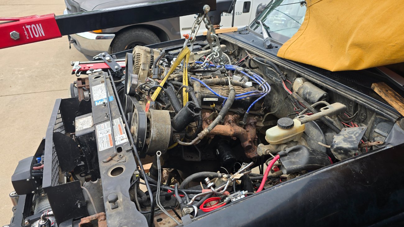

I quit for the day. The transmission is out. The engine is completely disconnected from everything except gravity and ready to be pulled. Upper intake is off. The steering gearbox is hanging on by one loose bolt and the return hose that goes to the cooler. The pittman arm came off easier than expected.

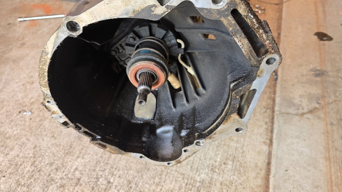

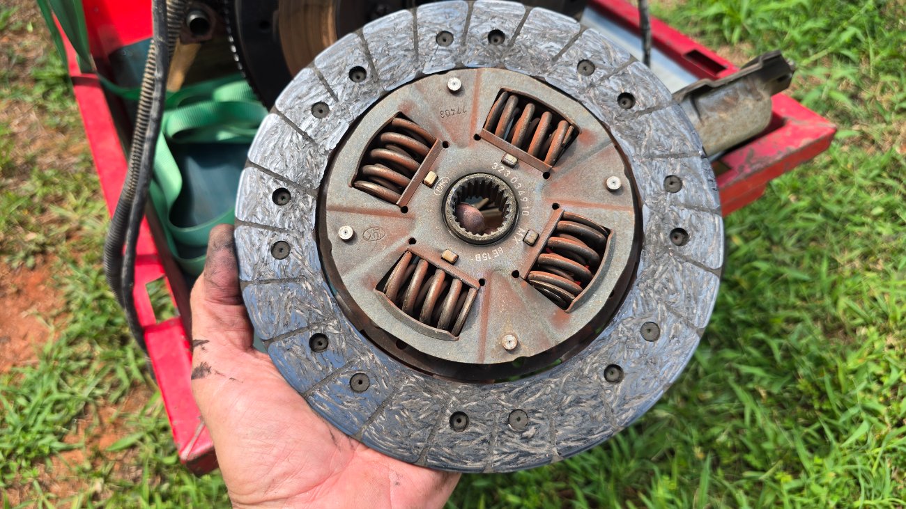

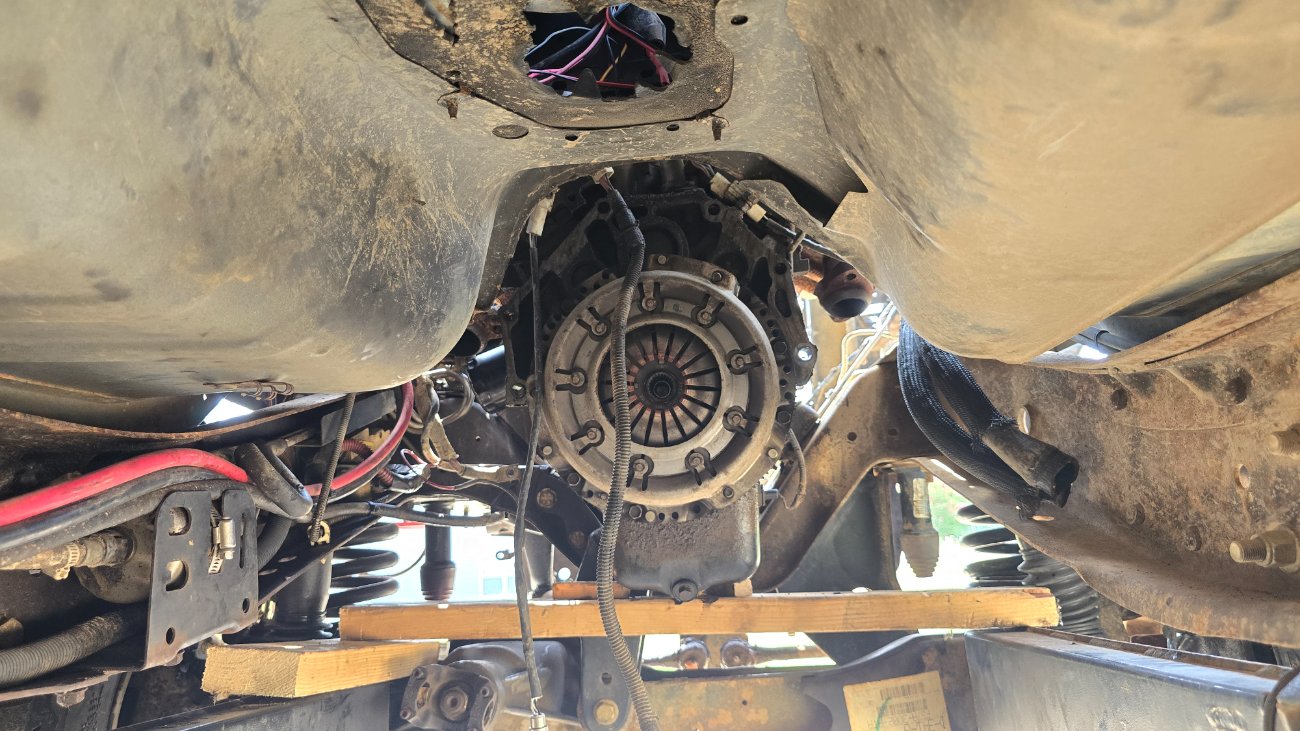

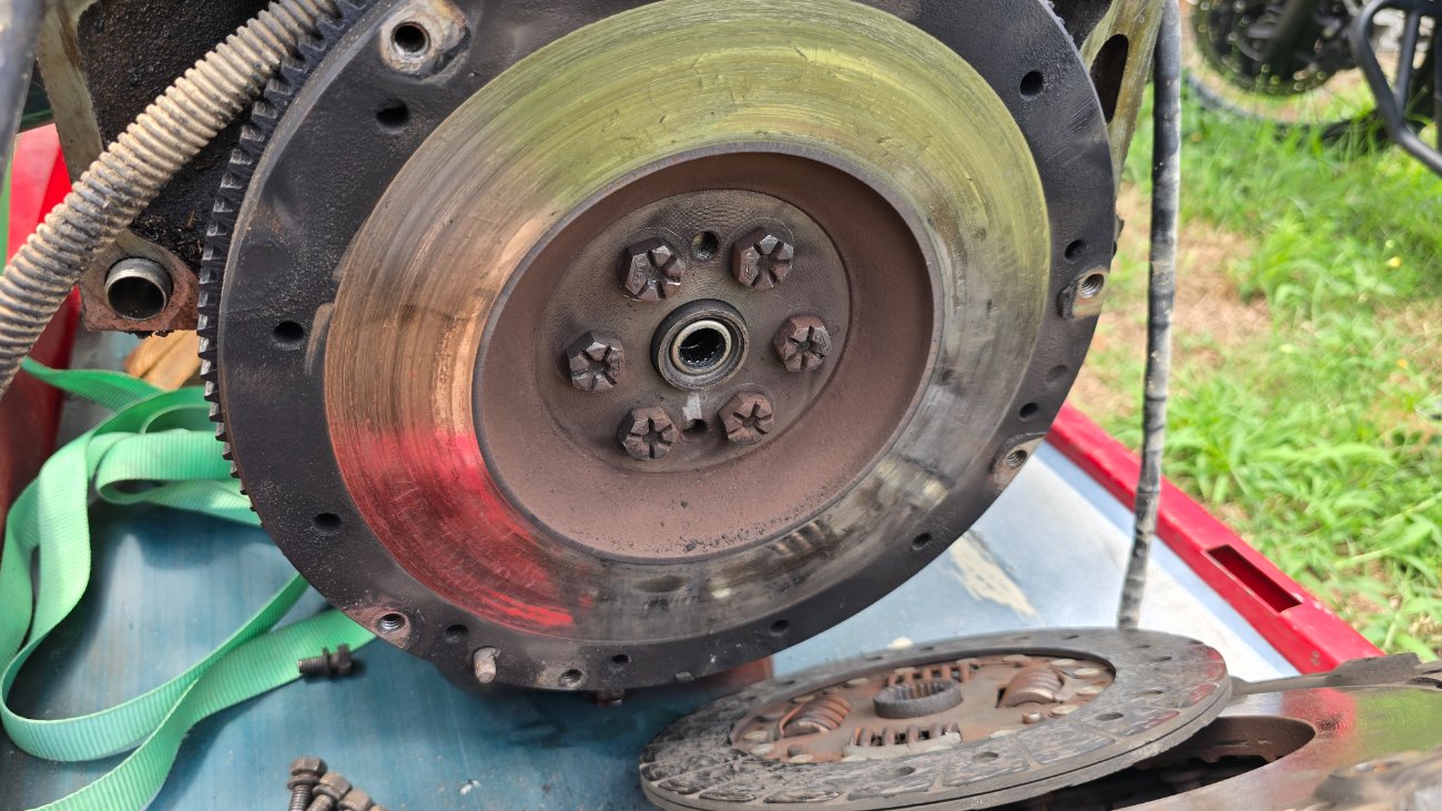

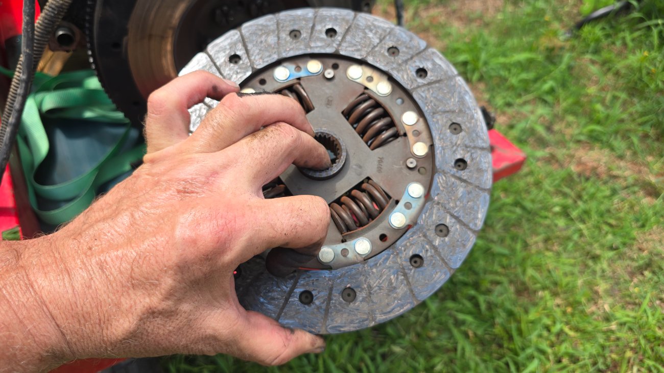

So now we need to see the flywheel and clutch plate wear. For SCIENCE!
I am curious. That brand new clutch went to Southington for the TRS 20th anniversary, where I had lots of smoke rolling off it in at least one obstacle.
today's primary goal accomplished before lunchtime.
Bow before me, beast!

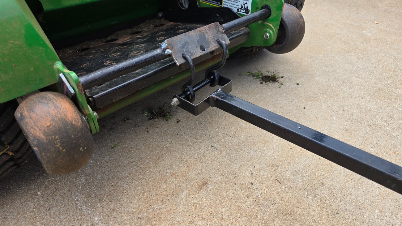

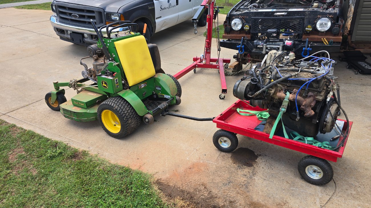

Then, I made a trailer hitch for my "tractor" so I wouldn't have to pull my little red wagon by hand. Also inspected the clutch. The grooves in the friction material are basicly gone. It was time to start planning a clutch job.

You gotta take that rig around the block this evening to just give the neighbors something to talk about.
They probably already talk about me.

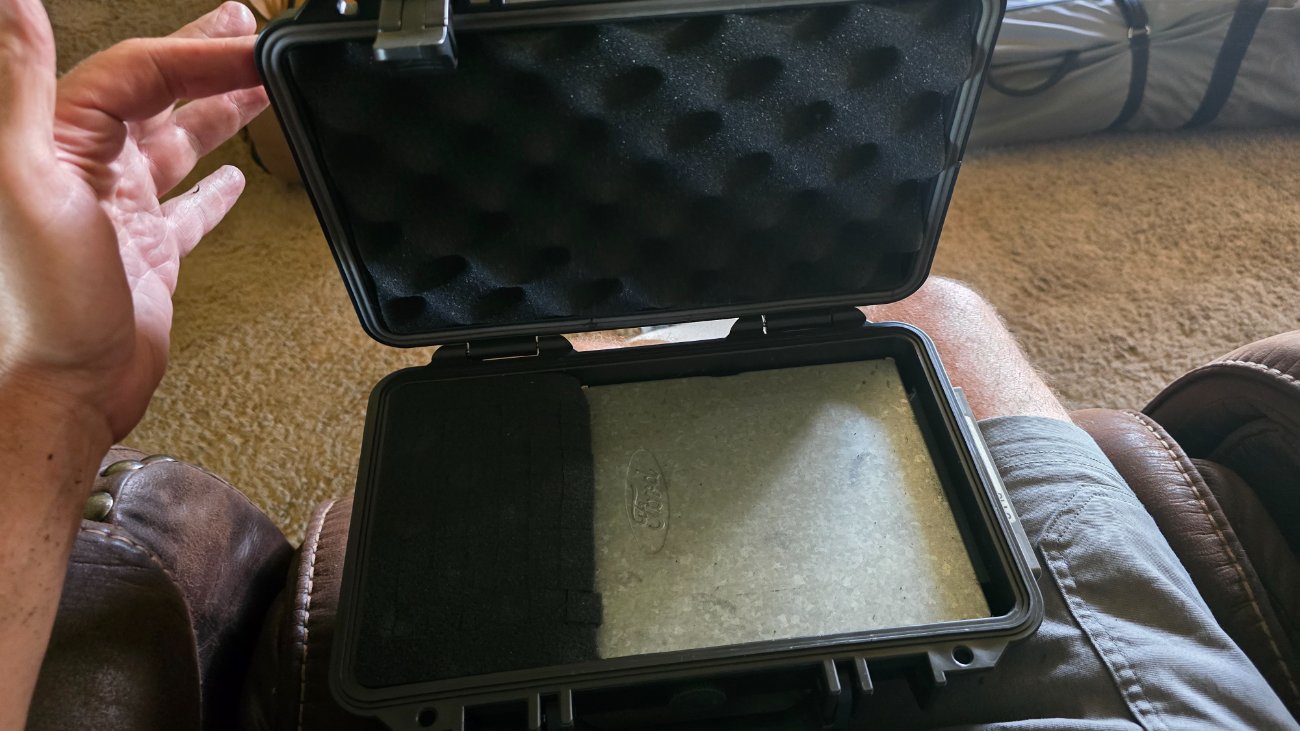

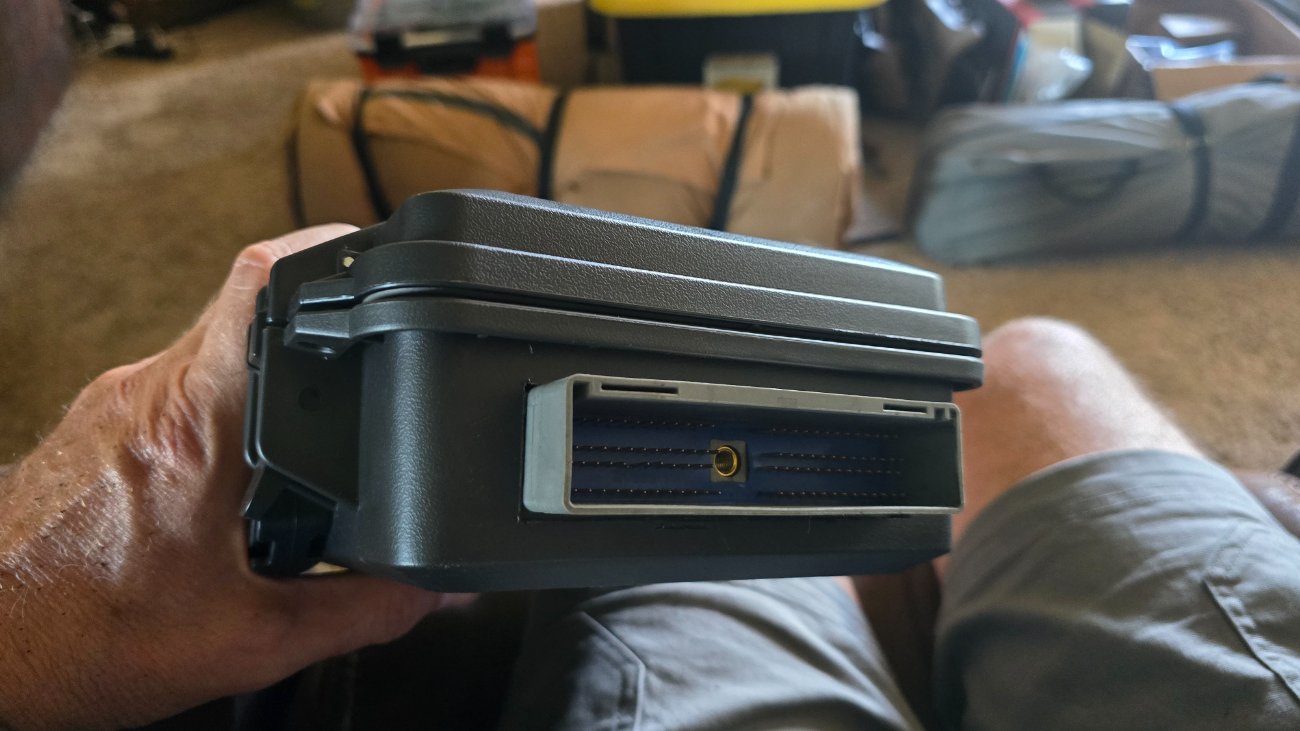

I think I have an idea for mounting and protecting my PCM. The 5.0l harness doesn't reach to the PCM location in the 93 Ranger. I don't want to do a bunch of sketchy, bulky splicing of harnesses. I think I can mount this above or behind the intake and the harness will reach.
And there's still room to keep a derringer in there for traveling through bad neighborhoods.
