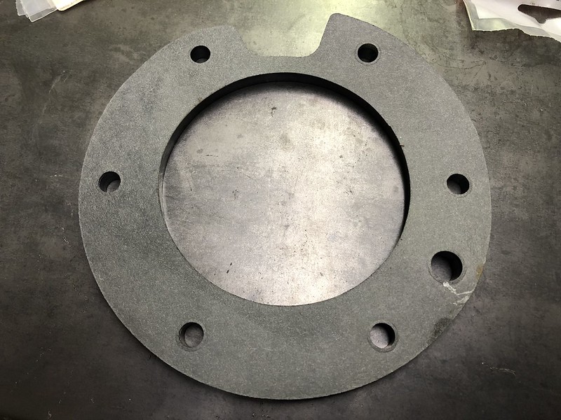

Well you see that pattern is very old... the offset is probably at least partially influcanced by the locating dowel and the notch for the shift rail on old t-cases like the NP-205.
This is a spacer I had cut out to hang a NP-205 on the back of a 2004 M5ODR2 that previously had a BW4406 on it:

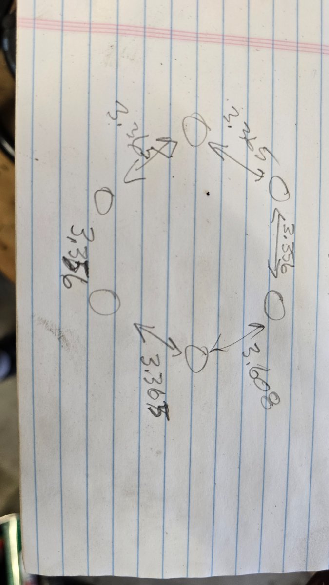

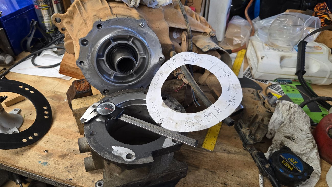

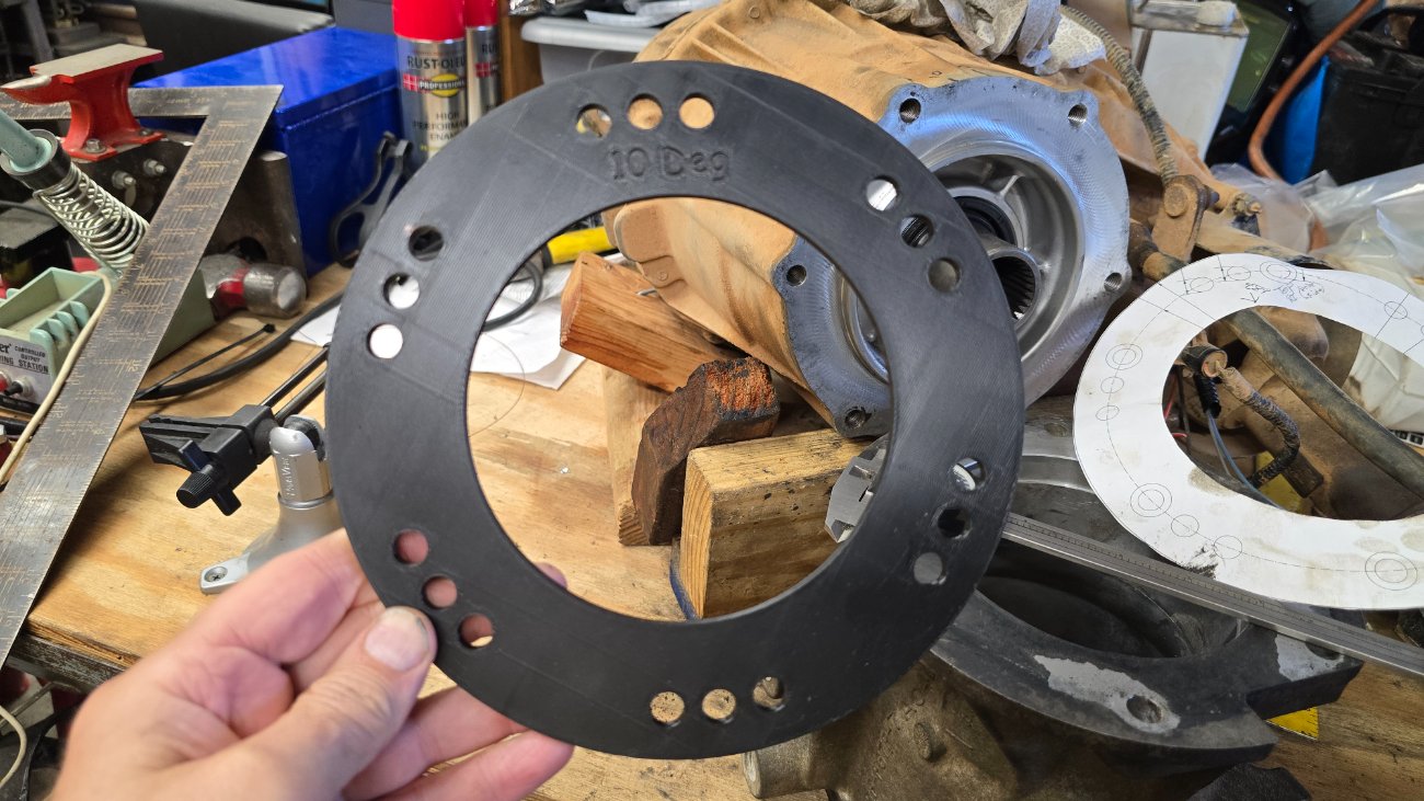

So, rumor is that to fit my 4406 t-case under the Ranger, I will need to clock (rotate) it a few degrees because it won't fit between the frame rails. A while back, i saw a clocking ring on the internet. But it was expensive. Over $200 if I recall. I figured I should be able to design one and make it or have it made for a lot less. So, i took some quick measurements, designed a ring and added 2 extra sets of bolt holes at 10 degree intervals. I thought I could have a template 3d printed that I could then use to mate the t-case to the transmission tailhousing and figure out how far to clock the t-case so it would clear the frame rail.
Well, it turns out that the bolt holes are not evenly spaced around the housing. I made my template with a nice neat even 6-hole bolt pattern. And only one hole matches up.
Back to the drawing board.
My 3d printed template. 3 nice 6-hole patterns at 10degree intervals.
Here are the actual bolt spacing distances around the circle. You can see that most of the measurements are close to the same. I'd like to hurt someone.
