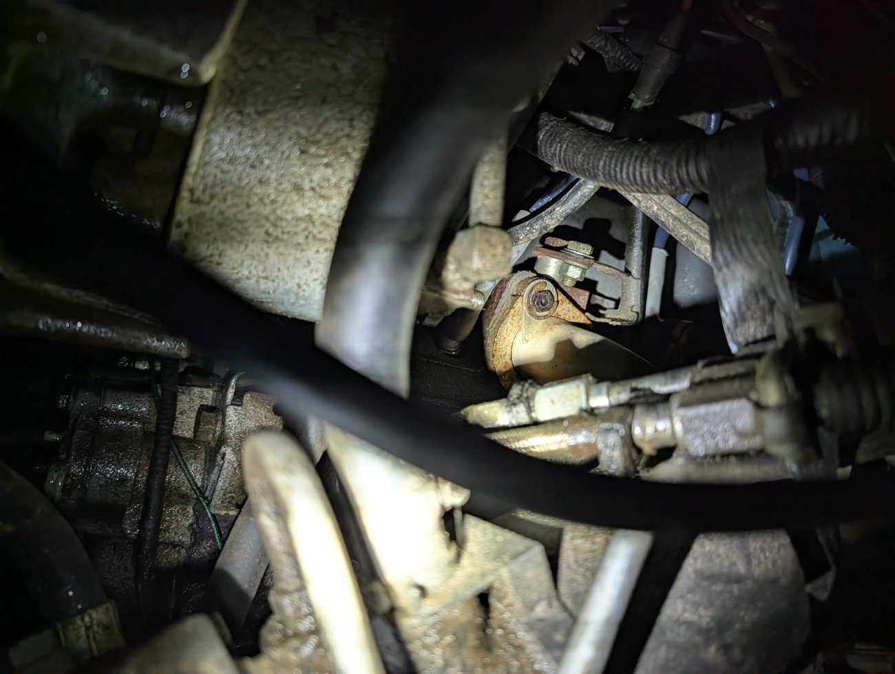

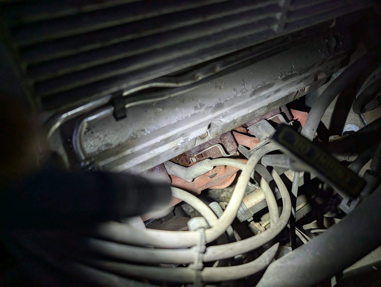

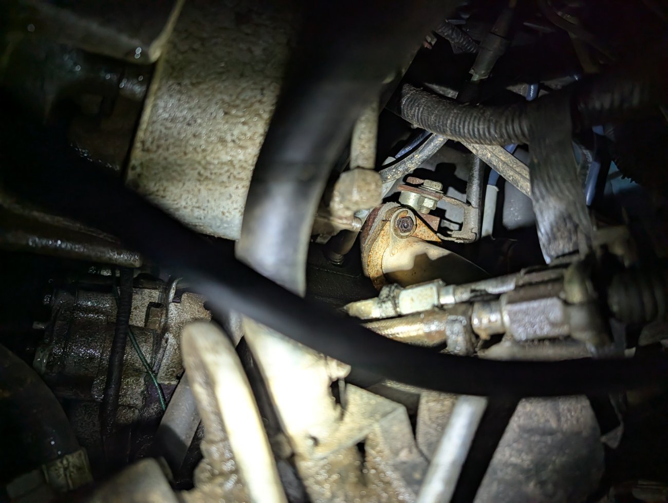

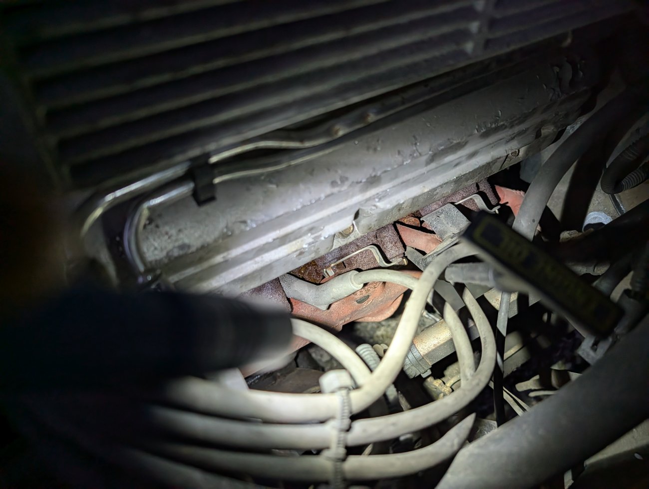

I am running some 289 "log" manifolds from IDK what application on my 5.0 Ranger and they clear everything by a mile. I did swap to GT40 heads and sold off the GT40P heads that force you into the goofy manifolds/headers.
My passenger manifold exits straight back and my driver side aims down and back.
I recall buying a pair that were symmetrical but the driver's side pointing straight back was more hassle then it was worth, so I found a similar dr side manifold that exited more downward that wrapped around the oil pan perfectly between the trans and rear sump.
If you are interested I can take some pictures or dig some up. Probably wouldn't hurt to wake up that truck and pull it on to the lift for a spring time inspection anyway.

Thank you for the pictures.
I'll try to get more decenterish gooder ones this weekend. I did have to make my own y-pipe, but it honestly fell together with little effort.

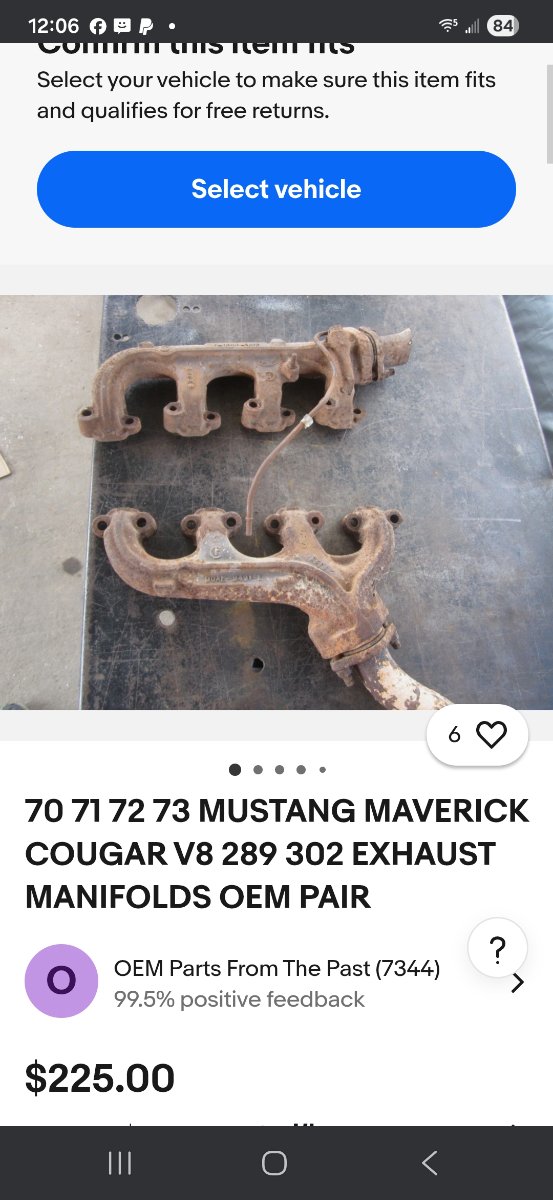

289 manifolds fit really nice, guys even use them for 351W swaps.
I had a set I sold eons ago, I kinda wish I would have used them.

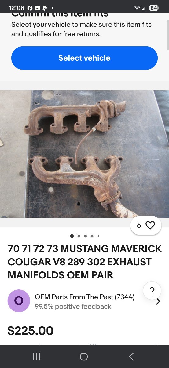

I assume this is what I would be looking for.

They do use an odd flange/ball socket at the collector that's tricky to find when it comes to building your own y-pipe. I bought some stainless down pipes from Pypes for a 67 Mustang or something and cut that flange off.lol. The rest of the pipes got up cycled into an LS400 exhaust.
Unless you get a set like you shared and they come with the cutoff chunk you need. That's all I kept off the brand new down pipes I bought
I used mid-late 70's truck 302 manifolds for my swap. They fit really nice and were dirt cheap. Some of them including mine have this extra little dumb ass piece with a flapper valve (looks like those Maverick ones have it built into the manifold.) It's not a big deal to remove but you need an extra gasket that's only available in a kit. So when you blow the donut gasket out, pray that you don't damage the gasket above it during disassembly or you're buying that kit as well.
