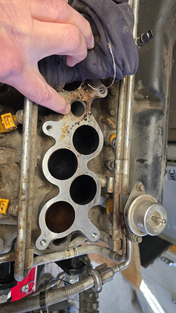

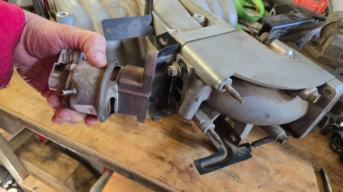

No external egr tube. In fact, that was a mystery that was eluding me until now, maybe. I thought it odd when I was removung the uoper intake. It looks like the exhaust gases pass up through the center of the intake and make their way iver to the egr valve internally. Truly a wierd configuration. Seeing your question, I just went out to the garage and figured it out.Wait, does that year not have an EGR tube on the passenger side? I can check if my mountaineer has a usable manifold on that side, if it does you are welcome to it... I'll know later today
Here, I'm holding what I assumed is the egr valve next to where it mounts on the upper intake plenum. (Don't remember which way the valve was mounted. Oops)
here, I'm pointing to what I believe is a passage in the lower intake that must lead to exhaust port(s) in the heads. Truly a "WTF" discovery.
