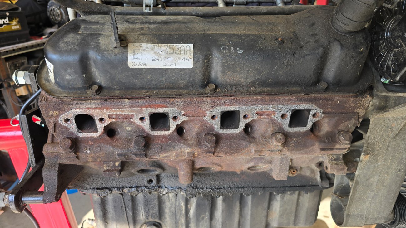

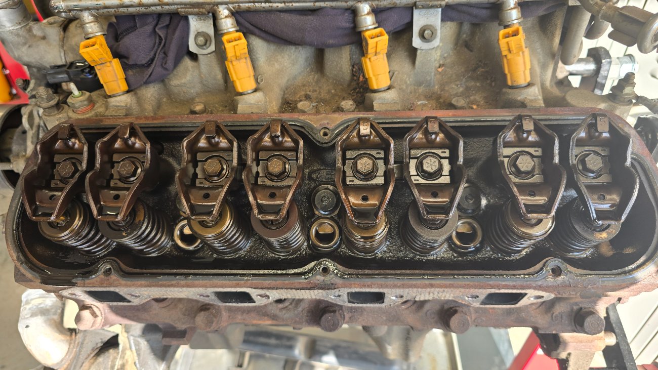

Anyway. Removed the remaining portions of the Y-pipes from the exhaust manifolds. Then removed the manifolds. After that, I opened up the val⁹ve covers for a quick inspection. Looked great. No sludge, no loose parts. I'll call that a minor win. Removed the oil pan. That's it for the day.
Huh. I THOUGHT I heard an exhaust leak. This might be it.

Wait, does that year not have an EGR tube on the passenger side? I can check if my mountaineer has a usable manifold on that side, if it does you are welcome to it... I'll know later today
if he dont i should have a set somewhere.
I know the one on my '98 is fine, I'd offer you the cast one off my '00 but that's slated for my '98... which I guess I could just swap out and be done with that :)
