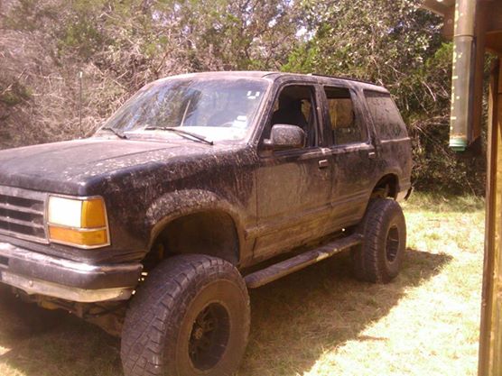

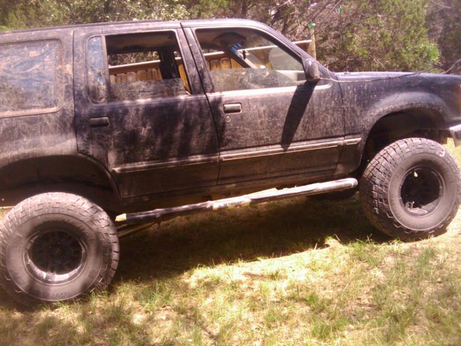

I just bought the explorer not but a couple weeks ago and have had to replace the rear main seal. The trany is in bad shape it wont shift till it red lines, i have to throw it in over drive double tap and back to drive to get it to shift through 2nd, yesterday my reverse went out, and its have a real hard time shifting it will go to 4th but the truck maxes out at 65, before I hear the drive shaft making a faint grinding sound. Should I get a whole new trany, or rebuild it(A4LD stock only has 50,000 miles since last rebuild). I think that its my engine trying to spin the 38" tires i have on there and is taring up my tranny over working it because it red lines barely pushing on the gas to spin the tires, I put 28" on it and its still doing to the same thing can anyone tell me what to do with my truck so I can drive it
