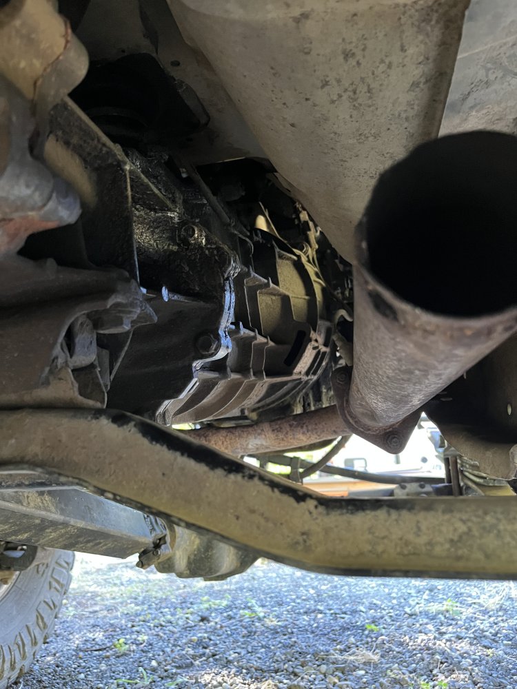

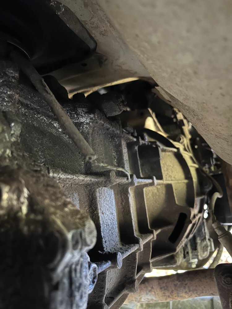

Does anybody know what this set of wires and sensor does it’s on the passenger side of the transmission they got ripped off at some point probably by a stick. Also checked my fuel pressure again and I’m getting 10 psi key on not running and about 28-30 while idle if and Erving up to 2500-3000

nss may be grounded. making it think its in neutral.

I believe the wires in your picture are for the transmission neutral switch.
