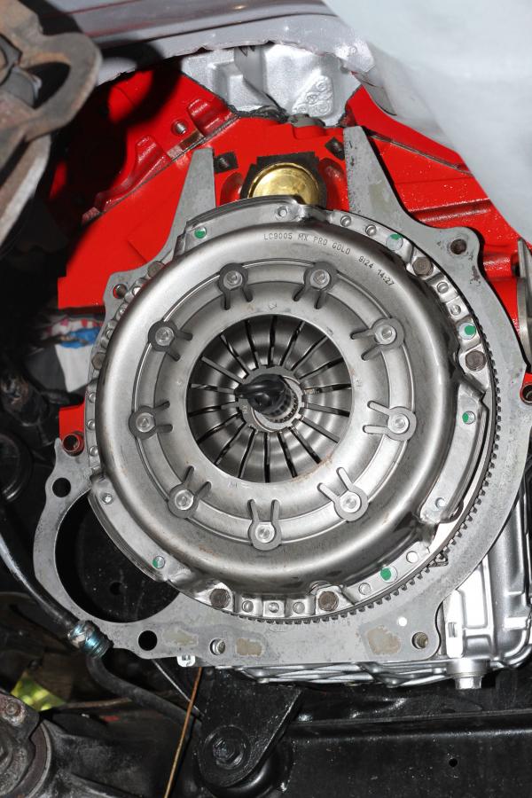

Tomorrow, I am going to try and crank the 4.0. I pre-lubed the engine a few minutes(turned the oil pump drive rod) high pressure melling oil pump. I am a old school carb guy even though I built a 2.9 before and got in running- I have no knowledge/sense of these computer- sensor- fuel injected engines. Because of this I am a little apprehensive. The exhaust is hooked up only through the y-pipe so that I would have the O2 sensor connected -Will this cause problems? I don't know. No headers on yet-wanted to do a short break-in first.

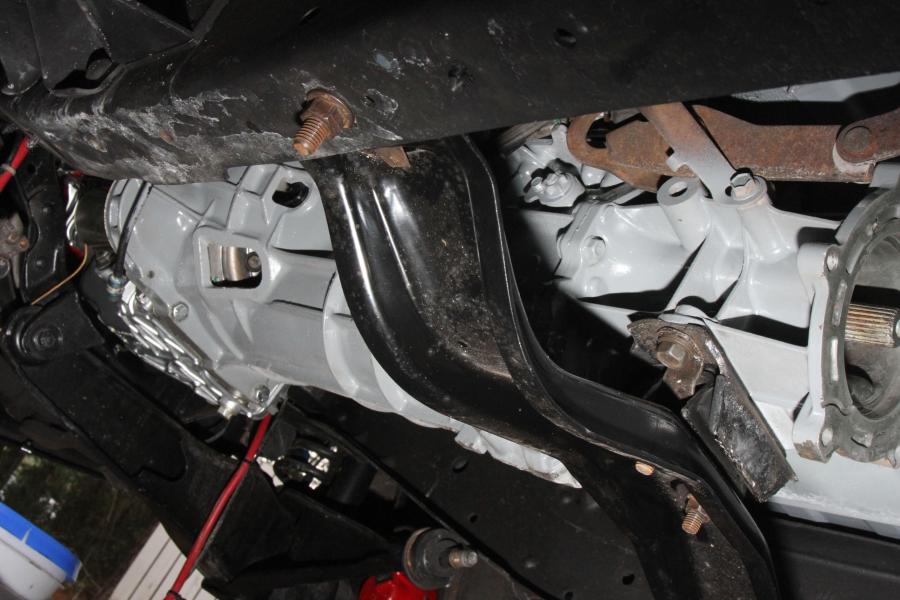

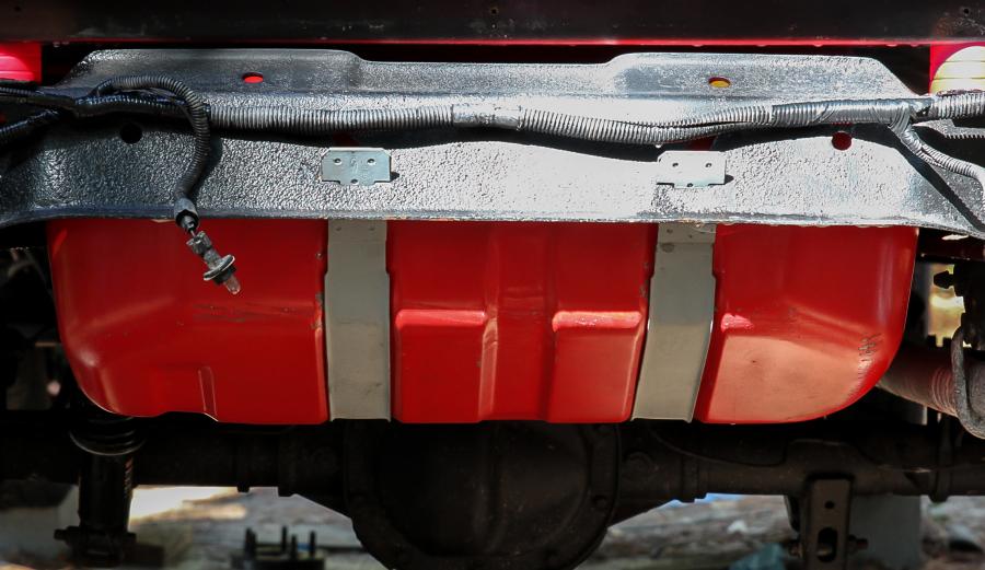

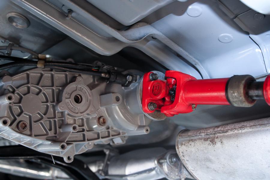

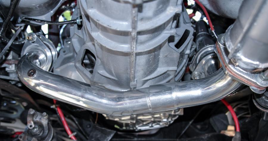

Been out of town working. Got the headers y-pipe installed and hooked up the exhaust. Would like to go 2 1/4" with a hooker muffler, but the exhaust and muffler on the BII are perfectly okay. We don't have smog testing here thankfully-I don't know how anything can flow through a catalytic converter. This is not a request for anti-smog clean air advocate posters. Also benched the transfer case into place and connected the drive shaft- that took a few choice words. I need to check the front drive shaft u-joints and then will get it in.

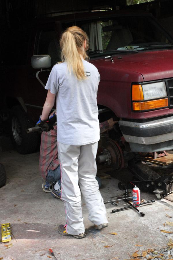

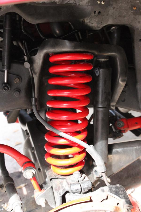

I know it's been awhile. Have had the BII running and been working out of state since Christmas and before. So it is time for some minor updates. I added 3 inch coil lift springs which my daughter helped with the grunt work!

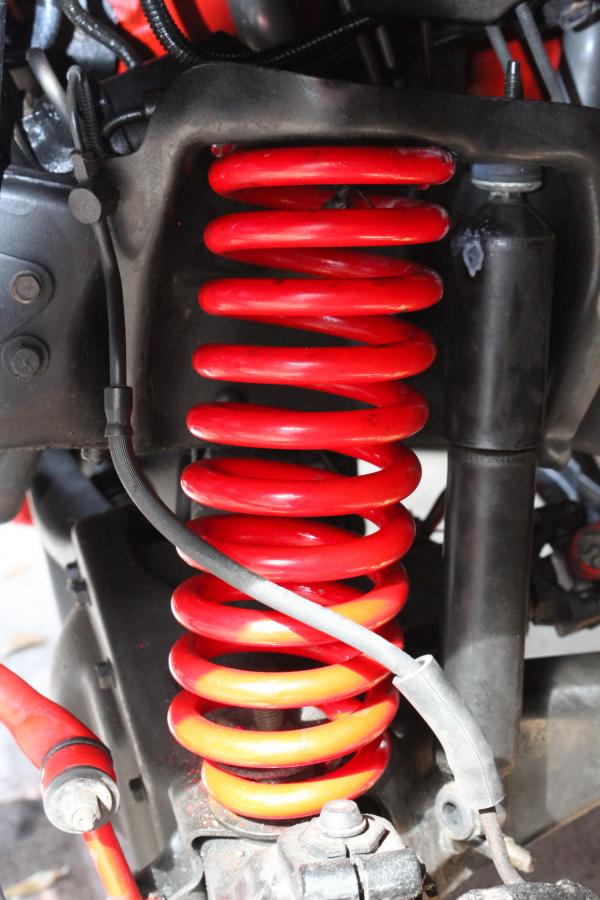

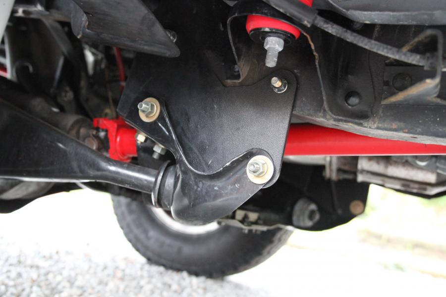

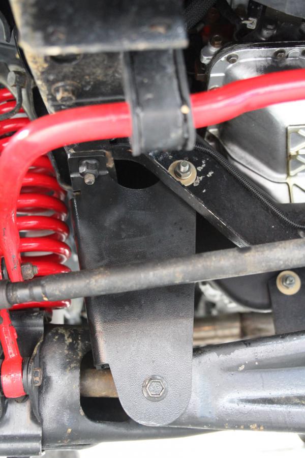

To flatten everything back out I added the radius arm drop brackets, axle beam drop brackets, and a drop pitman arm. New front shocks were added at the time too.

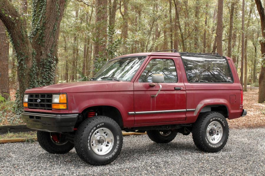

Of course, it needs new tires and wheels. But also I have welded a stack of 3 1/2 inch washers to give me another inch of height on the front-plan to add this weekend. I will deal with the back when I see the results. Changed out the dented front bumper too and went black(maybe yes, maybe no).

Thanks dirtcowboy. You qualify to be an Appalachian redneck with all those vehicles-and yes, America that is a compliment. So I did take care of the welded washer lift in front and added 2 inch blocks in back-already had 2 inches of rear leaf spring lift. The next projects as you know always predicated on $$ supply will be new carpet and maybe a paint job- I do kinda like the rugged paint look though.
