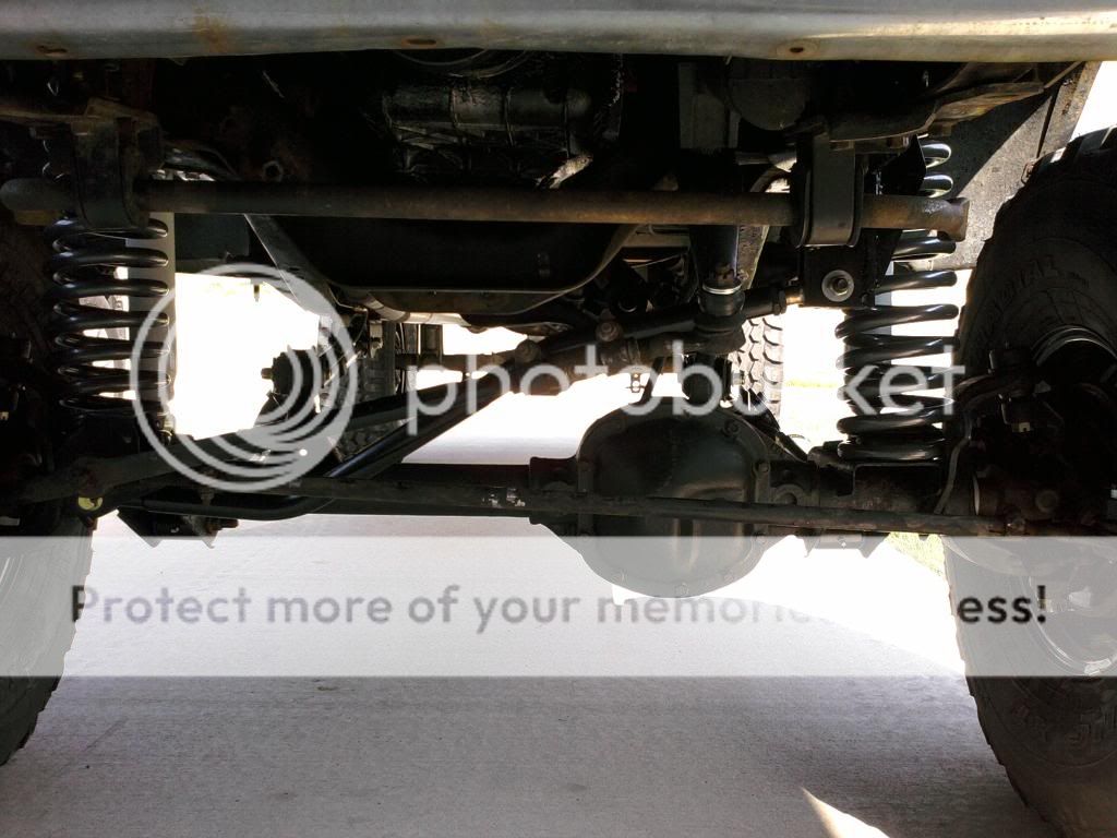

where did you get that pitman arm at?
No idea. I do know I got it off the internet about 7 years. Could if been eBay, a forum member, or a company. I bought it to piece together a lift kit back when it still had the ttb d28.

do i need a ranger pitman arm or can i get for example an f150 or full sized bronco pitman arm
That would depend on where you mount your trackbar bracket. The trackbar and draglink should be parallel.
Should look close to this
oh and be sure to OVER BUILD the trac bar braket (if you plan on running it hard)
my original one started to tear off the frame (taking the frame with it) so i removed all of the bracket and plated the complete surrounding area with 1/4'' plate welded the perimiter and several plug welds and the steering box bolts go thru it aswell. havent had an issue since. however the front tires on my truck have been know to come off the ground.
