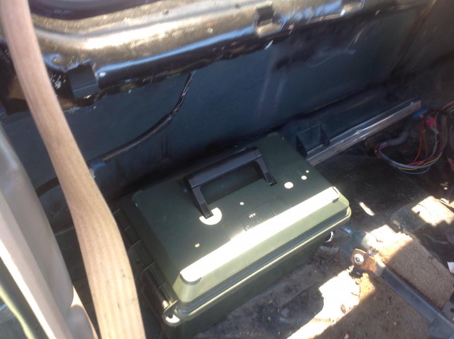

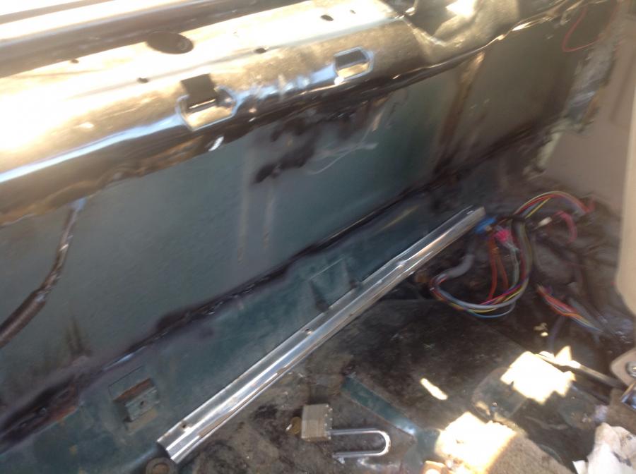

Here are a few. Not quite finished of course
I ran the back wall so the floor board from the rear seats was still inside the cab to give me some storage room. Actually ended up giving me more than I expected
There is room for a good size tool box with the seat going all the way back

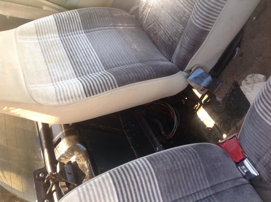

Still some wiring loose that will be taken care of when I get the vinyl floor in.
In this one the drivers seat is back to where I usually drive. I'm 6'1" , you can see pretty decent room for junk back there

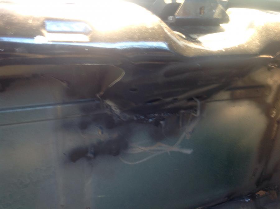

For some reason I couldn't get this one to focus well. The closure mechanism for the window. It's hard to see but I have a rod to pull to open the window and angle part of the interior frame on the hatch to the back wall and welded it. That added a lot at rigidity to the back wall.
I also went back in all the seems on th inside with body panel glue to make sure I had a good seal

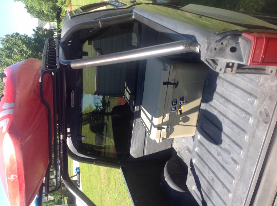

Packing for a paddling trip this weekend. First big run with the rack
One unexpected plus for the dip in the bed is the cooler fits perfect :beer::yahoo:
I welded in some trailer attachment hooks to strap stuff down too
