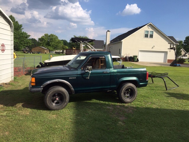

I ran into a snag on my rear fenders. To get the shape I want it's going to take most of the flare out of the top part of the fender opening. But leave some on the sides. Looks like I am going to have to try and do a little sheet metal work to get it to look right.
Hopefully get to work on it tomorrow. I have to fix the shift linkage on my sons car first. Then bronco time.
Been sitting on the wheels for a while now and finall couldn't stand it anymore. Put them on with my existing tires.
Also had a little experiment with some supposedly color matched spray paint. Got her one solid color.... Kinda :dunno:
Gives me an idea of what the final product will be anyway

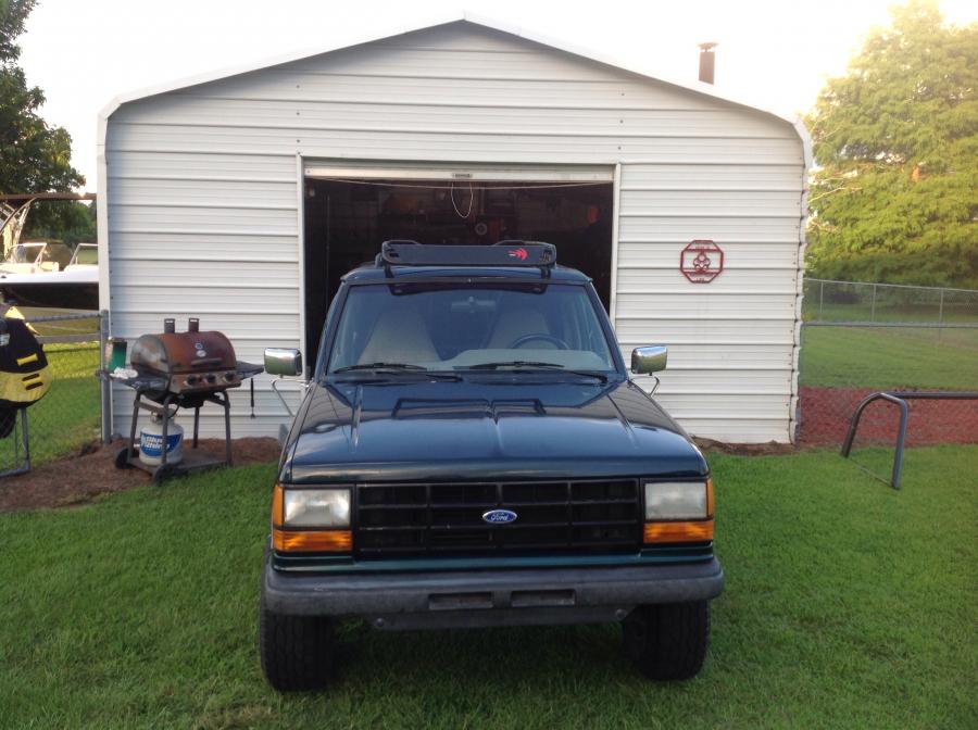

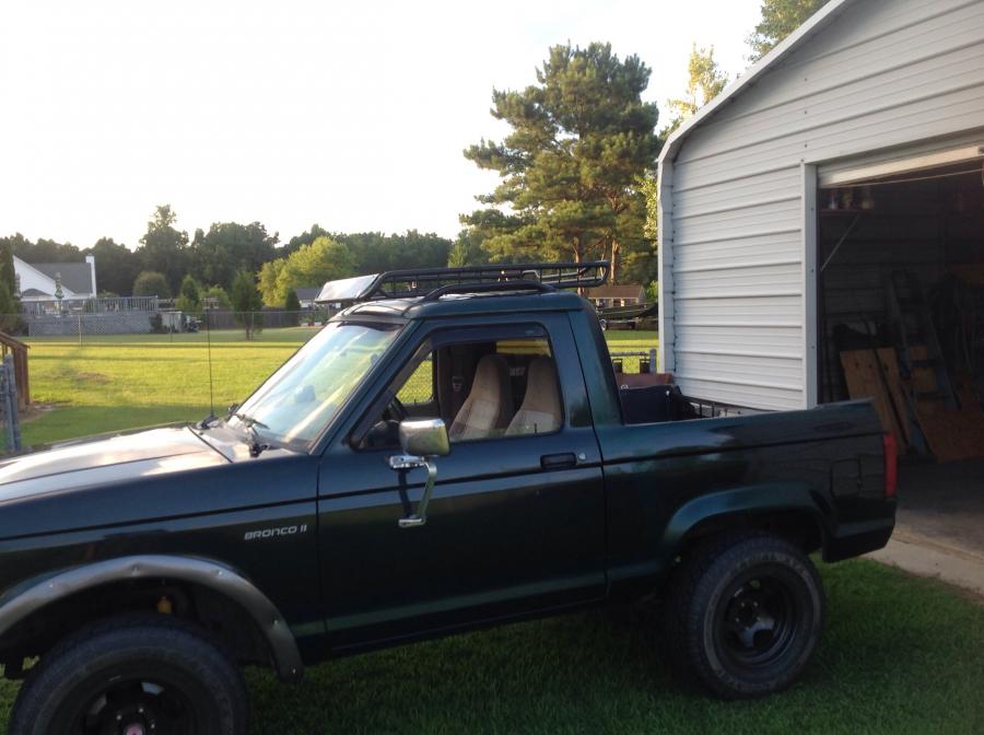

Ok did a couple of paddling and camping trips with the new rack and it worked well. But since doing just day to day stuf with the truck I didn't like the rack being in the way of accessing my bed. Dropping back to punt a little Will have new picks tomorrow. But spent today reworking mounts for my roof rack and I think I've come up with something i like.
One thing that works well is the dip in the bed. Cooler fits great a:beer:
Got the roof rack, cab version, basically done it allows me to use the roof basket without the bed rack being there for better access to the bed. I probably will use the bed rack on trips. My plan was to attach the high lift and such to it for trips off road. Hauling day to day it was just kinda in the way
I bent pipe and welded it directly to the roof. Nice and solid. I could have bought a set of cross bars and mounts but it's way more fun to build your own

I hope the rack gets to stay. It looks really good.
I plan on using the rack but have it off right now just for using the the bed to haul. I am fitting it with brackets for the high lift and accessories for trail use

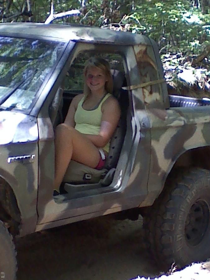

i have developed quite a few ideas after owning 351 rangers chop for the last several years. i have a 7 foot bed i been sitting on just waiting for me to get a better b2 to work with so i can execute the ideas.. mark pushed a concept in construction i will keep, but i want more wheelbase, his closed cab architecture is premium among-st the various methods i have seen over the ..... well since b2's been around:D
i had planned to just run gorilla flares for the EB application but this thing you got going is interesting. its a nice mix that soundly hails rbv....:icon_thumby::icon_thumby: awesome job.
i have some old shots that may demonstrate the cab size differential. of course my daughter hijacked this rig....it was for my wife.
the difference in closed cab size is perfect if your over 6 foot. lots of room for gear and etc.
