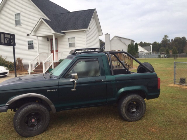

Got the racks and stuff like I want it I think. Roof rack on the roof of the cab, the rack mounted and spare tire back on.

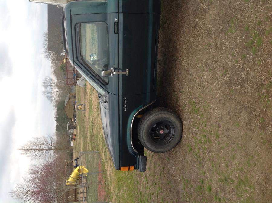

Made a change to the front fenders used a smaller trim to get the shape I wanted. Still have some body work to do to be pretty but it's roughed in

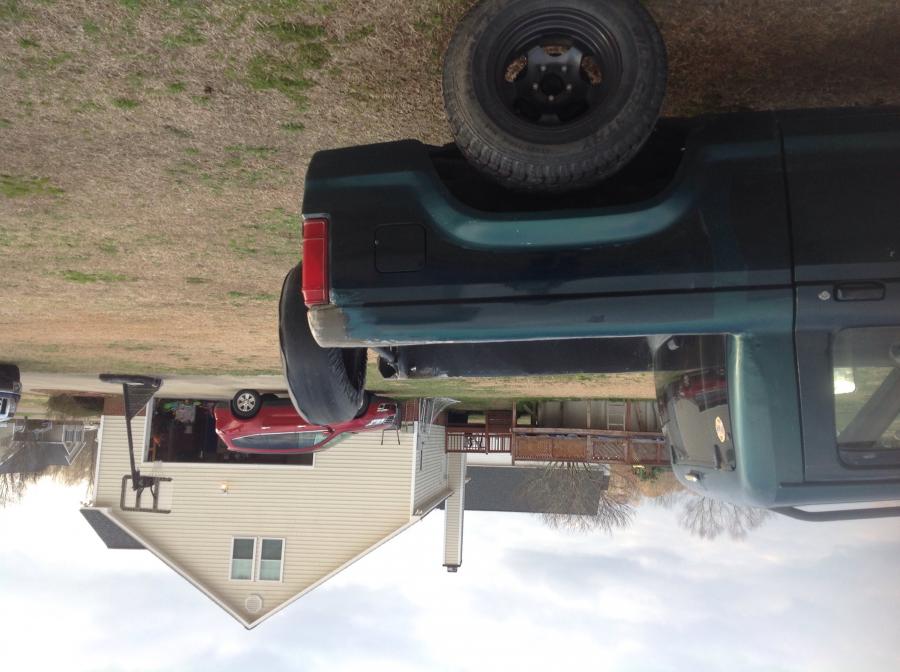

Put bed corners from a ranger to finish off the back. Body filler still damp

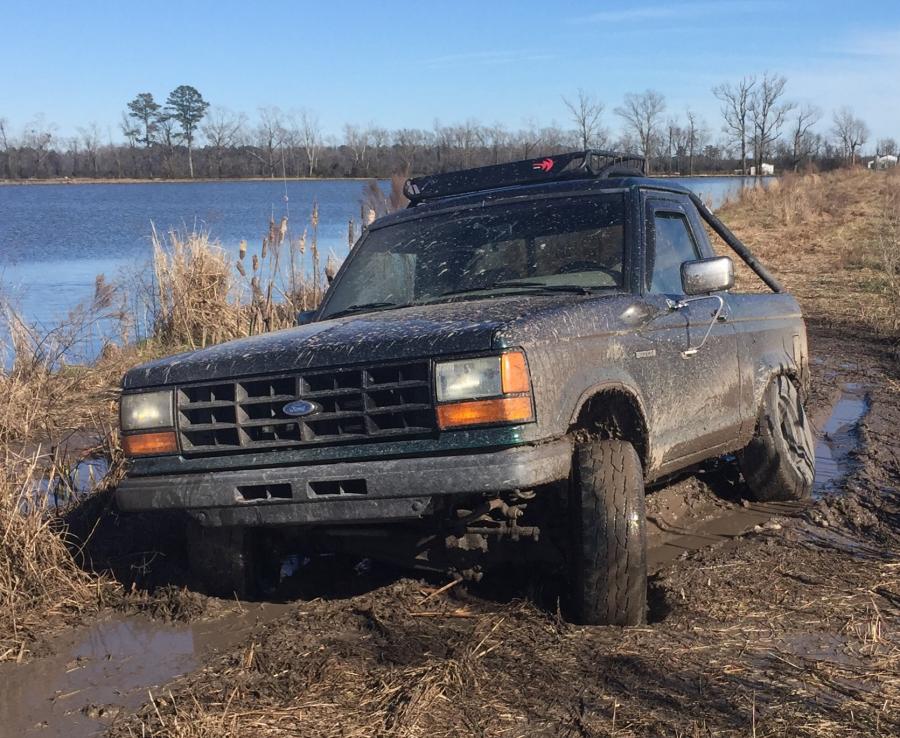

Just to show I havent been completly idle. Little duck hunting misadventure
