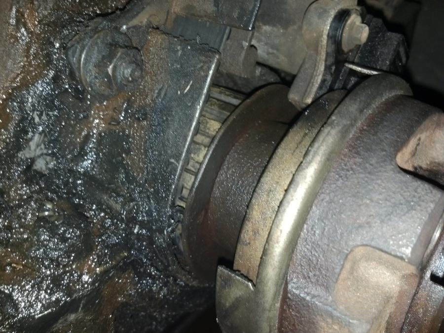

I have the belt. Do I need to take off the harmonic balancer, or will the belt fit behind it and up on through? Also, I don't have a lower timing belt cover and they no longer make them. Where should my marks line up? I know where the camshaft is supposed to line up. The oil pump and the crankshaft not so much. I didn't remove the plugs either, the motor turns with them still in.

The Hanes manual I have shows the line up marks to be on the timing belt cover. It shows the keyway at 12 o'clock. I gues I have to take off the harmonic balancer. It also says I'll need a special tool to install the crank sensor. I don't think I'm going to replace it though. I can't find one at any of the auto part stores.
flange
I guess I will be pulling it

It looks like you have the bottom end of the cover still in place. That's usually only held on by two or three 10mm bolts that usually come out pretty easy...but you may have to crawl under the truck to get at some of them...otherwise, yes, it does look tight. I don't think mine has any more room and I've managed to get the belt in and around the flange.
man I just realized that. I was looking at all the gunk on the front Of the motor and couldn't see the bolts. I removed all the gunk and then decided to come on here to see if you had commented. Lol. you already answered the question I was about to ask. thanks man.
I remove those bolts you were talking about. do I need to remove the two 8 millimeter oil pan bolts that go up through the oil pan into the bracket?

Not sure, try sliding a screw driver behind the plastic guard to see if it pops away from the motor. The oil pan should be separate from the plastic because they come from underneath and usually bolt into the bottom of the block.
I removed mine years ago and it was not connected to the oil pan at all. it just may be glued in there with all the gunk.
There should also be one or two on the other side of the crank...check for those and remove them (above the oil pan only) and it should come off.
