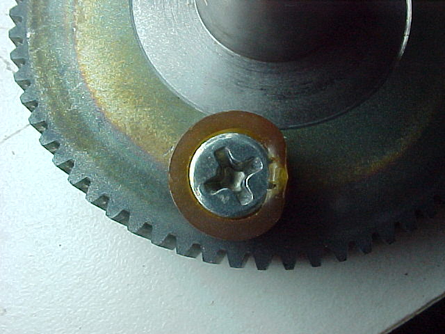

On the motor there is a cover that has wires going into it.
Take it off and remove the gear.
The gear has screw on the back side that is used for a "stop" to keep the motor from turing too far.
The screw has a plastic ring around it that breaks and lets the motor go past the stopping point.
I replaced the plastic with a small piece of vacuum hose and now the 4x4 shifts and works fine.

The back of the large gear has a stud with a plastic bushing (cushion) over it that hits the stop. This bushing is what can cause many of the problems with the shift motor losing its place and getting lost. What happens is, over time, this bushing gets deformed and allows the large gear to rotate just enough past the stop to make the computer lose track of the position. To make things worse, the stop wedge in the gear housing is too short to fully engage the plastic bushing, meaning the stop is only pressing against half (front) of the bushing. Here is a picture of this bushing on the back of the large gear. This shift motor hadn't gotten lost (yet) but the crushing is evident. Sometimes you can just flip the bushing over or rotate it so that a different part is getting crushed. Other times the bushing is hardened and broken into several pieces. This is the piece that I suspect is the main culprit behind many shift motor replacements. I think it is a shame that a piece that costs maybe a quarter can end up costing an unknowing consumer hundreds of dollars.

thanks the article helps a lot havent took it off yet but i do understand how it works better appreciate the help
