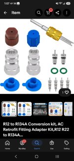

In addition to these, an adapter kit sourced from ebay is used at the fill fittings and comes with new caps. This allows the system to be easily charged with R134a. These kits at time of writing are 11.99 with free shipping. Mine was the same price with brass fittings but did not include the valve wrench.
Conpressors are availavle from various sources refurbed and new. Be aware, the fittings for the plumbing hookups I have been unable to find, so if you're stripping an AC system from a junk yard truck for yours, you will want to take the fittings between the hoses and compressor off for reuse and document which type of compressor it is to get the same one, or bring it for reference as you will want the brackets anyway.
