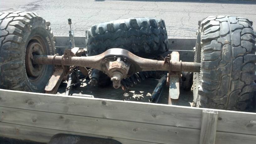

Well i was going to start building but ran into a deal i thought was to good to resist, got some full width f150 axles with 35s for $200 the kid also threw in some vert mounts uploadfromtaptalk1405972916953.jpg

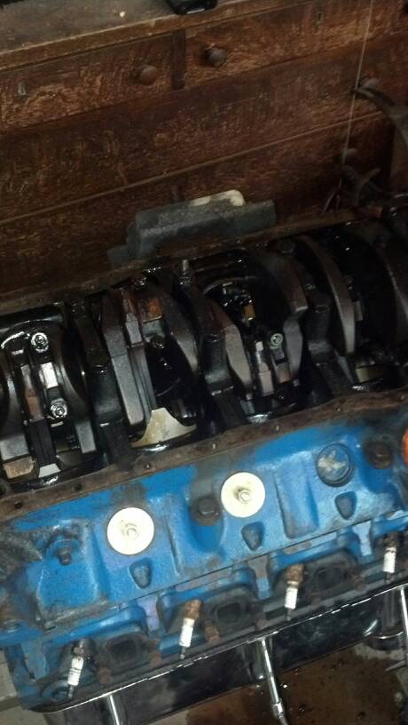

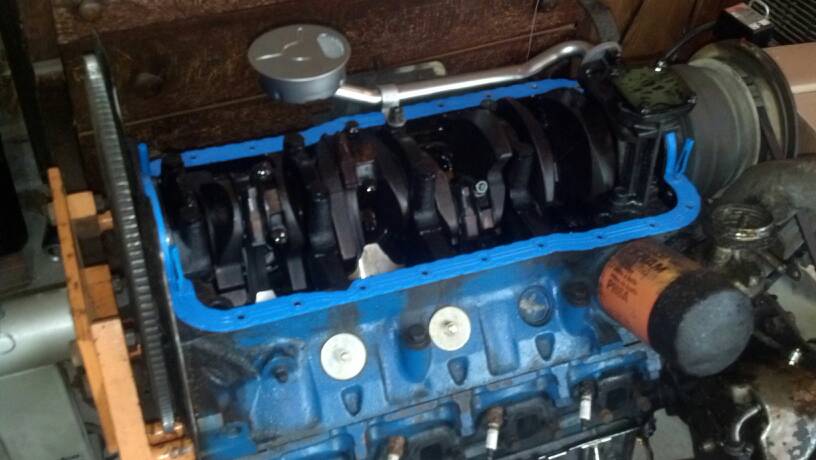

Well did a little more work, i didnt realize i would have to change a main cap bolt for the different oil pickup
Are those temporary freeze plugs in the block?
I was gonna say I'd install some freeze plugs before the block goes in...
