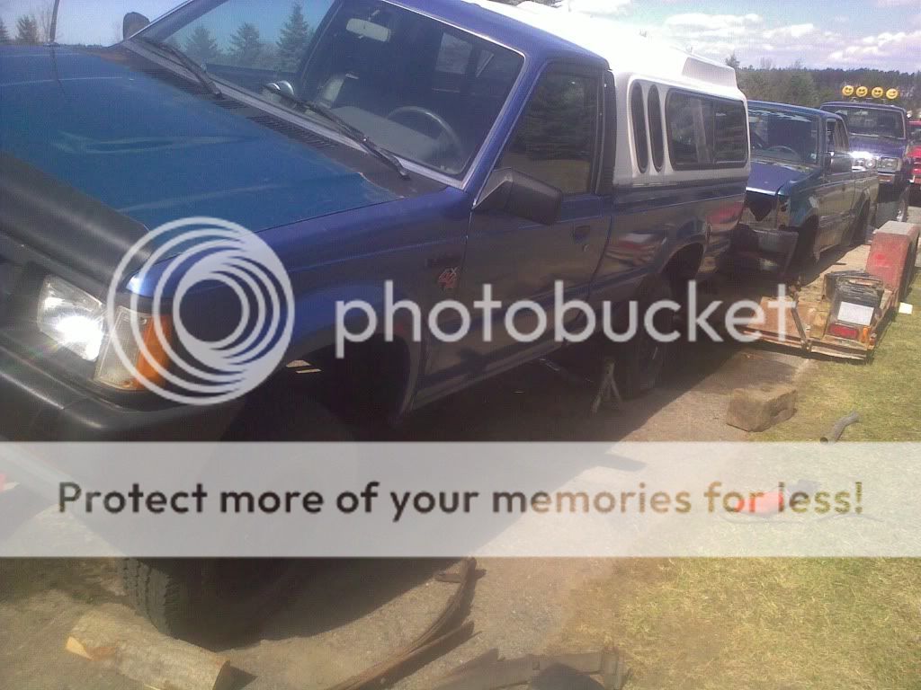

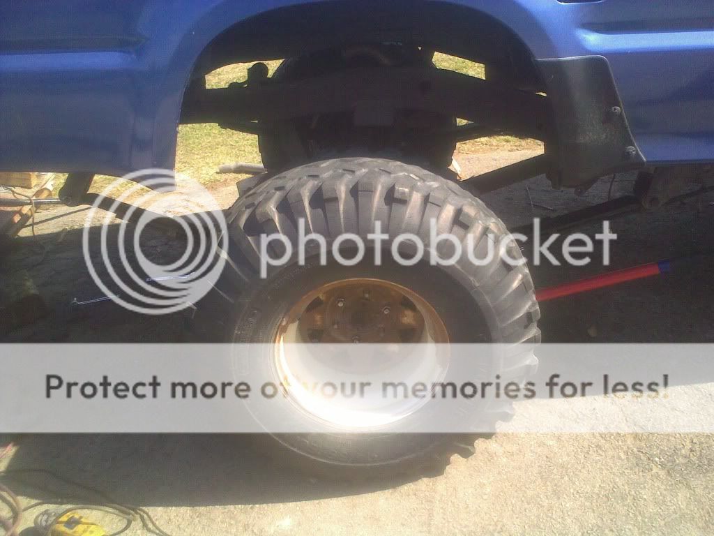

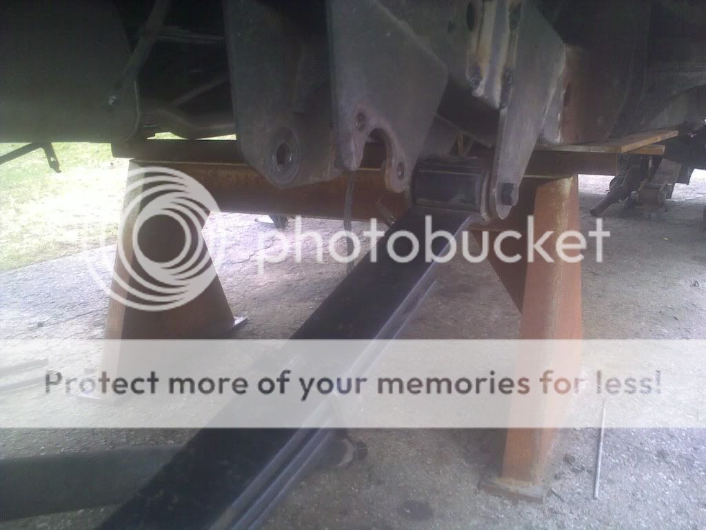

i have had about 12 mazda trucks and i thing it is about time for a sas swap to one my first attempt went ok, i had to extend the frame to hold the stock toyota spring it was about a 12inch lift over stock, but when it came time for the rear the frame was a little too rotted to take the lift and she gave way.
so for the second try i got a new mazda, great frame and i have decide z71 leafs in the rear and 4 link with a panhard bar with coil on the front,

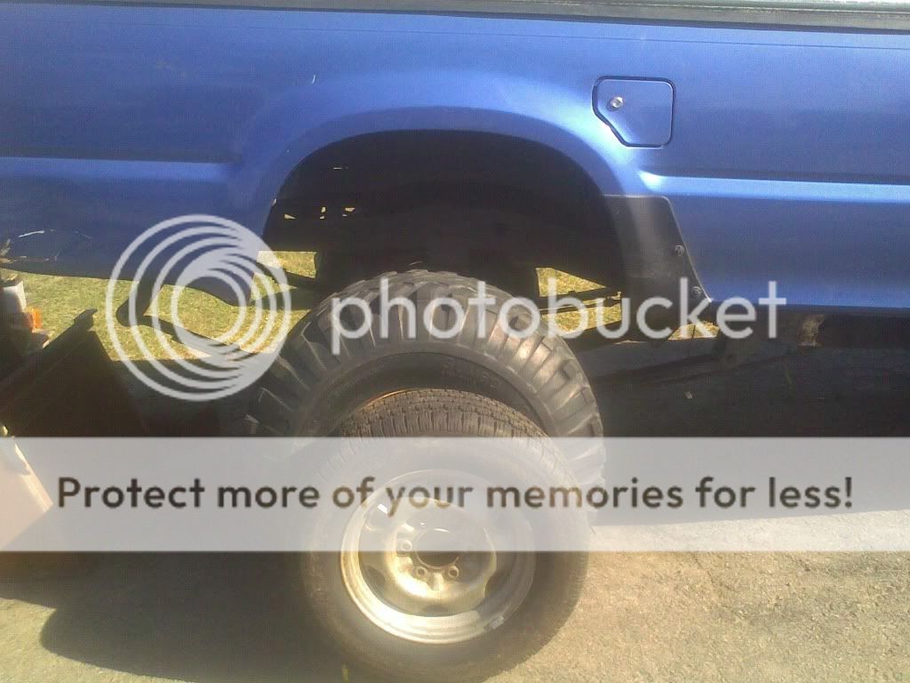

i test fitted the rear leafs today in the rain and have found that i want to get them arched, i work night so i work on the truck like a hour a day right now.
i am using toyota axles for this project and i am happy with them they keep the 6 bolt patten and are the right with for the truck. but the rebuild was pricey.

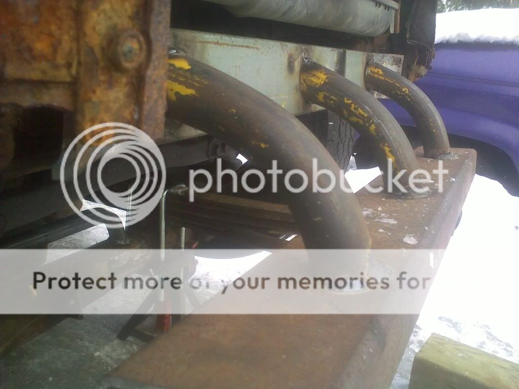

he streched his wheelbase 2" on the front but ya still had to extend it quite a bit. but it was also seperate from his bumper cause he didnt want to have to undo the suspension to take off the front bumper.
plans have all changed now. hes using chevy springs re-arched 7" out back. and ranger 6" coils and a 4 link up front. i doubt were running a block and may have to run the springs under the rear axle to be able to get long enough shackles to actually use the length of the chevy spings

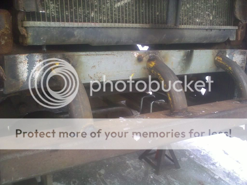

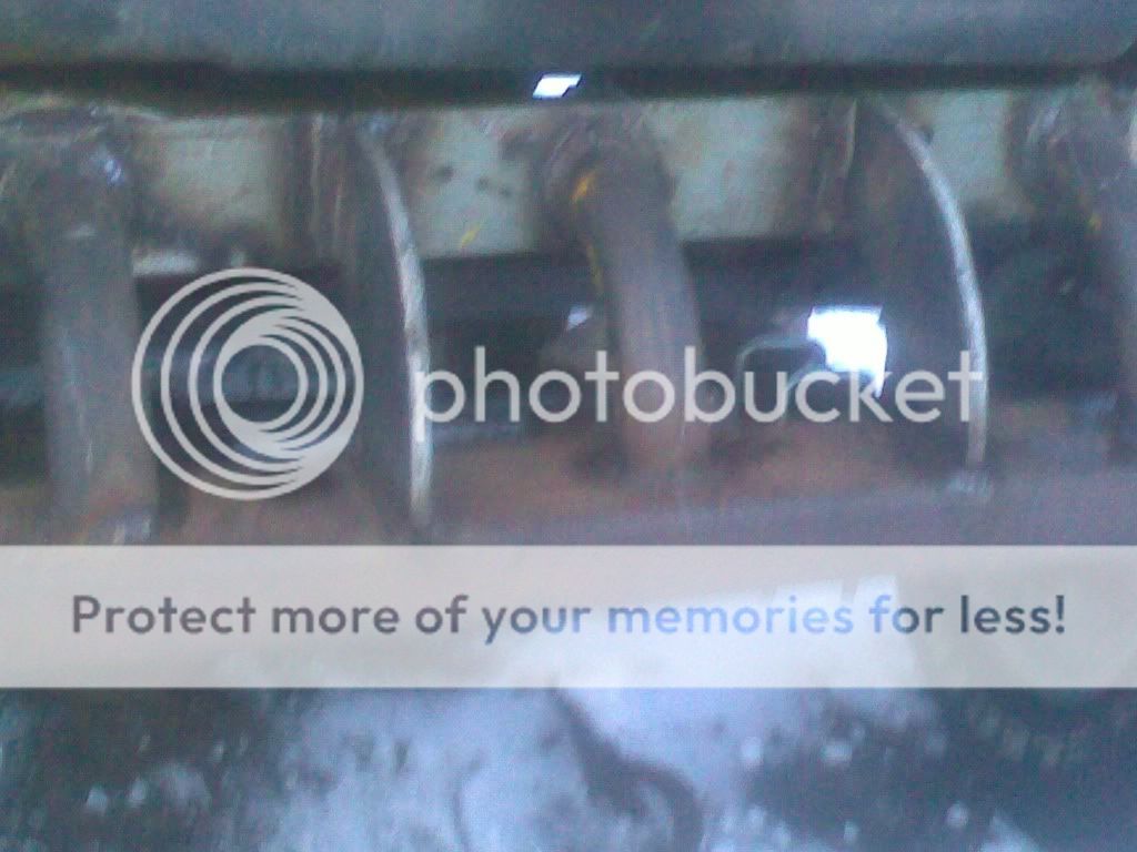

front end
You had to extend the frame for the toy springs?
I have toy springs and my front spring hangers are not even close to the end of the frame, like 3-4" back. that's with stretching the wheelbase 2" forward.
even if you were using toy rear springs, which are like 3" longer, I don't see how you'd need to lengthen the frame
i dont know how to do the quite thing yet
i used the stock toyota front spring out of a 83 toyota sr5 but i add 3 leafs just for height, my plan at the begin was height no flex and in a year or so then flex it up but plans changed! the frame extenders not only extended the frame about 6 inchs it mover the leaf mounts 6 inches down so i got a huge life from it. it is not stick out past my bumper and when the stock bumper when on it looked almost stock, not the lift looked stock but the extension looked stock

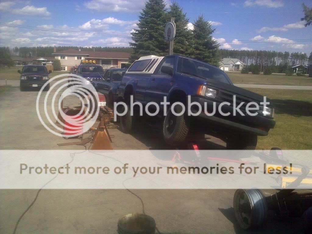

i stopped by while u were at work today and i still think were gonna have to run the spring under the axle. u keep the long shackles so you can actually get the full potential of those leafs and its not retarded high. if we go sping over axle its gonna be taller then the 1st one. and that one fit 40s. all u wanna run was 35s isnt it?

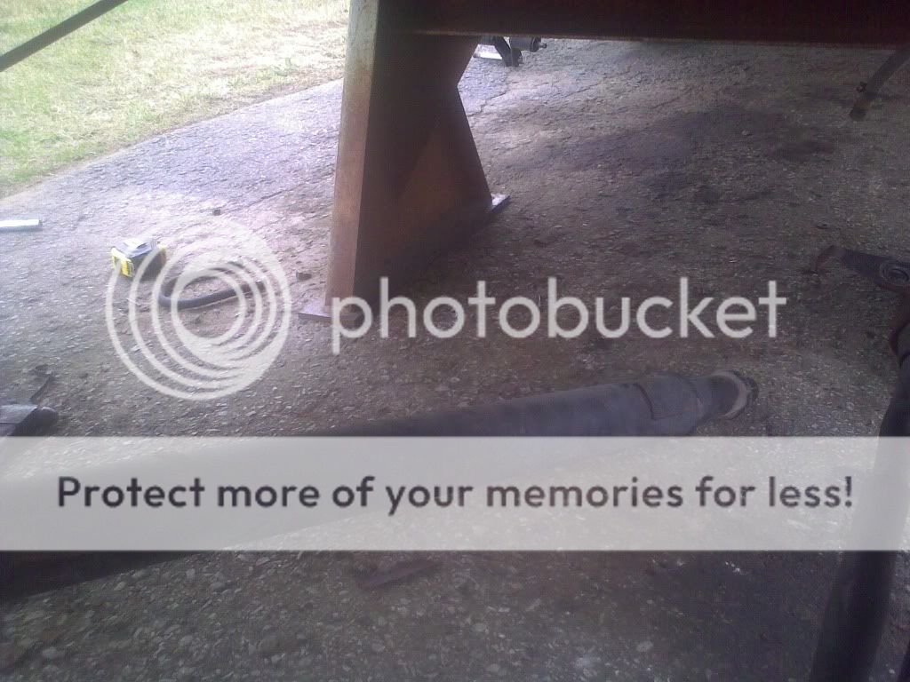

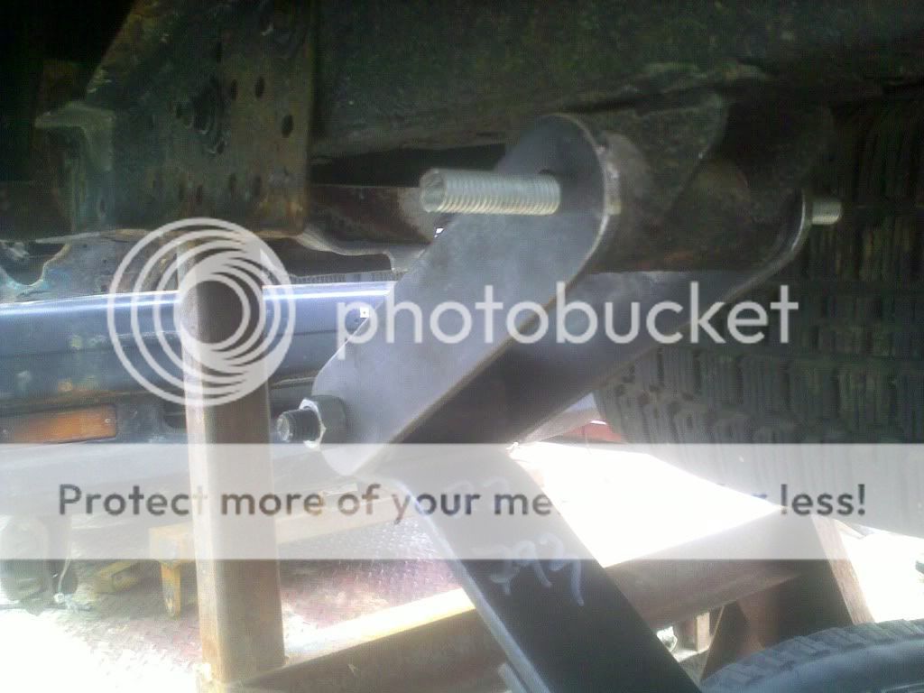

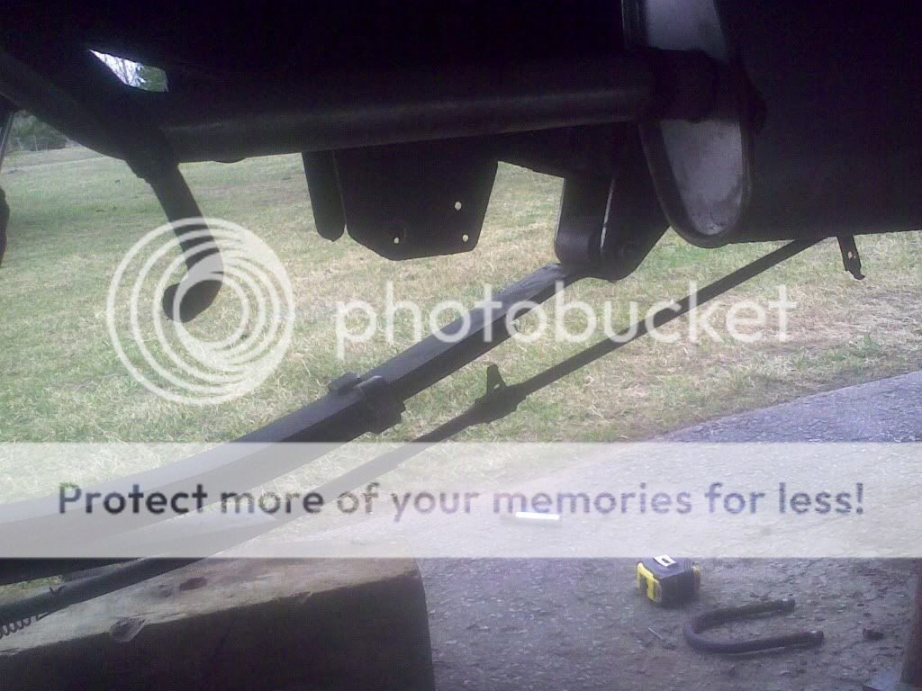

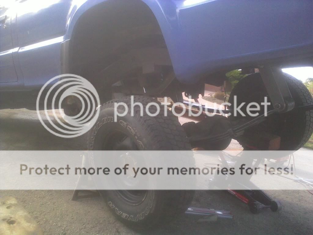

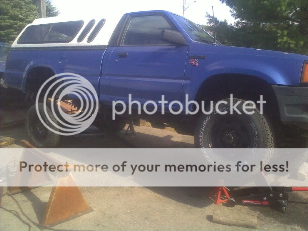

i hung the rear leafs, i had to build new front leaf mounts but i thought i could get away with using the stock rear ones nope. i will have to cut and move the rear leaf mounts to a new location but over all the day went very well
but the drive shaft is too short now so i will have to fix that at a later date

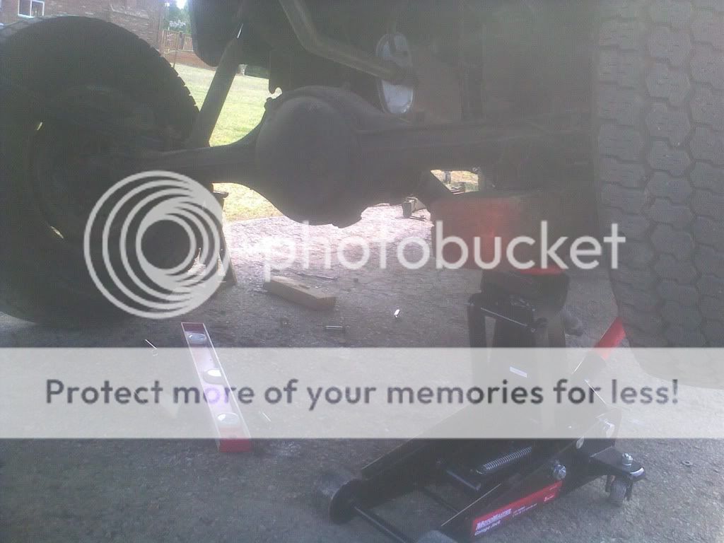

rear end done
the day was spent moving the rear mount around and welding but the most fun was playing with the jack at the end of the day
