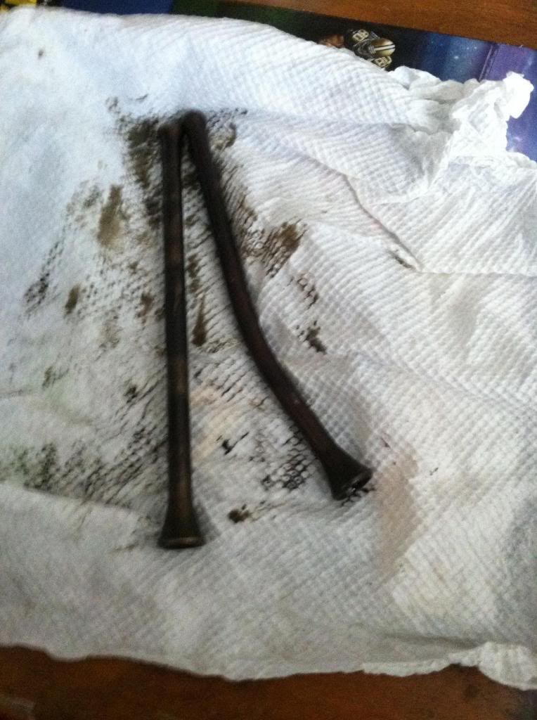

It had been sitting for a few years with a dead fuel pump and a gas tank rotted full of holes, so after getting it running with a new tank and pump it was obviously way down on power. A closer inspection revealed one bent pushrod, and another just floating loose under the valve cover

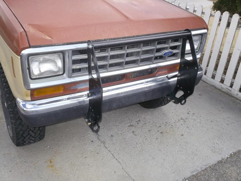

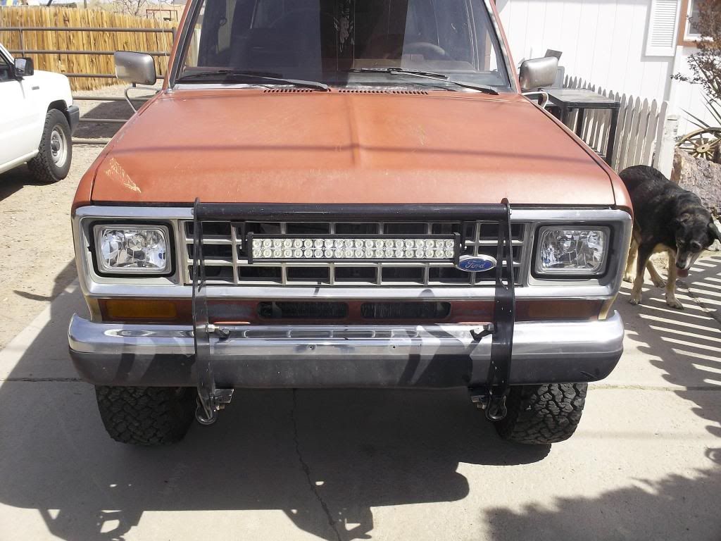

After the driveability issues were worked out, I threw some 1 1/4" blocks in the rear and cut some spacers for the front out of aluminum round stock, with some used longer shocks I had laying around
That gave enough room to clear a new set of 31x10.50 General AT2's
