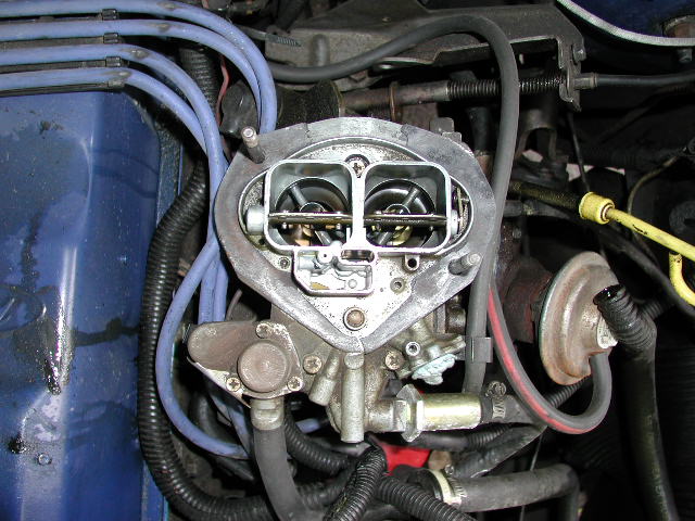

first thing i noticed is when i run the vin, it claims to carry a 2.0l
second thing i noticed is it obviously carries a 2.3 sticker on the valve cover
third thing i noticed was the carburetor. isn't 85+ fuel injected?
fourth thing i noticed was the lack of parts unde the hood. this picture is exactly how i got the truck. big bolt plug..missing air ducts, terrible battery cables..unplugged wires and vaccuume hoses... new plugs wires rotor cap and air filter though!:yahoo:
another pic of chaos
more mahem
document1
document 2
what i've done with the thing. taken out everything that looks "wrong". slowly going to start putting in things that are "right".

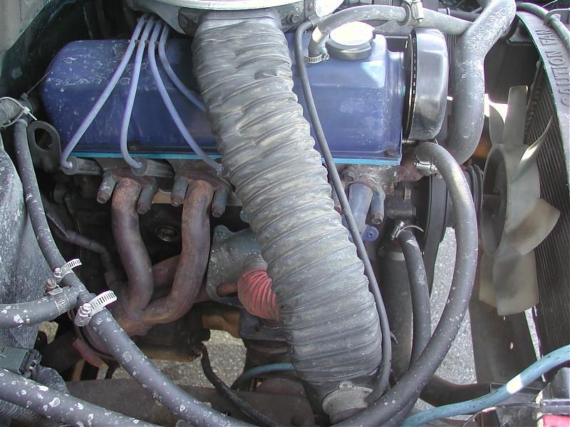

That looks similar to my truck when I first got it (my first 88 Ranger had the 2.0 carb). I also took out all the excess wires, vac hoses, air pump (that you don't seem to have) and swapped in the shorty header, added a motorcraft 5200 carb and intake from a 78 mustang II, and eventually upgraded to a 2.3
I've posted a few pics of my current setup...look under the tiny header pic post for a shot of the passenger side exhaust...and compare it to yours if you want an alternative to the mess...it works out great...
And I also see that the red hose from the water pump on yours goes into the left side of the heater core...I have been looking for a picture of that for a while and this cleared up my question as to the proper way...but if you look at the pic I posted yesterday you can also see a cleaner way to set that up...I removed the hose that runs along the valve cover side and just ran them arching out to the heater core...

i honestly dont know if the heater core is set up with the right hoses. i didn't think it mattered. if you want more pictures of stuff then i can get or already have them. i'll be taking pics as i go with my progress. hopefully it is not raining toight because i have no garage space.:sad:
I copied a junked Mustang setup for my hoses and thought it was right...but one never knows...maybe I will try the library repair resource again because they have just about every diagram for older vehicles...

so i did some more stuff last weekend.
i dont know what any of this stuff is though... :icon_confused:

does anyone have a simple wireing diagram for this specific engine? vaccum hose diagram?

Yes, there should be an air pump in the last pic...
The first pic is your test plug for the emission system IIRC...
The second pic is a vac connector, but it seems to be missing quite a few connectors...mine didn't have one of those, but it was so incomplete when I got it that trying to figure out what went where was a exercise in futility...there has been some mismatch between your engine and your emission system...the only good news is that it is older than 20 years so it would be exempt from most emission testing standards...you just gotta get it to run clean and not too rich to pass.
Third pic is more emission stuff that connects to some of those open pipes you have in the background...or connects to other connectors...
Fourth pic is easy...somewhat...it is your purge canister that runs from somewhere on the carb back to the gas tank...that one you may need even for a cleaner setup...
Essentially, you have about the same mess that I started with four or five years ago...if you want to figure it out you may be able to find the original schematic under the hood of an 87 or 88 with the 2.0...but, to be honest, I even went to a Ford dealership and had them print out diagrams for various parts and connections and still couldn't get it back to original...
So I scrapped the whole shebang and put on the carb and intake I mentioned above...I had the air pump installed for the first emission test and it almost passed...just a tad high on the hydrocarbons...meaning that it was running a bit rich and I probably should have changed the cat to clean it up...but I got the conditional pass and was more than happy with that...
There are other carb/intake options that you may want to consider...such as a Holley 350 carb sitting on a 86 Fuel Injected intake with an appropriate adapter...or something like my 5200 motorcraft carb on an effy intake from the 87 Mustang II...these require only two or three vacuum lines and maybe a few connectors for automatic choke (I went to a manual choke just to eliminate that beast)...
Personally, I wouldn't hesitate to highly recommend dumping the whole whack and cleaning it right up...but if you do decide to try to figure it all out...I will personally sign the documentation to have you awarded something similar to a Purple Heart for being wounded in action...or whatever they give it for...because it was more confusing to me than trying to figure out what women really want...

This is what I ended up with after I removed much of the old emission crap, stock exhaust, and stock carb/intake...you can still see some of the vac lines that I later removed, but it is much cleaner in the engine bay and the engine runs great...
Oh, and I swapped out the 2.0 litre valve cover and put on the 2.3 valve cover with the oil filler cap at the front of the engine instead of at the back...
