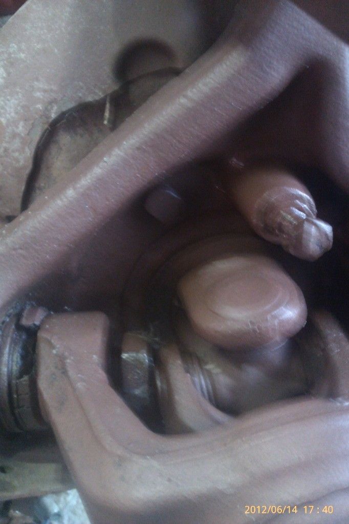

im tearing the axle apart to get to the u joints ad im stuck. i got he hubs,rotors, nuts, and bearings out but whatever holds the axle in the knuckle is being stubborn.
i tried prying, pb blaster, heat, a puller but the puller couldnt grab anything so any help would be apreciated!
86 gen 1 sas build
nothing holding it from the back side....
86 gen 1 sas build
top view. i know it comes off because the dust shield is in there.
86 gen 1 sas build
I used a flat chisel and a 3lb sledge to pull mine for the first time. Just work your way around it swapping sides. Like when you tighten lug nuts
thanks rowdy! i wasnt 100% sure how to do it so i figured id ask before i messed it up. i got it. had to use 3 chisels and a BFH but its off.

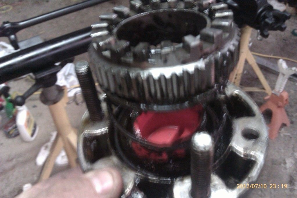

i just got back from colorado and i had a couple of boxes waiting for me. i got out into the garage today and started putting all the new parts into my axle. i just about got everything done and then the factory locking hub broke in my hand. at least it was before i was out on a trail. now i have to order some warn hubs. this axle is eating a crapload of money. its slowly getting there.
pics tonight.
this is the broken piece of the hub. shitty cell pics but o well!

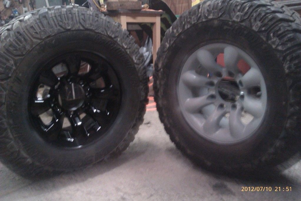

had to do something while waiting on parts so i busted out the spray paint again.....
this is what i sarted with...
