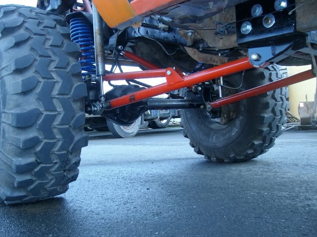

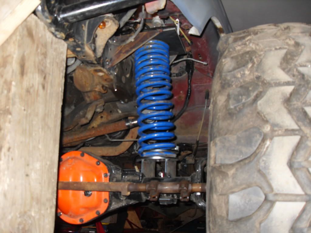

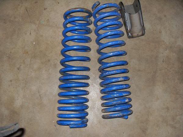

im really happy with my coils up front, they are eb coils, 5.5 over and are progressive rate , i bought mine for $50 off of craigslist... and then did a simple 3 link setup but wasnt super budget friendly, used ballistic joints and DOM...
86 gen 1 sas build
heres how i did my top part, not good pics and truck dirty in one but hope youll it helps..

bu ive also gone other routes such as this which cost me only 25 bucks in parts, used some old jeep springs and just fabed everything.
