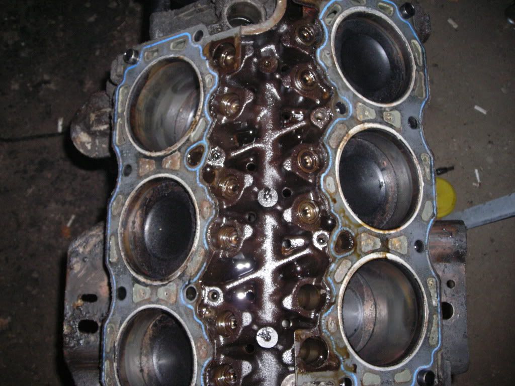

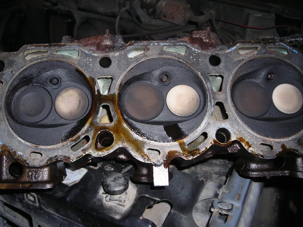

That 2.9 looks great inside!

Heads are off!
not to shabby!
Not to shabby!
Going slowly but going!

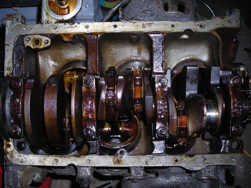

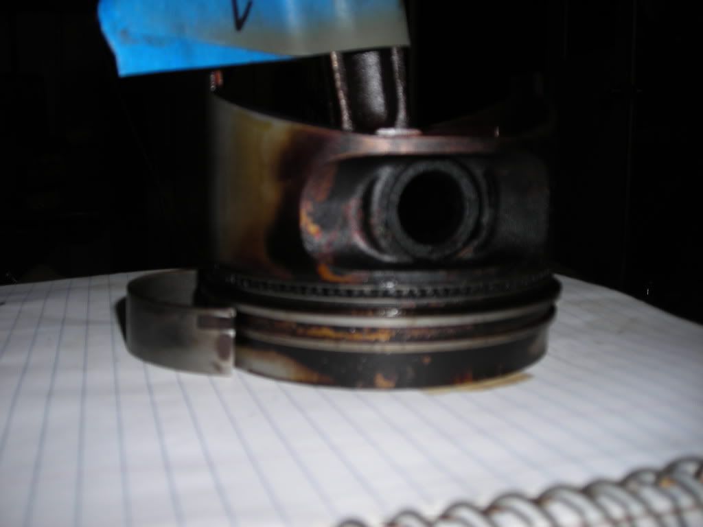

everything is looking awesome! bearings and races look new. piston #1 looks great.... a little dirty but a good polish and its good to go. i'll jott down some measurements and its time to head to the auto parts store for new parts!:icon_thumby: here's a couple of pics.
looks good. i've seen better, but i've seen LOTS worse.
This is the first time its been cracked open since it was built in 86. its got 213,000 miles on it. id say AWESOME!
well in that case..... WOW! lol...
ford builds some good motors; the owners just have to care for them properly!
