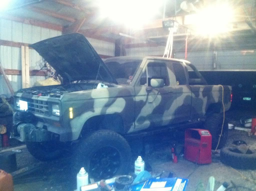

Got out n got a few things done.
Rear shocks are on, bed is kinda on.... I didn't have help so I wrestled the bed on and tried the body lift blocks and could only get 2 of 6. Rear lights are in and working. It looks like a truck again!!!!
A couple of random pics for a taste.
