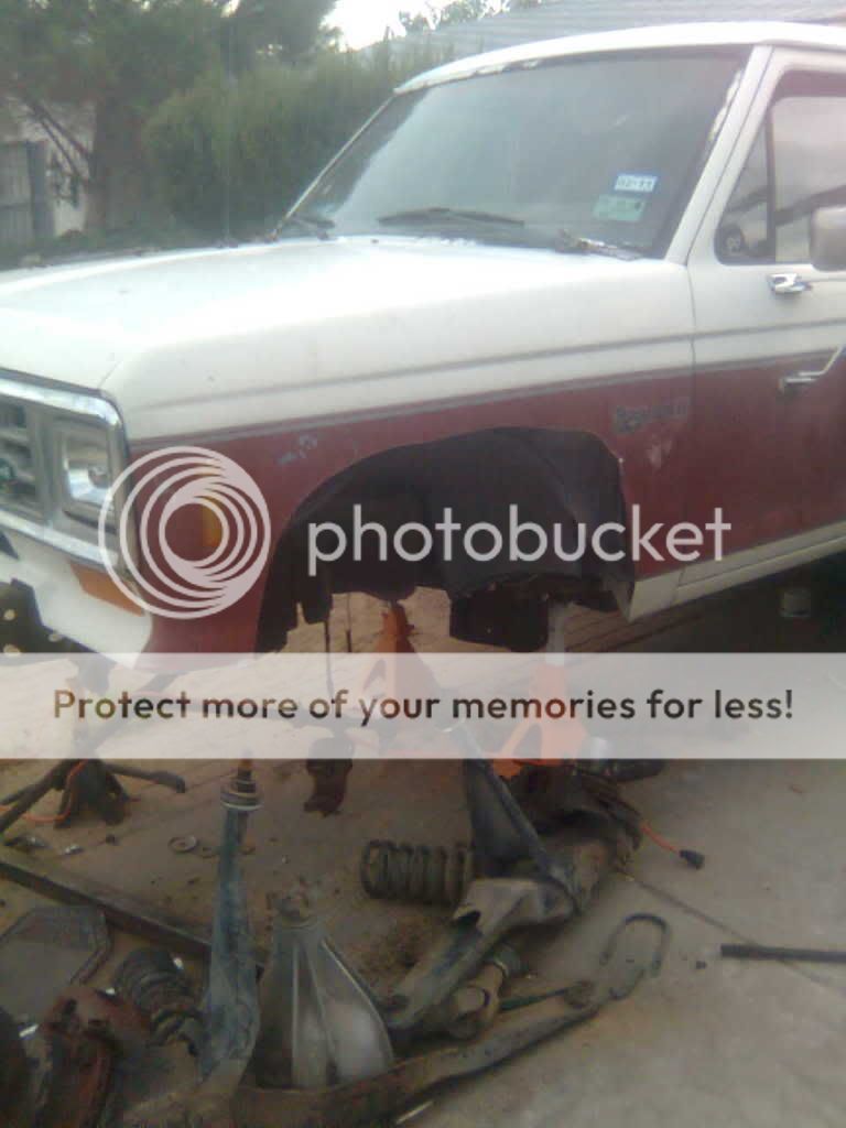

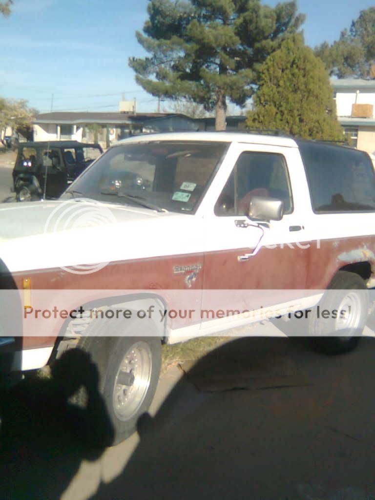

Around a year ago i started a build with a 86 bronco II that i got for 250 dollars. It wasn't running and was told that it because it needed a engine rebuild. My friends and I got on it and figured out it was clogged injectors and lose ground, started it and ran pretty good. I decided that i didnt want another stock truck so i put it under the knife, 4in lift d35, 8.8 with the posi clutch mod,new front bumper and rear,trim fenders, dana 35 warn hubs for jeep,steel braided lines,ruff stuff diff cover and 37 goodyear mtr's with mickey thompson fake beadlock wheels. I finished most of it last night, to get driving again just need to shorten the drive shafts and do the break job and aligment we will see how she runs. After she is running my bud is going to rebuild the engine and put a new clutch. Hopefully next semester i have enough to put 5.13 gears and front locker.
stock
under the knife

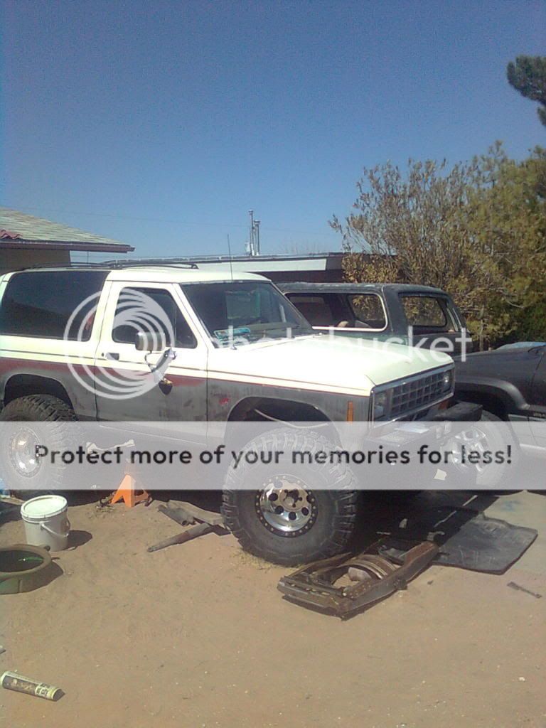

As it sits right now

that looks sick. do i see a 78/79 bronco in the background?
nice b2. i got a soft spot for b2's for some kinda reason...lol
i'd love to pick one up and build it for strictly trail use and then have my 88 for a dd/ww
Siiiick! Good thing you're not afraid to cut sheetmetal! :headbang:
Ya that is a 78 bronco i got on a killer dear , traded it for a xbox360 :headbang: that is my harder project specially on a student budget. LOL aint afraid of cutting sheet metal i figure its probably gonna get bent or trashed on the trail either ways so ... what the hell.
lol yeah i payed 300 for my 79 bronco i didnt think that was too bad but i would of rather traded an xbox like you did though
