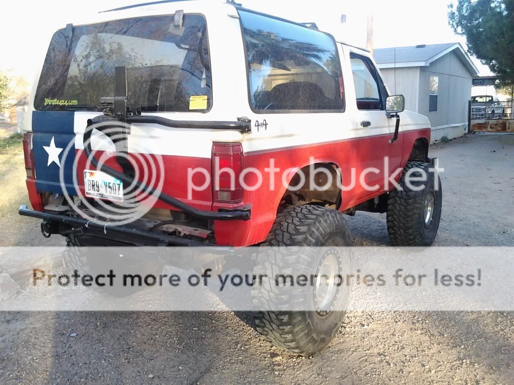

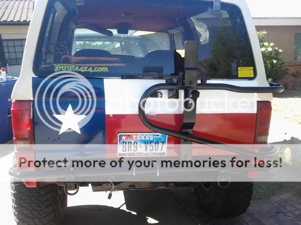

do you have any better pictures of the rear bumper? it looks simple yet effective. what did you use for material?

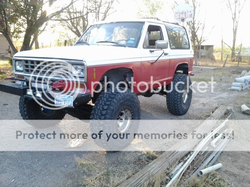

youd be alot better off with a regular drop bracket for the pasenger beam instead of the drop plate. will flex better and wont have to worry about putting a hole in the diff.

The material was some 1 and 1/4 schedule 40 pipe. I used the stock bumper brackets just notched them. With the notches i took out i used them as gussets to brace it a little more. The D shackles are from harbor freight. Used some 7014 rod to burn them in on the stock brackets.
I was thinking of getting the super lift or skyjacker lift brackets but since i have a welder , i figured that i could mod them to clear the diff and save some money in order to order the viair air compressor system i want to mount on it.

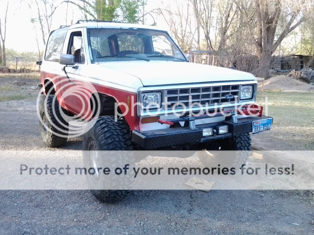

Put some paint on the truck let me know what ya think

- got all the material to do the roof rack and rock sliders and do an addition for a spare tire carrier and get rid of the stock one since it cant handle 37s

- also bought a tailgate i am going to be cutting the hatch toward the middle and do a half hatch tailgate combo so i have the good of both sides

I will take some pics of it on Friday, I will be building the rock sliders first , will be starting on them on Friday, hopefully finish them asap. :icon_welder:

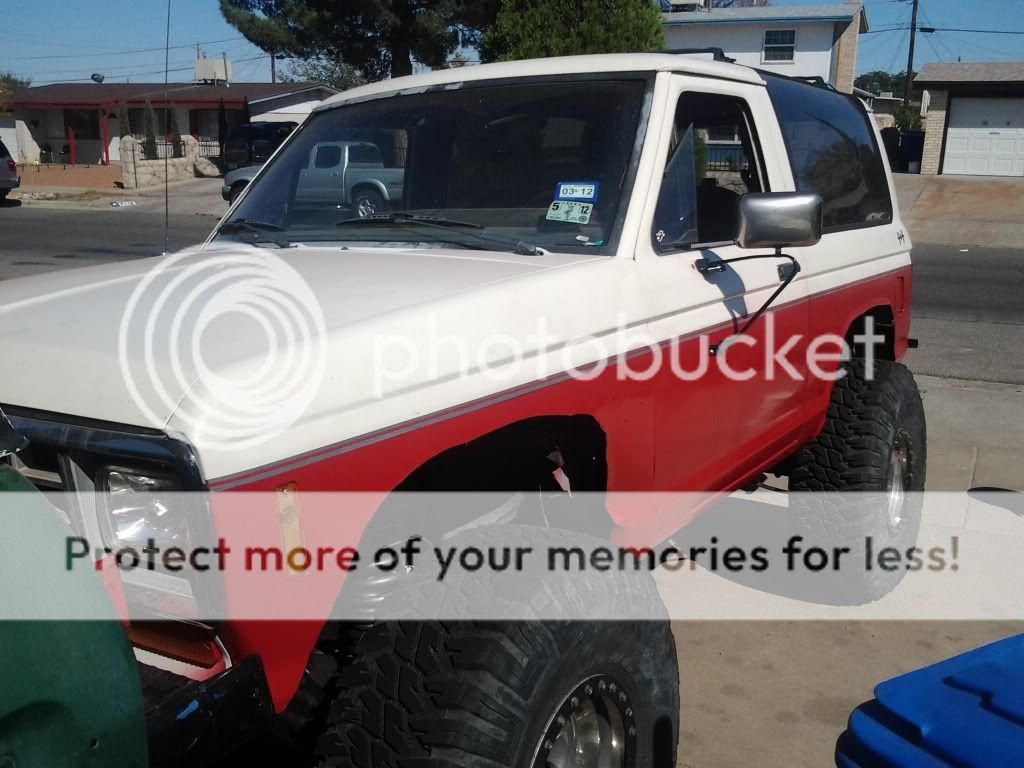

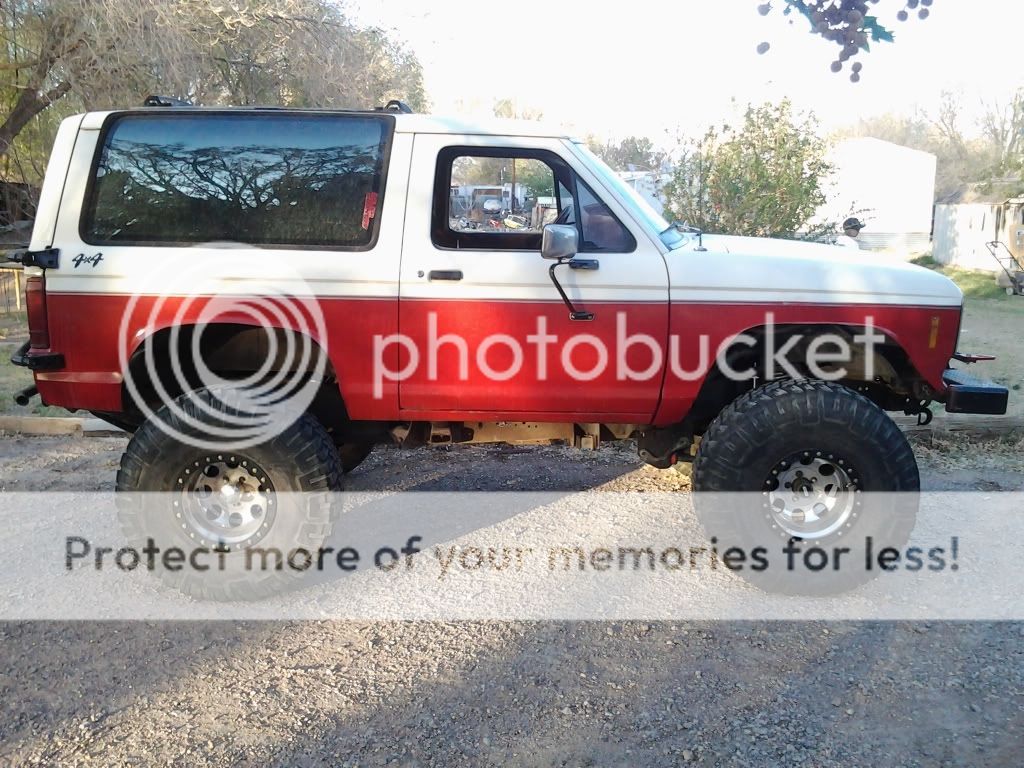

here is some pics with the body lift on, look it for a long drive today to make sure the new electric fan worked good and yup kept it very cool.

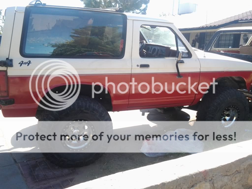

what did you do for fender wells in the rear after cutting so much off the rear fenders?
welded in a strip of metal and outlined it with expandable foam to it could be more water tight. :icon_thumby:
