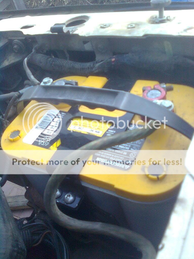

here is my optima battery mount from ruff stuff

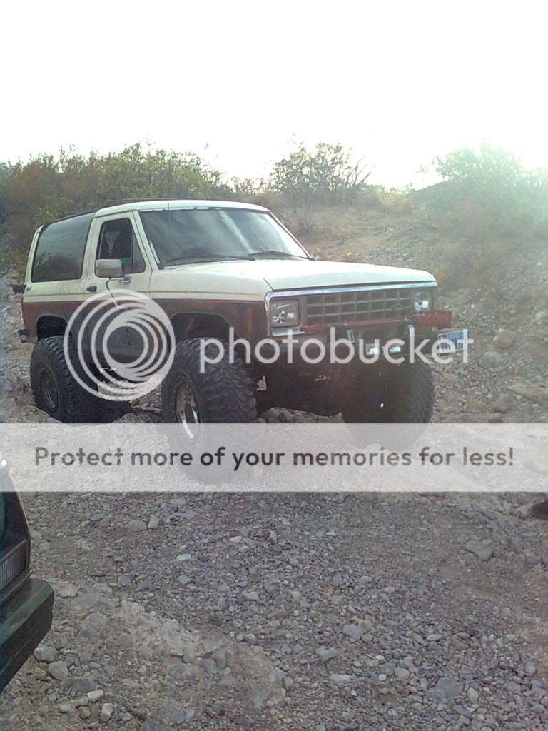

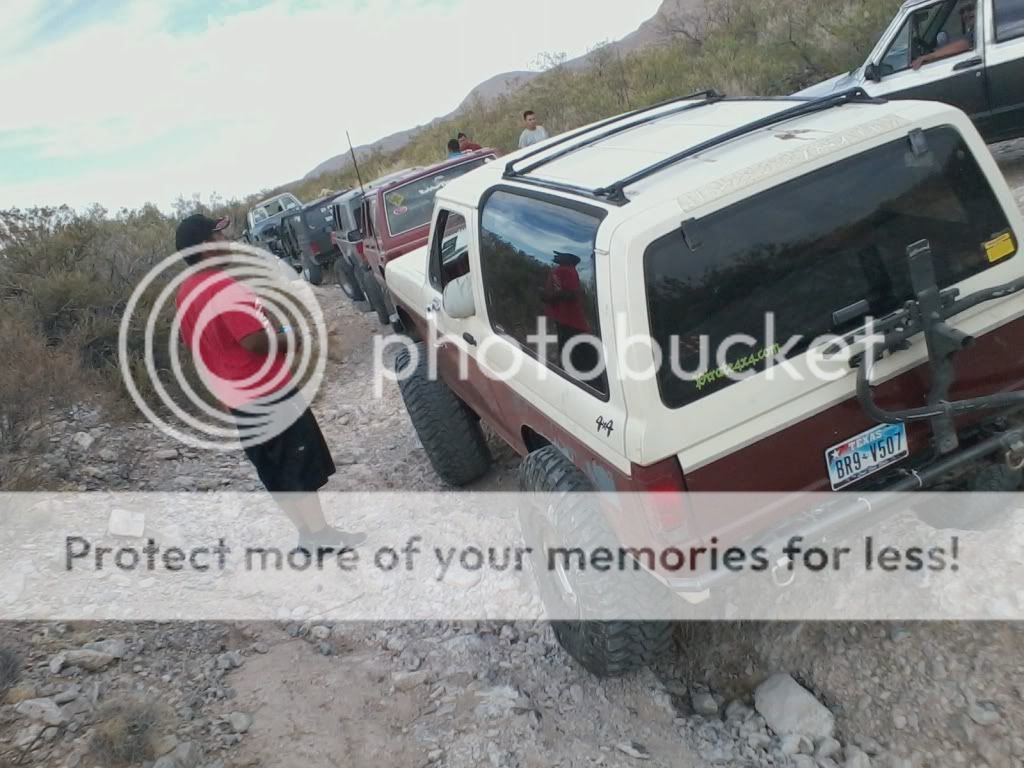

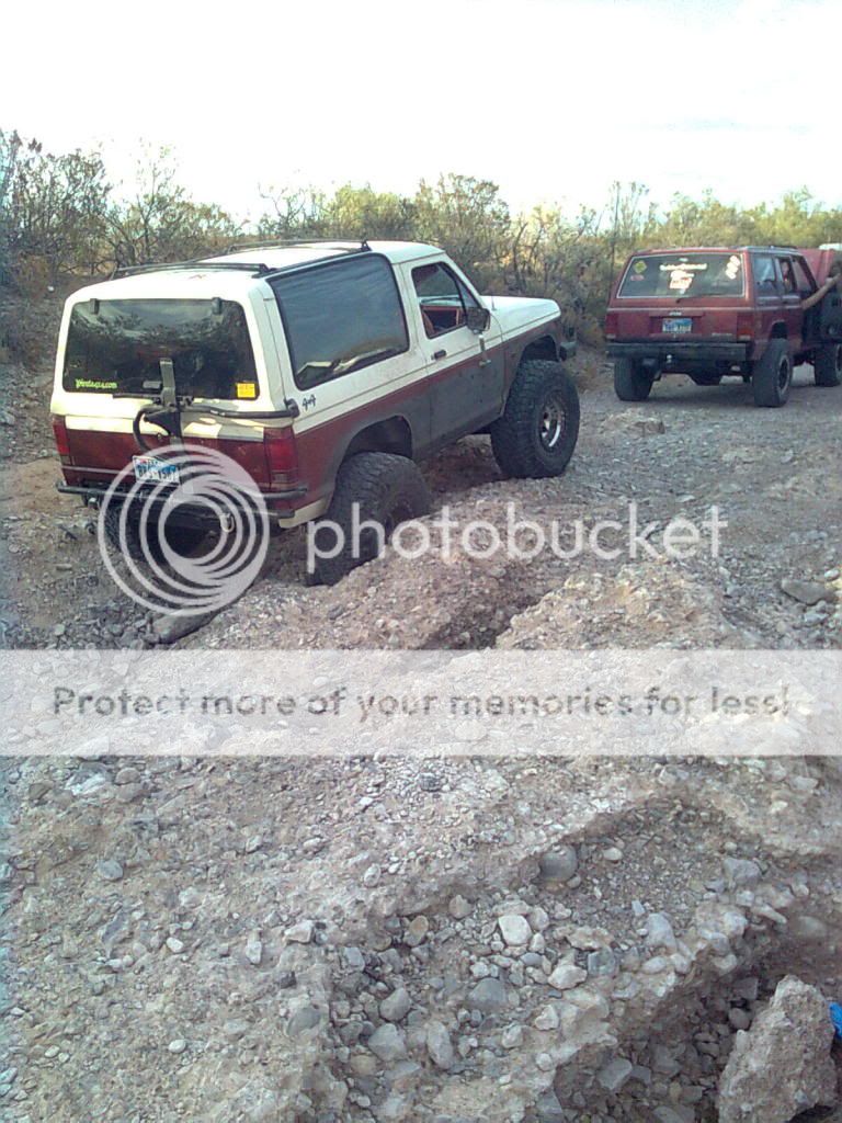

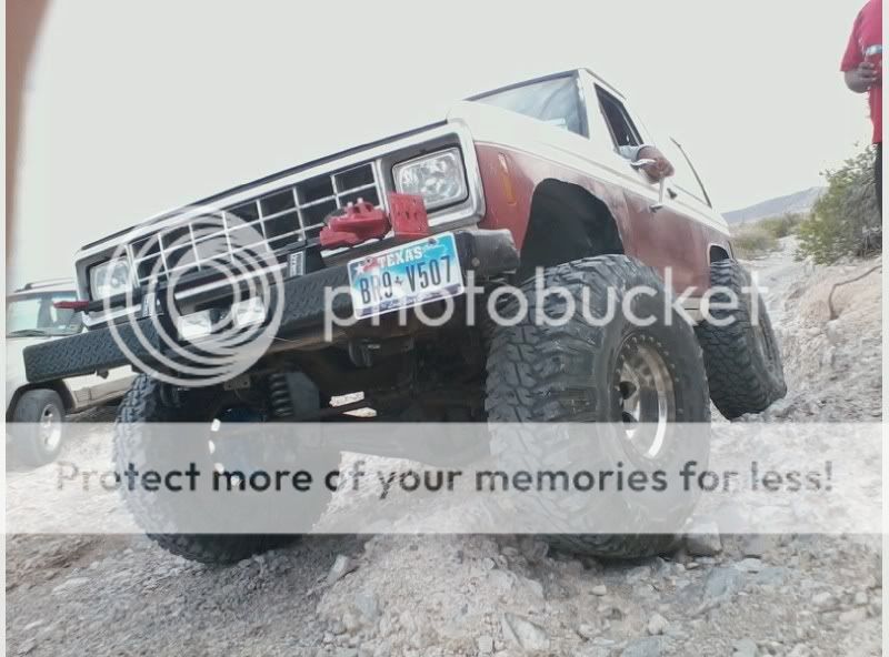

Well I took it wheeling today and wow me and my girl were impressed. 4high it wasnt good but 4 low was awesome. We did a 3 hour trail and i took the hardest obstacles on all of them and made it out great. i did have to push the truck a little hard due to lack of gears but still did awesome. I did encounter one problem which was it is overheating. We rode for like 1 hour and when i turned it off figured out that my radiator hose had been cut due to the rotation assemble so we had to do a quick trail repair but from their on every time i turned the truck off it would spill the water over but while driving it would stay a little above half. It seemed like the moment i turned it off it would start to boil over. I didnt get to take many pictures but one of the guys got me lifting one of my tires and he is going to be sending it to me after he uploaded it. I only took 2 pics but here they are.
well just got a chance to look at the truck and i chunked the tires pretty good, they hit up against the passage side floor mounts and took some chunks off, also going to have to trim the rear fenders more because they rubbed a tad but over all very little body damage, bent up both fenders but it was a blast doing so.:icon_bounceblue:

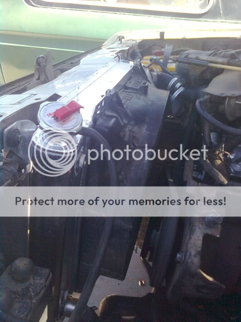

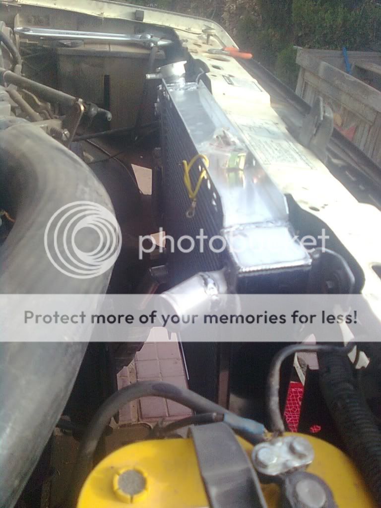

just finished changing out the water pump with a new one, new hoses and the main finally the 3 row aluminum radiator that i got off of ebay.
So thanks to the radiator the truck doesnt even think of over heating :D I have been wheeling it for the past month with no problems, drive it all around town.
