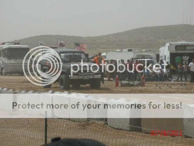

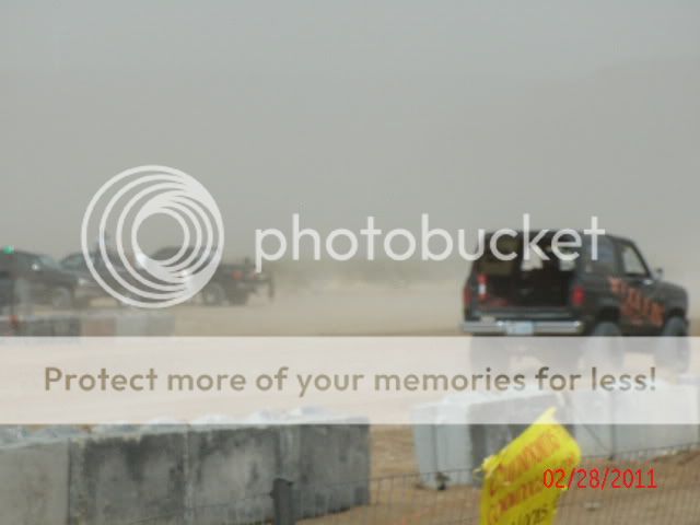

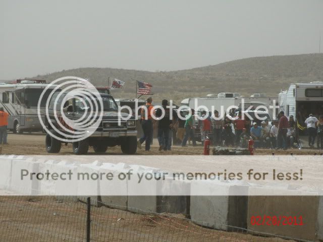

Took a few pictures of a Bronco II racing at the sand drags

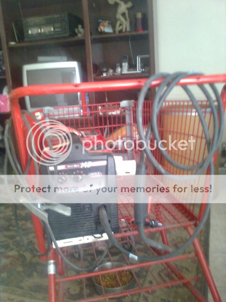

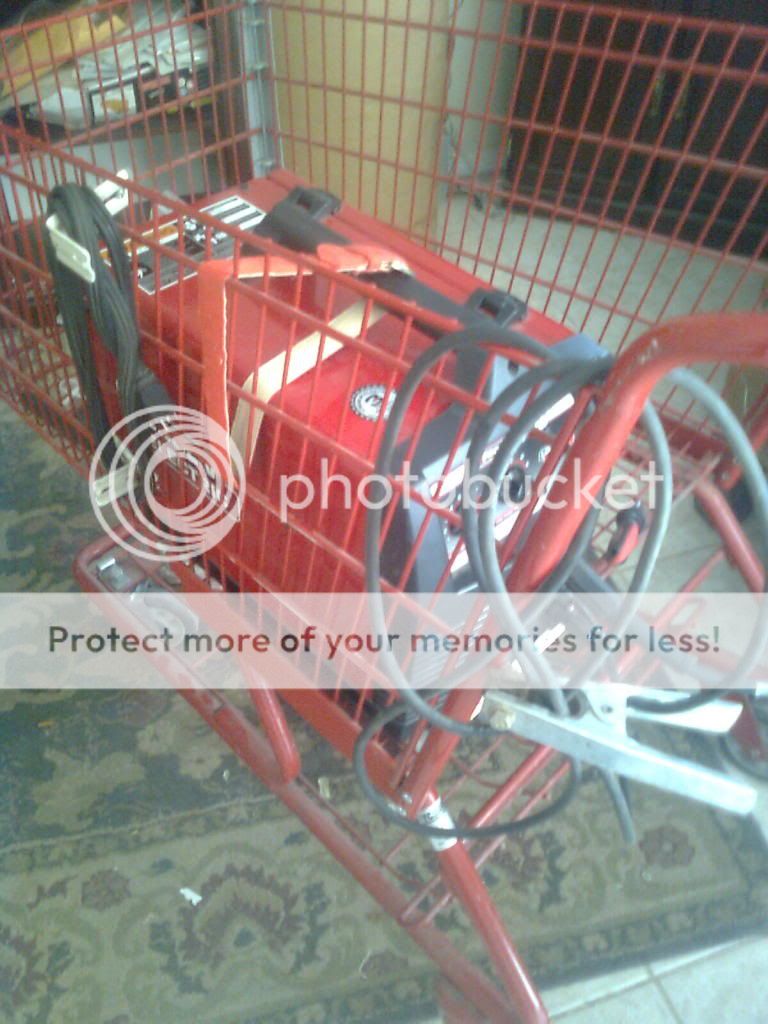

thanks to eddie_88 i have no more pains carring my welder in and out of the house :D

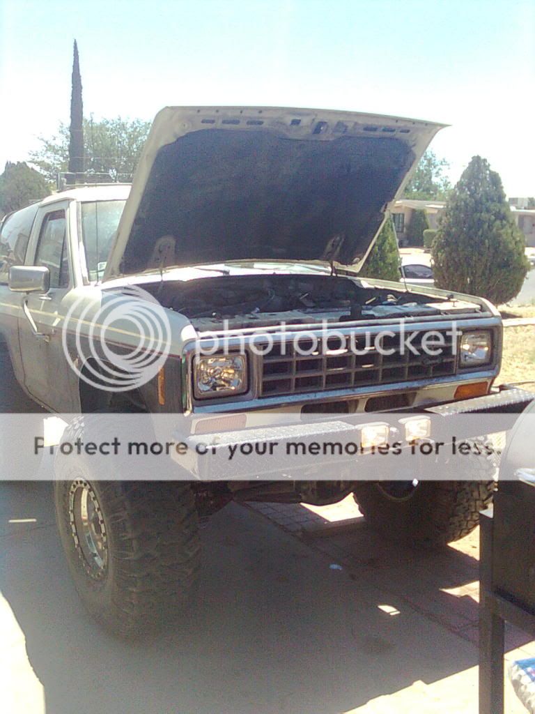

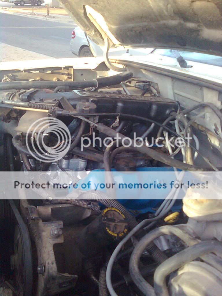

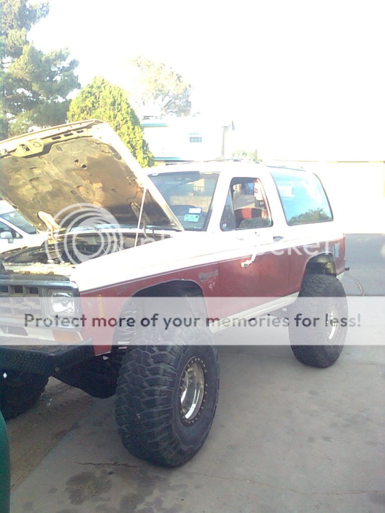

Alright so here is an update that i have been waiting for........................................................................................................................................................................................................................................................................................................................................................................................its Running ! I have no exhaust on it right now so its loud as hell, it needs alignment and need to set the timing :) Over all took it for a spin around the block and it was sweet :) cant wait till i get the 5.13 its a dog right now, hopefully i can get everything working good this weekend and maybe hit a trail :) here is some pics
i only took two pics since i had just got out of school, lets see ... tomorrow , weld up the exhaust, the d shackle , put in the stereo , get aligned and put some premium gas to level out the old gas
welded up the exhaust today , i like how the flowmaster makes it sound :) also left it dumped , tied up a few lose things here and their and it seems that everything is coming out nice, but slow since the wind kicked up and sand and welding dont get along i wasnt able to weld the shock tabs for the rear, tomorrow we will see what gets done here is some more pics
