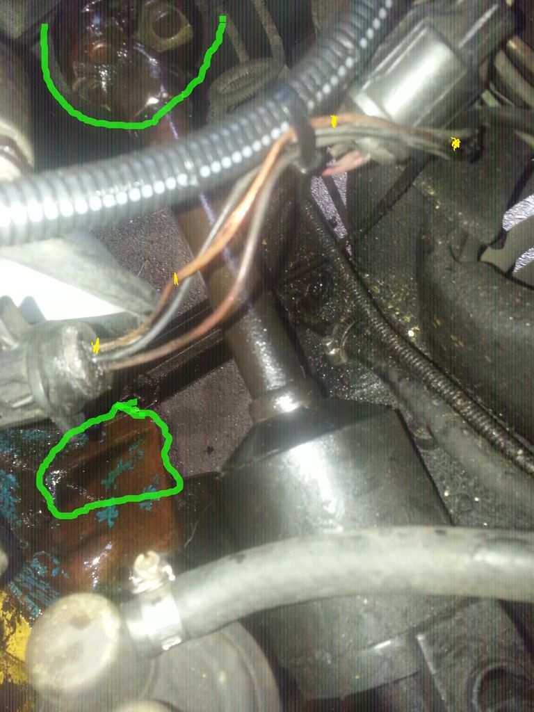

At first glance everything seemed ok but after driving to work a few times (roughly 20 miles each way) I realized Its leaking quite a bit of oil on the driver side. It seems to only be leaking when I'm driving. When the truck is just sitting or even when I run it in neutral it doesn't seem to leak. It appears to me to be coming from the oil dipstick tube, where it goes into the block. I pulled it out and tried a dab of RTV but it's still leaking. I may reapply a more generous coat this weekend when it has time to fully cure.
I also got a chance to inspect the ignition system and wiring more closely in an attempt to clean everything up. I found most of the connectors have corroded and bare wire and some are missing the insulation completely :icon_surprised: After this discovery I decided to hold off on wrapping up the harness until I address the issue. My solution is an MSD 6A ignition box and blaster coil (arriving tomorrow) with all new wiring.
So here is a picture of the header after about 100 miles. Its been smoking like crazy burning off the shipping paint. Also I deleted the factory heater pipes and mess of hoses and opted for two directs hoses. you can also see a couple bare wires I wrapped in electrical tape for now.
In this pic you can see the wire traced out in yellow is completely bare. It runs from the distributor to the ignition box. Also, in green you can see where some oil built up on the driver side mount and also it's spraying onto the steering shaft.
You can also see where oil is pooling up below the dipstick.
Other than the oil leak and crappy wiring all else seems ok. If anyone has advise on either of these issues I'm open ears.

Two things...the oil leak could be dipstick or oil canister (just ahead of the dipstick that should feed into the base of the carb) and pcv vent hose...or it could be a leak from the valve cover as they are notorious for leaks if you don't get the gasket just right.
Run a clean rag or paper towel around the base of the VC and see if it is picking up any oil...if it is...could be VC gasket.
The oil loss while driving is normal when first starting them up if you haven't tightened things down...or it may be blow-by.

I have a hose running from that crankcase breather canister up into the base of the air cleaner. No PCV hooked up. I'll double check the canister and valve cover, thanks for the tip. Do they tend to leak if there over tightened? Also funny you mention the header because it does rattle against the frame rail during warm ups with no choke. I figure ill let it be until I have to replace it with a better fitting header
Over tightening the VC can be just as bad as leaving it too loose. Depends on the gasket though. I think the bolts only thread so far into the head before bottoming out but I can't remember...leaves enough for gasket and a bit.
These bolts go by In/pounds torque as opposed to Foot/pounds so it can be over torqued.
The header might be OK after it knocks itself in...as opposed to out...:)
I remember mine was pretty close but the problem I had was the throttle mount would hit the brake booster...had so adjust and modify it inward to clear the booster enough for a bit of rough idle.
I used a felpro cork gasket and rtv. I know I had a hard time getting everything aligned. Maybe the gasket slipped out of place. Definitely worth checking. I also probably over tightened them...ooops.
