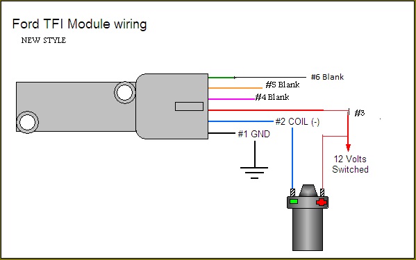

A intermediate thing you can do is keep the TFI, but run it with the timing locked out. When my duraspark distributor failed, to have something to drive I stuck the TFI back in place with no computer. I was surprised how good it ran. When I stabbed it back in and got it running, I turned the base timing up as far as I dared. You can turn it up pretty high till it won't crank when the engine is hot. Then you can turn it back a little bit till it cranks over ok and leave it there.
I was down a little bit on fuel mileage, but it went down the road ok and I drove it like that for over 6 months till I got the other DSII distributor straightened out.
Here is a diagram on how to wire it up.

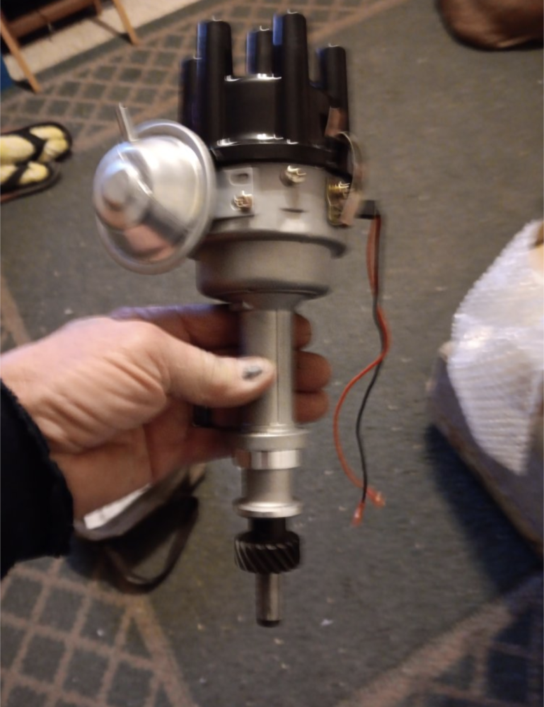

There is another option that a guy on here just tried and says it works good. I think he had to buy it overseas, it's a complete distributor but it is not DSII or any type of Ford distributor. I think it is made by Bosch.
Ah! Yes I did see that, he did get it overseas. I saved the webpage, and also saved in my eBay. I've been going full tilt on here reading and learning as much as I can. I absolutely love TRS!
This was the option that I really liked that jumped out at me, I would love to try that distributor, and maybe a bit better coil would help if I paired those 2? I'm a dummy with this stuff still compared to knowledge in some other areas, but I'm coming along.

My understanding is there is a difference between the factory ranger plug wires and the older style plug wires,something about the cores.
Since the distributor is for a (capri/cortona) I have been getting the parts(coil,plugs and wires)for a 74 capri.
