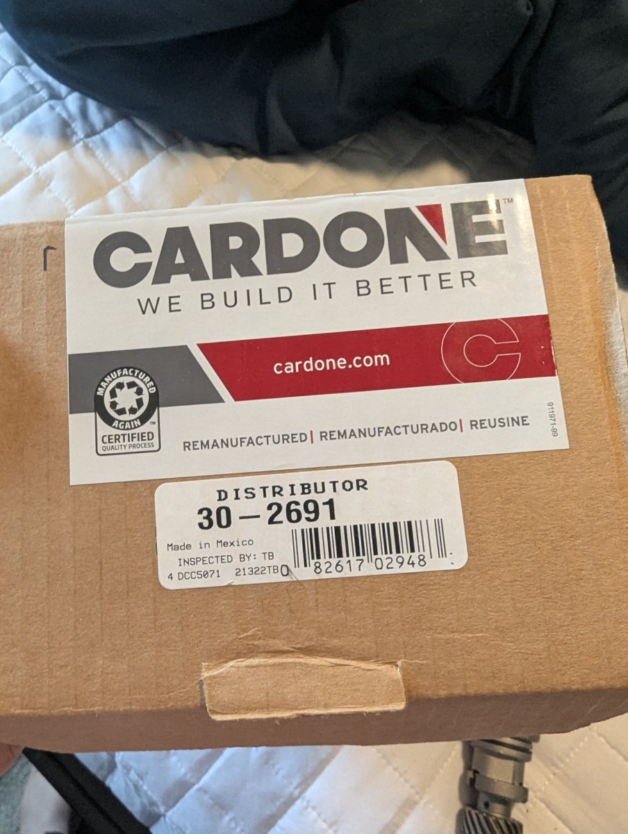

This morning I received a package which contained a Cardone remanufactured 30-2691 distributor. I was skeptical it would come, maybe it was an inventory error, but it wasn't. The source?
Rock Auto.
I specifically remember checking for a 1978 Ford Pinto 6-cylinder Distributor a week before I found this on Saturday. So it just happened that between two weeks ago and a week ago, Rock Auto added the Cardone to its inventory. In another week or so, I'll pop into O'Reilly and see if they have any updates on Cardone restocking the dizzies.
So if you are still looking for the semi-unicorn, keep checking your parts stores and Rock Auto, because this is a clear case where the inventory changed from one week to the next! I will also be updating the Bronco II forum on this.

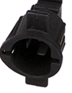

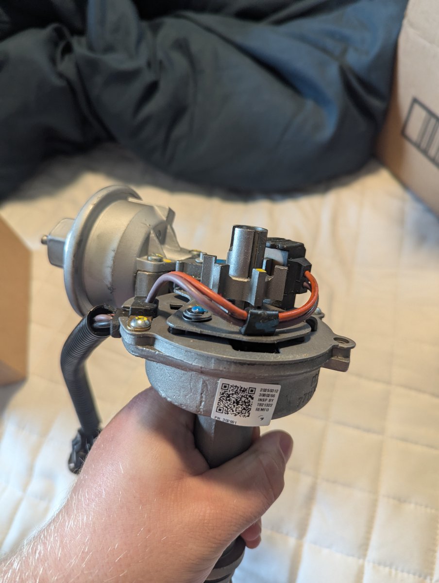

The connector shown in the Duraspark Conversion guide is not going to work for the Cardone 302691. The general shape of the Napa part is correct, however, the fins that guide the sockets in securely do not match up at all. I've attached three images to illustrate this. The first image is the pigtail that is being advised to use as an option. The second picture is what comes on the Cardone unit's pickup coil- NOTICE that the fins on the first one will not match up to the channels on the second. Then the third picture I found online will presumably fit- I found it on Painless Wiring's Duraspark wiring harness.
Just a heads up is all. I'm currently searching for that pigtail.
