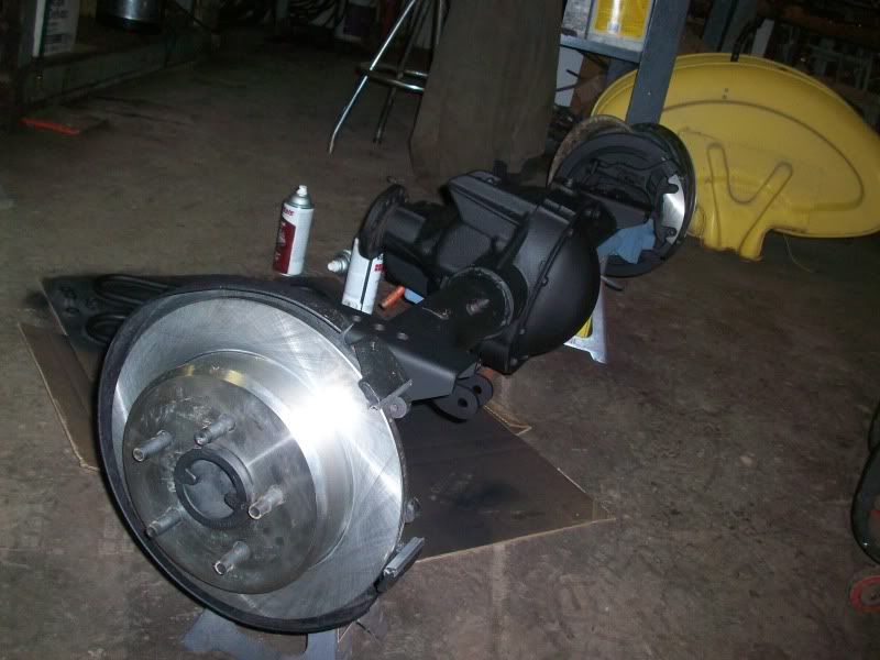

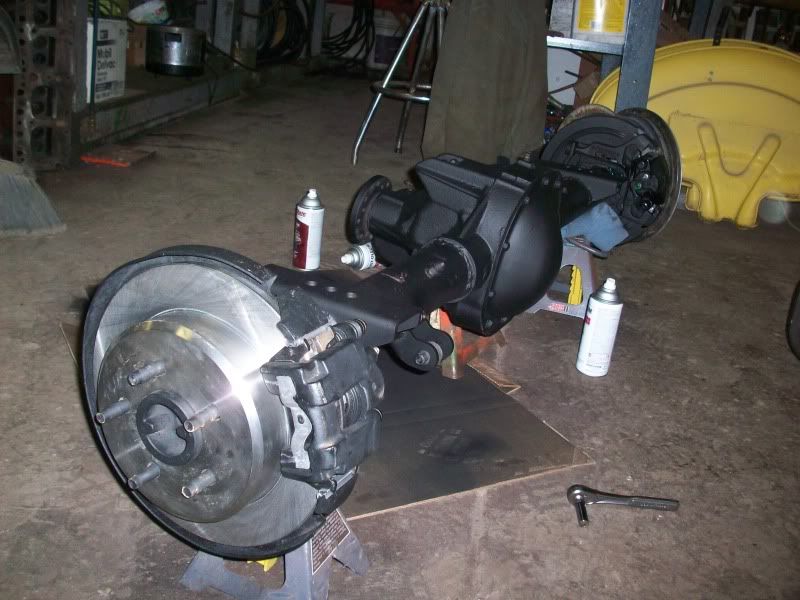

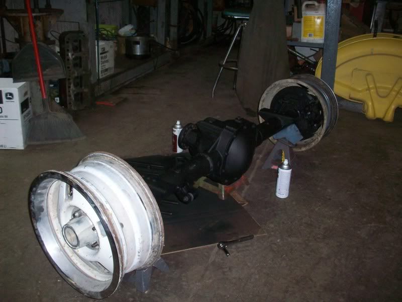

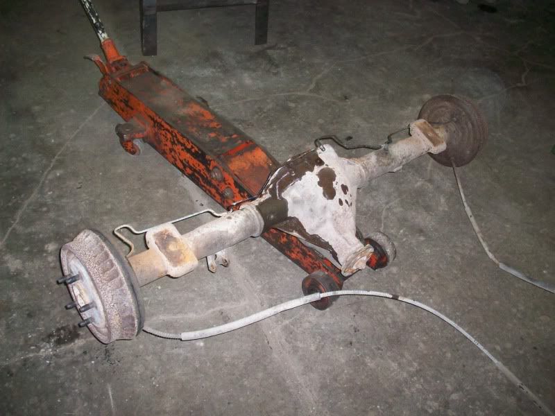

The stars aligned Friday when I could get my friend to weld my axle up, got it painted shortly therafter.
'85 Ranger Restomod
'85 Ranger Restomod
The only thing sadder than nobody ever being able to see the brakes is that they won't stay that pretty for very long anyway...

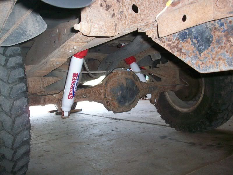

The last time I ordered shocks for the front on Friday at noon I got them delivered that Saturday morning. I did check the FedEx tracker thing and they were on the truck so I ripped off my really old air shocks... my new Skyjackers never came. I figured I could go ahead and fight with the old ones and have that out of the way for the big day, just have the two bolts that would be a cleaned up to deal with. Got to looking closer and they were on the truck for delivery the next business day... :annoyed:
Driving a truck with no rear shocks is kind of fun, you do get some looks as it flops its way down the street.

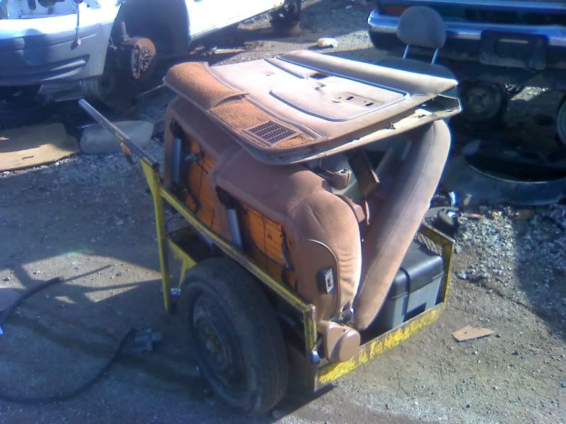

Since my Explorer seats have never really impressed me I have been keeping a look out for something better.
Stumbled apoun an offical Eddie Bauer interior kit...

I probably won't do seat warmers, but I do like the looks of these seats. It is hard to guage if these are as tall as the Explorer seats but at least the drivers seat will have some adjustment to the recline position.
Seat fitment, one of the standard cabs downfalls... :sad:
Edit: here is a better pic of the seats. The seam is ripped out of the DS one, I don't think it would be a big deal to sew it back up.

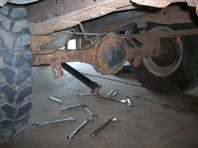

And the 8.8 swap ensues...
'85 Ranger Restomod
'85 Ranger Restomod
Both sides pretty much went like this, which I expected. A long drawn out battle that ended with two pops and a happy dance. :yahoo:

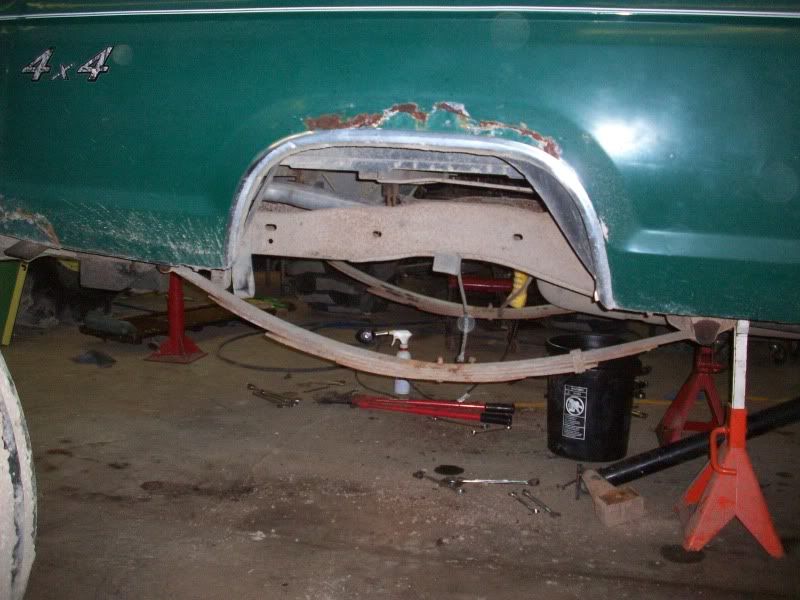

Snagged a helper and got the axle closer to the truck, I can take it from here.
'85 Ranger Restomod
Popped the bolts right out, the spring came out, birds were singing the grass was growing... 'twas a beautiful day.

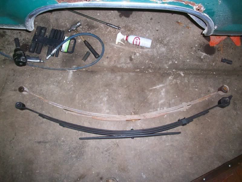

Comparing the two springs, they look pretty close with the only real difference being the thickness of the pack itself.

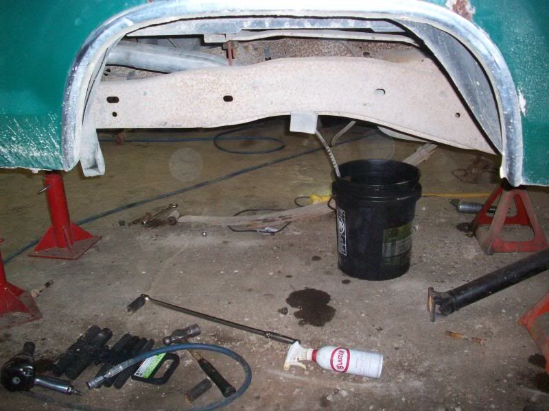

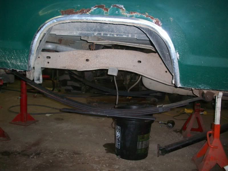

Go the the otherside... the war was on. (actually I started there and moved on hoping to let the beatings and penetrating oil work at it)

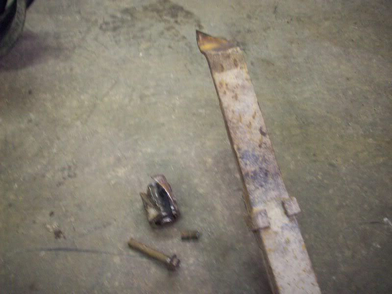

Three hours later, throwing everything at it aside from the torch... which was discussed but I didn't want to with the fuel tank inches from the bolt head I would cut off. I tried a sawzall, it worked great on the outside where I could get directly at the bolt but the inner bushing must be pretty tough stuff, burned through two blades with virtually no headway on the inside. Tried to beat on it with a wide variaty of hammers, break it loose from the backside with a breaker bar... it just twisted in the rubber bushing. I ended up taking an angle grinder, cuting the eye of the spring and went to town with the air chisol. And after three hours of battle:

Finally got both springs in.

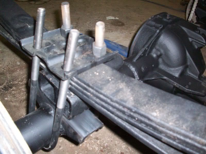

Then I make the discovery that the Ruffstuff perches have a 1/2" hole, which is fine if I wasn't running the factory lift block... but they have a 3/4" peg. So then I dig up a drill and a bit to make that work.
'85 Ranger Restomod
Get the axle in place and then discover that because of my oversized bolts the factory F-150 spring plates won't work. Dig out a die grinder to hog out the holes. I do not like how they are now notched two ways leaving little meat for the nut to sit on, I am going to stick it together to get it out tomorrow and get new ones coming. I didn't get a pic but post hole-hoggin the bolts are parallel to each other.

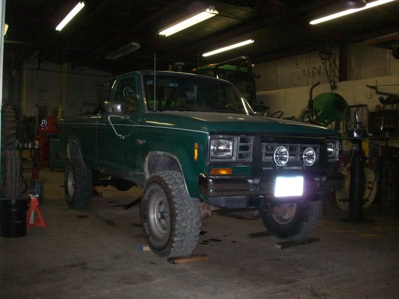

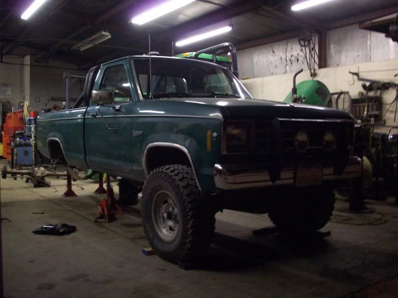

Back on all fours :yahoo:
'85 Ranger Restomod
Netted about 3" of lift, was an inch low in the rear and now is about 2" high. It might settle a little which would be fine, I am good with it either way.
