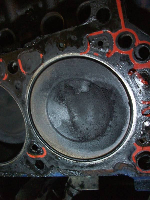

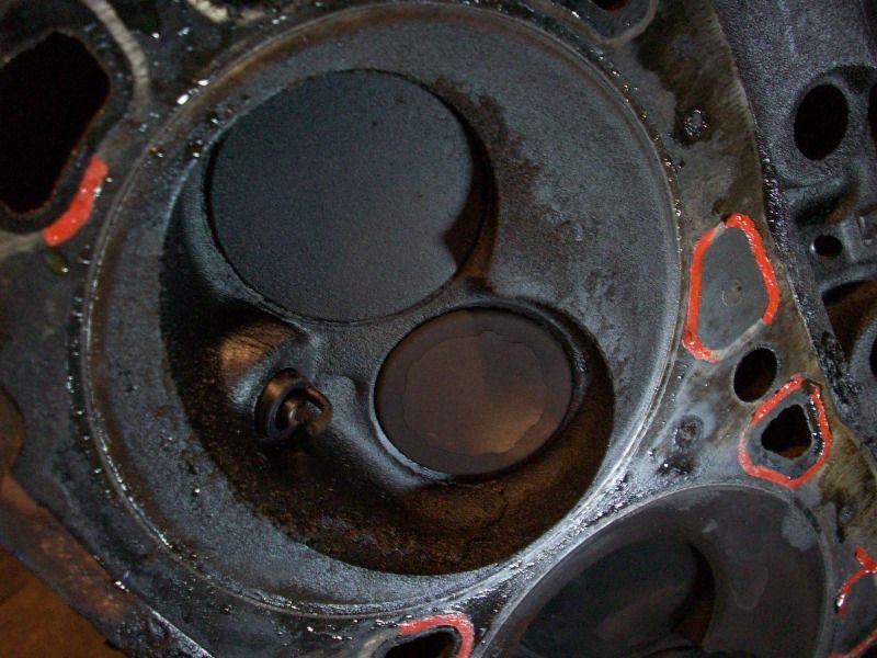

The PS head is off. I really don't see how I could have got the compression reading I got out of #1, it was about 180lbs. There is some carbon there but I don't think it is that bad, the piston does look like it has been hot from something (timing, preignition, detonation...). I had suspected a couple of my colder than spec plugs were fouled... and so was that one.

Maybe it was a valve hanging up or the carbon was staying hot enough to act like a glow plug and preignite it... dunno. Still have another head to go to find more carbon I guess.

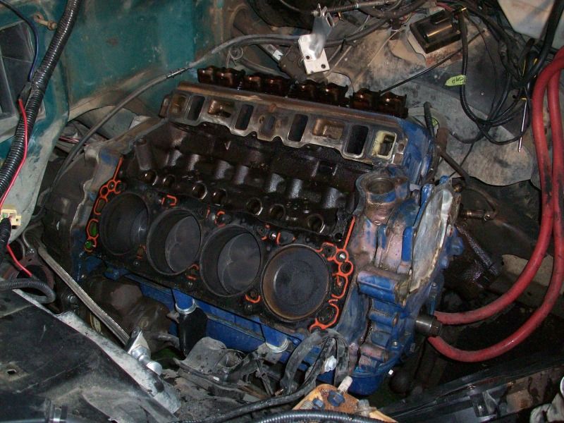

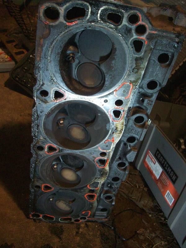

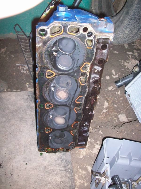

Tonight before a predicted cooldown and rain I got the other head ripped off. Still no joy on finding a massive carbon deposit anywhere. Number 8 had some but I wouldn't call it very extreme.

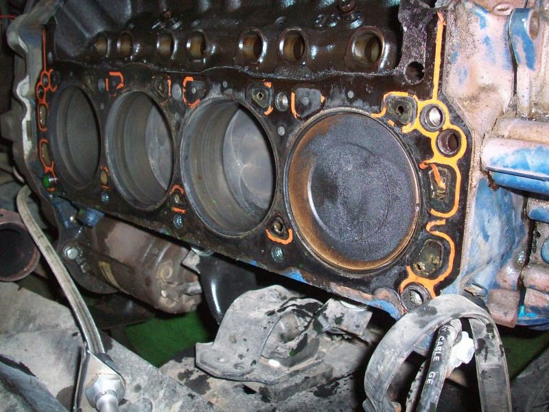

It was easier to pull this head than I thought it would be, I had nightmares (not really) about the steering being right in the way of everything... not the case.

I don't see much to do here, clean up the minor carbon on the pistons and get ready to drop the E7's on.
I tested the valve clearance, pretty sure the E7's are going to clear. The play-doh shifted a little, and after three attempts I was getting tired and in fear of dropping the head on my fender. I am going to try it again real quick just to be sure.
I will say this plug looks the dirtiest of all of them. the rest look very clean and whatnot. I would look more into why.
I have had it running on the rich side to try to cope with the pinging. I suspect that and colder than spec plugs to also try to make the pinging more tolerable have a lot to do with it. Dunno why it is just the one though... I kinda wonder about a valve problem. The extra carbon may have been a factor too, none of the other chambers are carboned to that extent.
