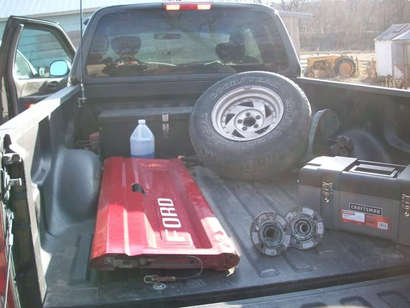

Had me a good day of pillaging at u-pull-it yesterday:
'85 Ranger Restomod
I know the gate is aftermarket, but the darn thing is pretty much new... hard to pass up for $50.
'85 Ranger Restomod
I also grabbed yet another set of D35 Warn hubs (have 2.5 sets now) and since I had time I grabbed all the guts out of this truck too so now no matter what I get for an axle I have the stuff for manual hubs. It would have had the ideal axle for my truck with the bolt on calipers... but had taken a hard hit in the front right. The hit had snapped the end off the steering gearbox and folded the RA and both RA brackets. Somehow both hubs were perfect.
Then I found a BII with a rim matching the ones I have in my Ranger, I grabbed it so I have a nice matching rim for a spare tire.
Another BII had the detatchable smaller 4wd lever for the t-case so now when the lever in the cab is in 4wd hopefully it is actually in 4wd.

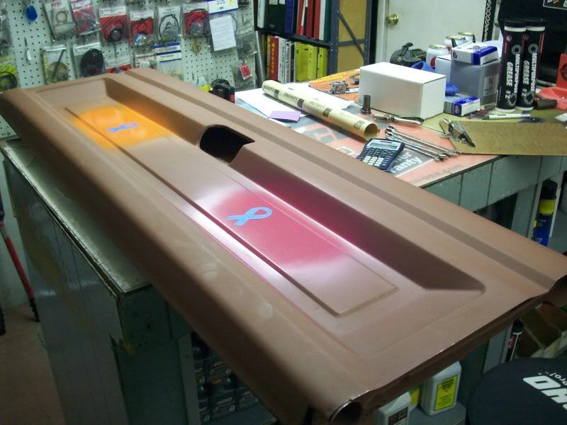

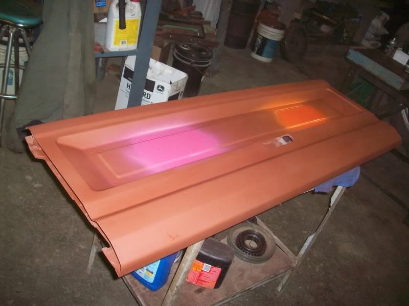

Threw the first layer of paint on it:
'85 Ranger Restomod
The orange was really hard to do but nothing like the light red color... which of course dribbled all over so I am going to have to do a little sanding.
I got it masked up ready for paint tonight, not sure when I am going to get to it. I don't really want to throw paint on it and wrestle it into the shop bathroom so it has a warmish place to dry. Where I am doing this only the showroom is heated throughout the night, and the bathroom has a duct so the pipes don't freeze, shut the door and kick up the thermostat for awhile before I leave and it warms the little room up pretty good. That was hard enough with just the primer (which isn't as picky on temp)
'85 Ranger Restomod
Orange is for my brother (leukemia) pink is for my aunt (breast cancer) The magnet worked but didn't really fit in with the truck, I was always afraid of losing it too.

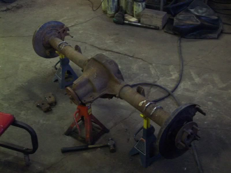

Since the tailgate is on hold, it was recently brought to my attention that with the 302's low end torque and to an unknown extent wider tire patch of the 31's it is rather helpless in 2wd on snow/mud. I got the cure, so I decided to get that ball rolling.
Why can't it be this easy?
'85 Ranger Restomod
3.5 cutting wheels later (those pads are pretty thick, almost like they don't want them to come off :icon_confused:)
'85 Ranger Restomod
Ground flatish:
'85 Ranger Restomod
I wire wheeled the whole thing and threw some primer on it to keep it from rusting until I get the parts in and on to continue.
'85 Ranger Restomod

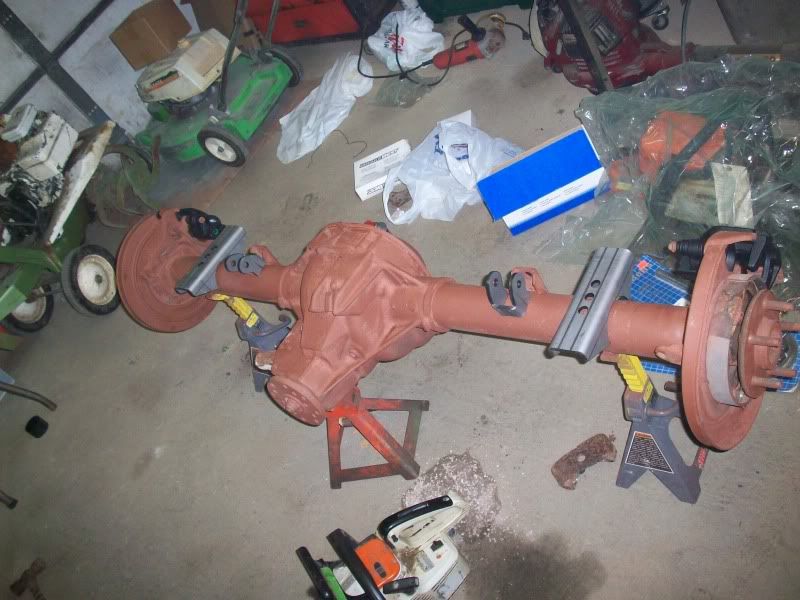

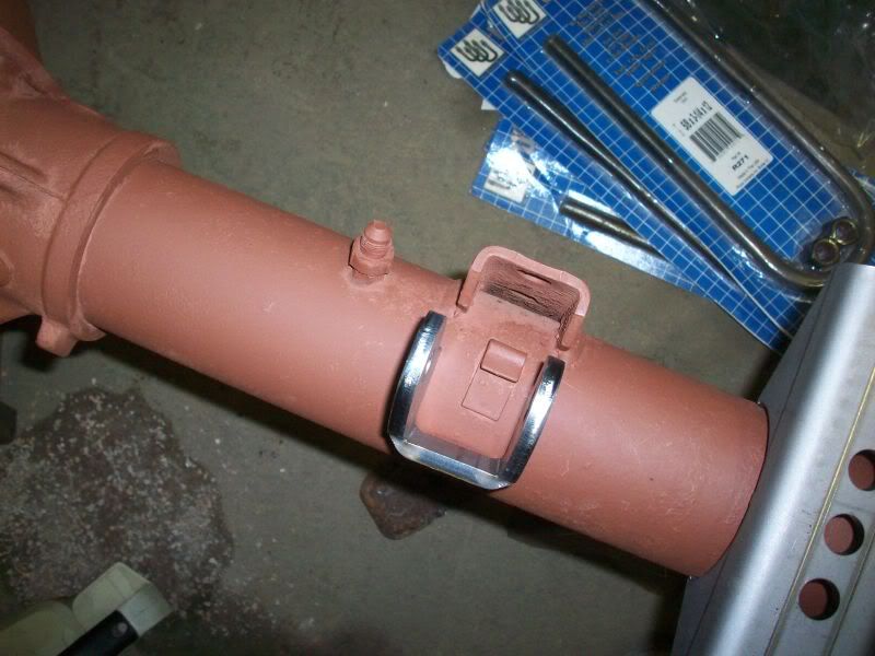

I got the Ruffstuff perches (and one piece shock mounts) ordered, since they are something like 7" long to counter axlewrap it seems kinda silly to keep my stock lift blocks. Kinda wondering how this will play out with Explorer springs...
I finally got my stuff from Ruffstuff, apparently they had to make it because it took a week.
It looks really nice but I have discovered yet a few more snags.
As near as I can recollect I got this axle in roughly '07-08 and disassembled the brakes shortly afterwards... so I didn't exactly remember how things went. I cut the axle pads off per the instructions in the tech library... which means I now have to weld nuts on the the new mounts for the brake lines to mount to. So IMO if you have a disc brake axle I would forgo that step, which will save you a lot of time. The springs are the same distance apart so I don't think the old pads would have hurt a thing down there tucked between the u-bolts.
I laid the newfound parts out on the axle and discovered one of the sway bar brackets is going to have to go. Might as well zip both off so it looks decent.

Those ar ethe exact same ubolts that I am using. The nuts do like to seize up on them after a few months so be sure to put some kind of anti seize on them.
Long story short I have to cut mine off for when or if I do an axle swap due to this.
Hopefully this axle will stay in longer than anti-seize will do them any good. It was part of the plan though.
The current (likely original) bolts are pretty well in there. Shortly after I got the stuff I was going to just poke the springs in. It stalled out our big 1/2" impact and I couldn't shake a one with a breaker bar and pipe. Since I didn't have any bolts for the 7.5 and didn't want to run out and buy a set I didn't push too hard, I am afraid the 3/4" impact or a big cheater pipe would have just busted them.

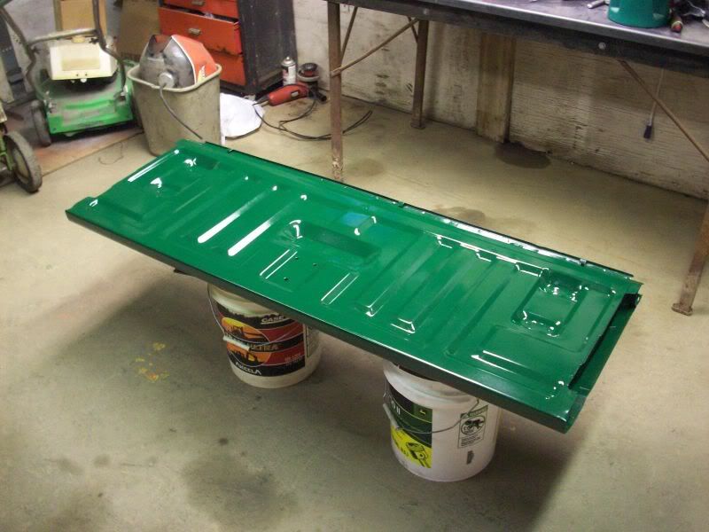

I finally got the inside of the tailgate painted.
'85 Ranger Restomod

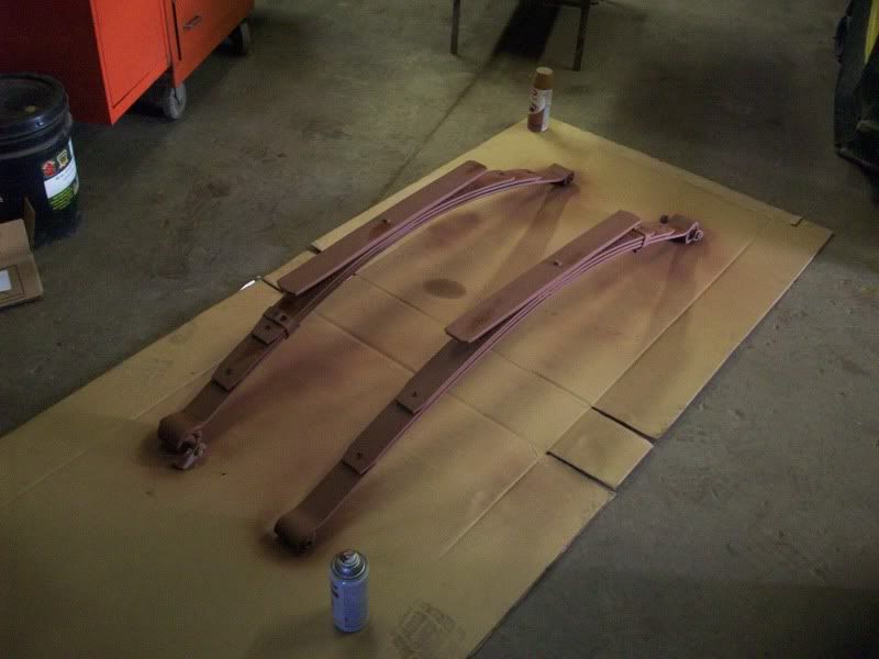

It was also nice so I got my springs cleaned and primed.
'85 Ranger Restomod
