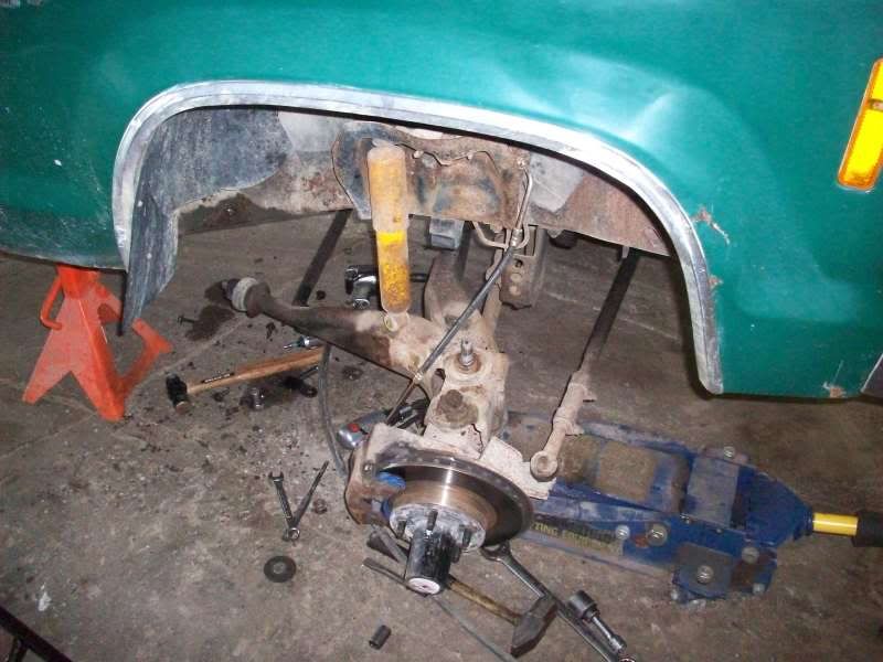

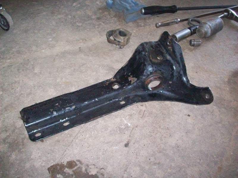

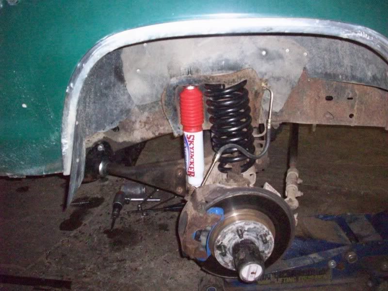

Bead blasted and threw some paint on that stud, chased the threads and locktighted it in (like it was originally) poked the spring back in and ripped the rotor off last night. Cleaned everything and packed the bearings during my noon hour today. Got it all put back together with new pads and slide pins, hooked the swaybar and shock back up. Ran it over to the shop so I had more room after supper.
Really kinda fun, after fighting that side the other side just went zip zip now that I have done it once. Reremembering the coil bucket was open on top and having the tools at had to run a 1/2 drive wobble, extension, ratchet and a long breakerbar and that nut didn't have a chance. Beat the heck out of an open end wrench like I used for the other side. It even came out the right way leaving the stud in the beam. I have it back together and I am thrilled to have a whole weekend to deal with the radius arm bushings now.
:yahoo:
Both sides are done... completely. :icon_hornsup:
Attacked it with a cutoff wheel, air chisel followed by an air hammer and changed the radius arm bushings while I was there. Much to my surprise the shocks I ordered Friday at noon were delivered sometime Saturday morning so I slipped them in too. Streetsideauto pulled thru great for me, free freight too. Started it shortly after 8AM and with a couple interuptions got back home at 11:00PM
All told it might ride a little smoother than it did originally, but it feels like a new truck. Firmer and more cooridinated feeling.

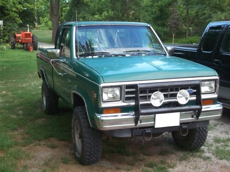

The whole truck:
Kinda thinkin' I might just throw the 31's on for an upcoming car show and then pulling it off the street until I can do a D35 swap over the winter and then have it aligned.

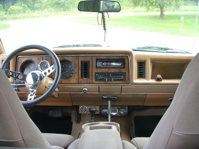

Factory tach cluster (any input on how to convert and tune to work with a V8 would be great)
Against my non-tach cluster out of my '86 parts truck.
Most of the cab wiring in my truck is dated '88, and mine has all the idiot lights so I am hoping it won't be too tough. It will be nice to have a big tach rather than the little aftermarket thing I have now between the gauge pods. The gauges won't be missed, I already have mechanical temp and oil pressure gauges. In 11 years of ownership I never have seen the ammeter do anything.

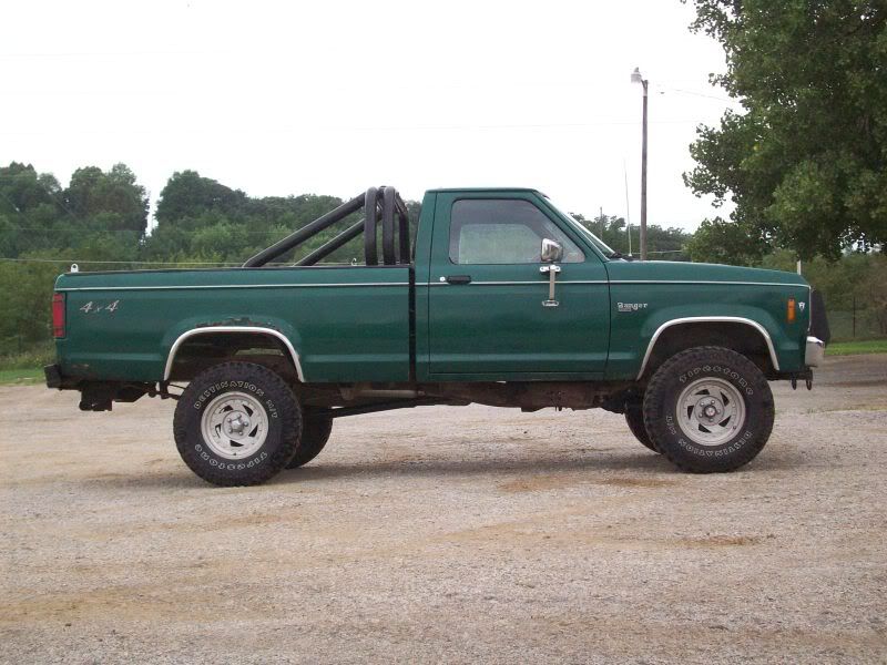

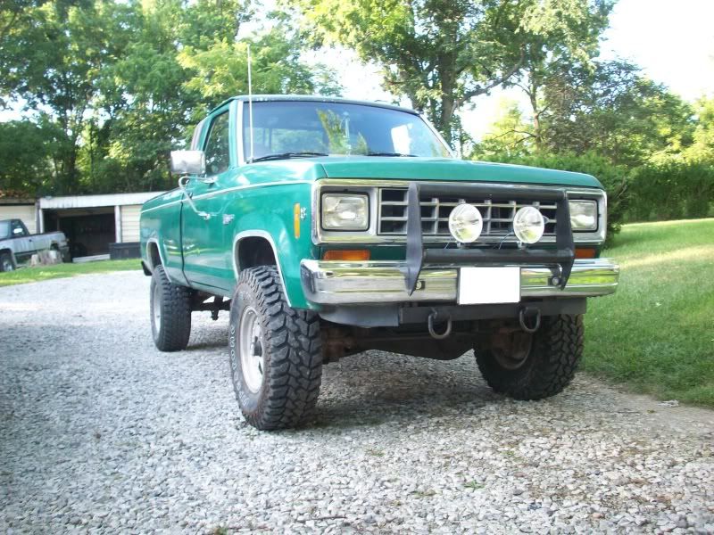

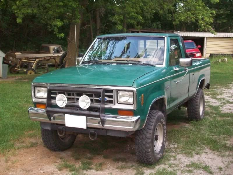

Tires are on, I only had the front mounted, balanced and installed before it got dark.
The Dunlops rode better, but the Destinations don't vibrate all over the place at higher speeds and are quieter. Truck is still pretty spunky, didn't hurt the drivablity much.

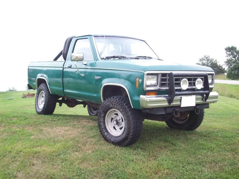

I thought I would stretch her out a little and check clearance, it passed. If it bumps to hard while turning it might rub a little though.

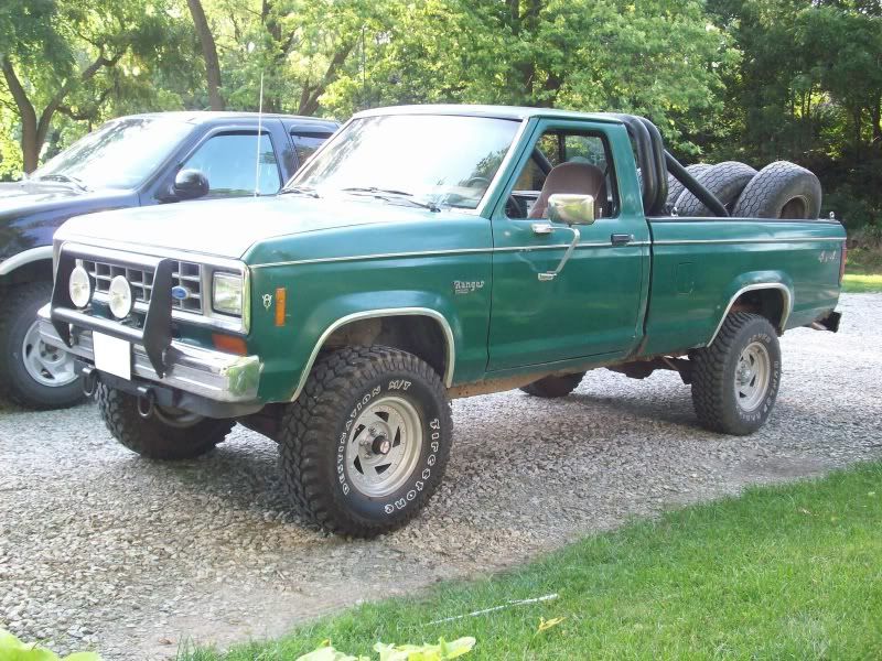

Pulled it down on the level to get a couple "at rest" pics, I had my camera set goofy to deal with the glare from the first set, only the broadside one came out.

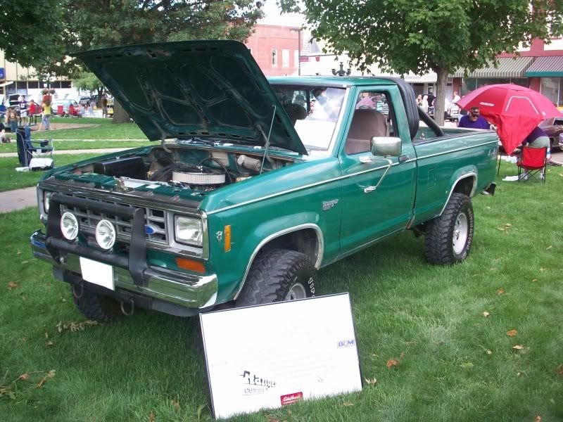

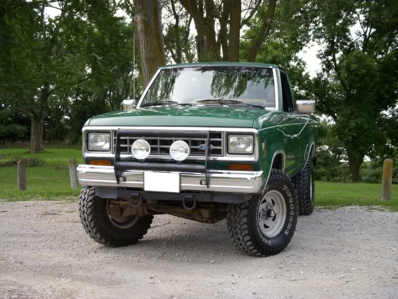

I got it all spiffied up for my club's car show a couple weeks ago. Didn't stand a chance at the host's trophy but it was fun to get the old girl spiffied up. I don't think I have had it looking this good since my junior prom back in '02, it is already well on its way to looking like its normal self.
I need to do some more work cleaning things up, but it doesn't look half bad.

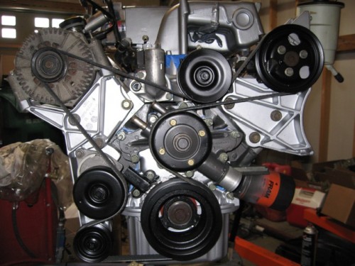

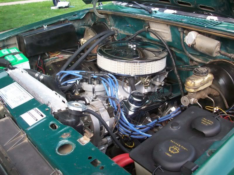

I picked up an Explorer FEAD, should make working on the thing a little easier. I still need the timing cover, after all the work getting to the Explorer one somebody at some point (it wasn't me, honest) bent and broke a bolt and I couldn't get the stub out which pretty much pinned the cover on. If a used one doesn't happen along it is worth the $100 not to have to dig to china on another Explorer for another attempt on a cover.
Right now to deal with anything aside from the belt the radiator, electric fan, tranny coolers and grille have to come out... that bugs me. The accessories are mounted nice and high with the Explorer setup independant of each other, and is also much closer to the engine.
The power steering pump is supposed to be a lot better, alternator is 130A vs my 65A 2.9 alternator.
