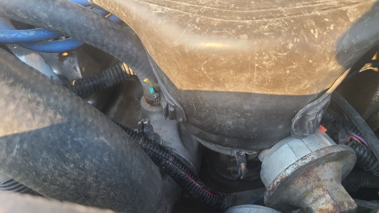

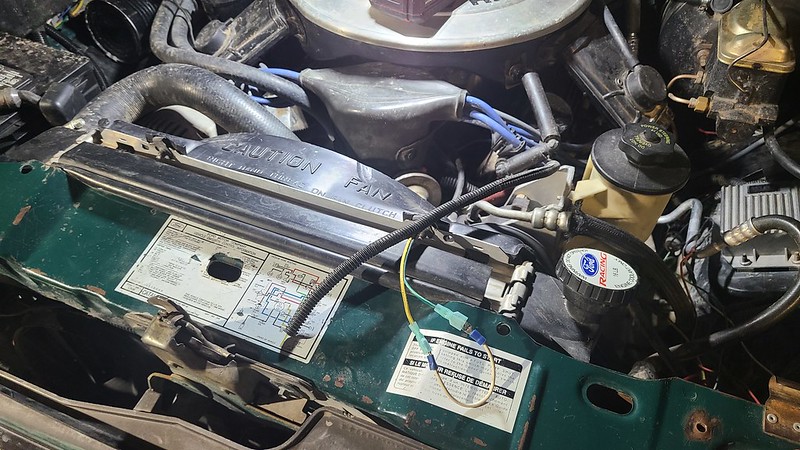

Over the night a stupid freaking mouse chewed both wires off the connectors going to the temp sensor. :temper:
I had made a jumper last night specifically for this connection to test the fan operation.

Well the POS left me enough wire to just put new ends on it. So I did that and retested it with the jumper I made Tuesday night and everything still worked as it should.
'85 Ranger Restomod
I let it sit and idle while I tuned up the brakes on my bike and the fan cycled on and off like it is supposed to. Its been awhile since I heard them run but the fans sound like they have more gusto with my current setup.

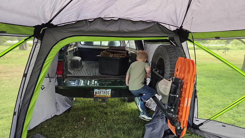

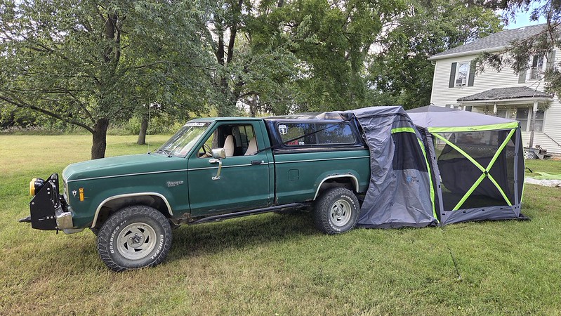

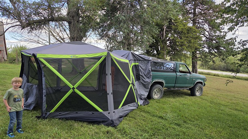

We inherited this canpoy last spring, finally tried it with the connector piece... and I think the Ranger truck bed sleeper can now have a screened room. There are curtains that will fill in the mesh too.

As my team grows bigger I wouldn't be opposed to using something like this for a regular tent where we can sleep on cots and the truck has a drawer system so we can utilize sharing a tent with the truck. Here it is shown with the main tent body really too close to the truck, it could move away from the truck a long ways, the entire back window of my topper is blocked. Also it has a door in the connector peice as well on the drivers side.
