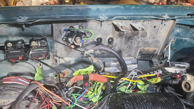

Current electrical system is functional. It generally works great and is easy to service. It quickly turns into a pile of spaghetti once the wires leave the fuse panels though. Having seperate relays do not help but the fuse panels kicking the wires out the sides increased their footprint dramatically and makes it difficult to organize.
Also I need to beef things up to the efans. Last fall en route to Kentucky I popped the fuse. Replaced it and it ran the whole trip and all winter fine. I got it warm a couple weeks ago and found the fuse popped again. This time I did find some melted wiring so that will be addressed, I matched the wire size that comes out of the efans but probably in error had them both running off one wire, they will now each be getting separate power straight off the battery now.
Also, I want to be able to hardwire the efans to just run no matter what. If a relay lays down or whatever I want fans until I get to port. And on an opposite note... I want to be able to kill them from wheelhouse for water crossings.
What we are starting with:

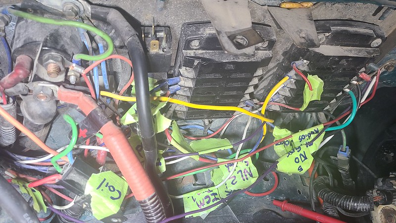

Labeled everything:

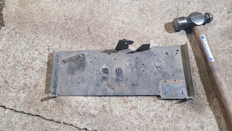

Pulled everything off the plate and removed the plate to lay the new hardware out:

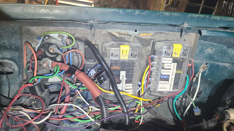

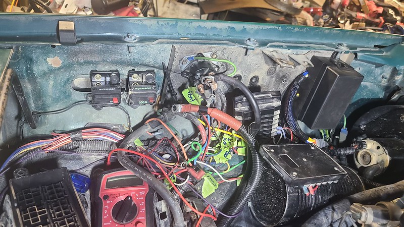

Each new panel has four relays and 8 circuits. And all the wiring is directed out the back before it comes out in a harness which will dramatically clean things up.
I had cut the studs off that retained the 2.8 vacuum stuff before, now I ground them smooth and flattened their bosses.
'85 Ranger Restomod
Starting to go back together. I also added two circuit breakers to the left. One for these two panels and the other for the efans.
'85 Ranger Restomod
The rear panel (constant battery) is pretty much done.
'85 Ranger Restomod

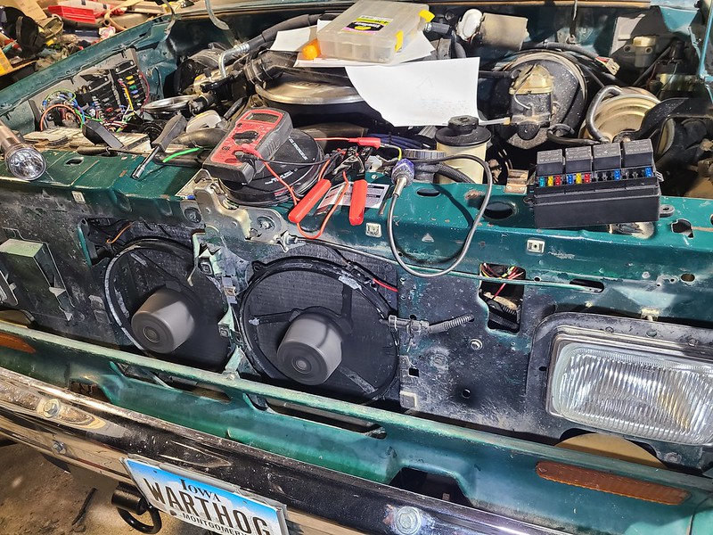

For reasons I don't remember last fall when I started doing this I wanted to wire one of the fuse blocks myself. Since I can't remember why exactly and it is so nice to just put pins on wires and go... I have ordered a second prewired block. It is supposed to show up tomorrow so I can finish the system.
Started labelling things... ran out of label tape so we got shut down on that as well.
'85 Ranger Restomod
It looks like a freaking mess...
'85 Ranger Restomod
But if my supervisor isn't worried why should I be?
'85 Ranger Restomod

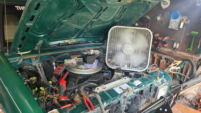

When they dyno cars they use fans of various shapes and sizes to cram air in the grille to act like the car is actually moving.
'85 Ranger Restomod
that is a 600 dollar fan
best to put relays right on the fans and a 3 way switch for off on and auto via ground side. relays and spare fans are cheap and take up little space. put it right under the bed..

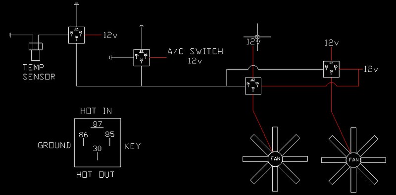

Last year I made a series of relays to do that, so the fans will run when the A/C is on (12v supplied) or if the temp sensor deems they need to run (ground supplied).
'85 Ranger Restomod
I got busy chasing my tail with everything else and didn't have a chance to circle back for the killswitch before last year's trip.
They are not "on the fans" but that block is on the gusset right behind the DS headlight.
'85 Ranger Restomod
There is just one ground wire coming out of that relay block and it is practically begging to get ran into the cab, it will be a very easy thing to do I just need to do it.
And since Amazon deemed my last order with my second fuse block and a couple more connectors "undeliverable" like a half hour after it left the warehouse yesterday I suddenly find myself with a lot of time to do things not really related to the fuse panel upgrades...
My drive to "just make the dang fans run" comes from last year, I popped the key signal fuse which shut the fans down. Due to not having a current schematic with me and my new wire not labelled on the fuse panel I couldn't easily troubleshoot it at a gas station when everything was a million degrees under the hood. I am going to just put a two wire plug on the main feed for the fans and the same on the fan from the relay to the wiring. So push comes to shove I can just plug the main feed directly into the fans bypassing all the automated relays and still have the circuit breaker by the battery for safety and to kill the fans like for startup or whatever if I want. Purely a limp mode.
And after this I am going to have spare relays and fuses coming out of my ears. I already had enough to run the truck and each fuse block comes with enough fuses and relays to fill all the slots.
