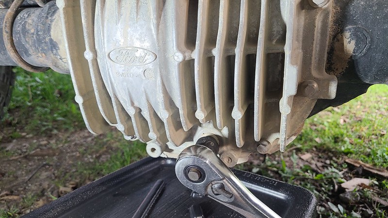

Limited slip started chattering so I treated it to new oil. Oil was dark but smelled good and showed no signs of water.

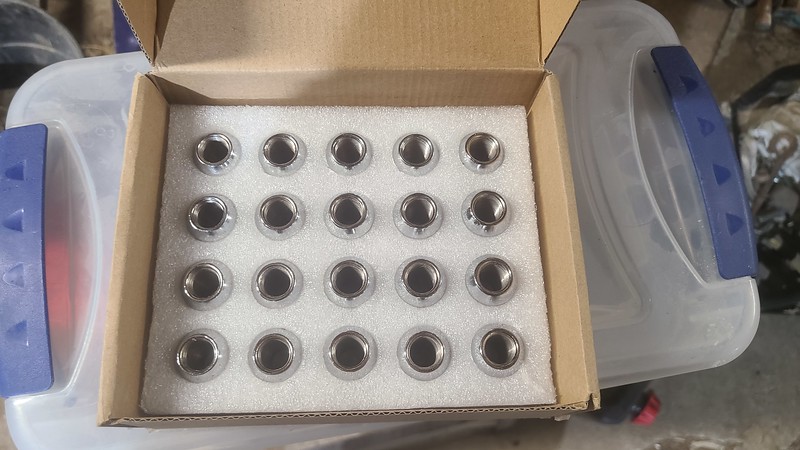

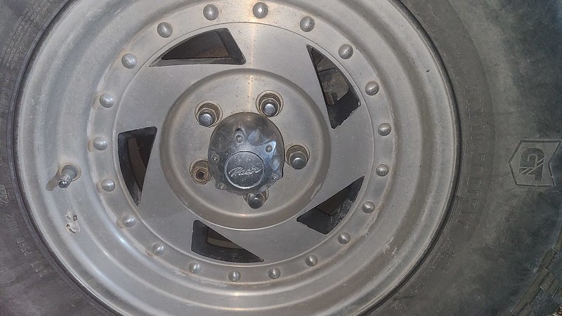

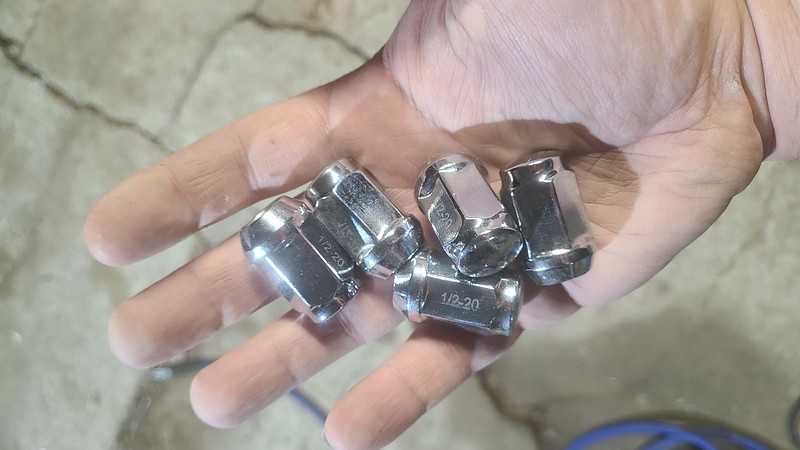

I have been needing to rotate tires, I skipped it last year so its been awhile. My lug nuts have been a thorn in my side as well, they take a 13/16" socket which not only puts socket tight with the center cap but also doesn't match the lug nuts for the spare (which won't fit with the nuts on the truck) or the factory lug wrench. I got the ones that are on it when I did the rear axle so around 2012, they were getting pretty beat up and were starting to lose their caps (just end cap, the actual nut was all one piece)
Gotta love how they package these lug nuts like the are H&H .416 Rigby rounds or something fancy like that...

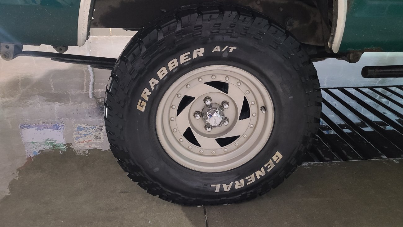

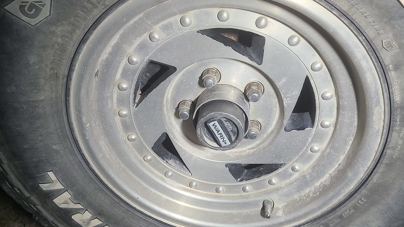

Before:
'85 Ranger Restomod

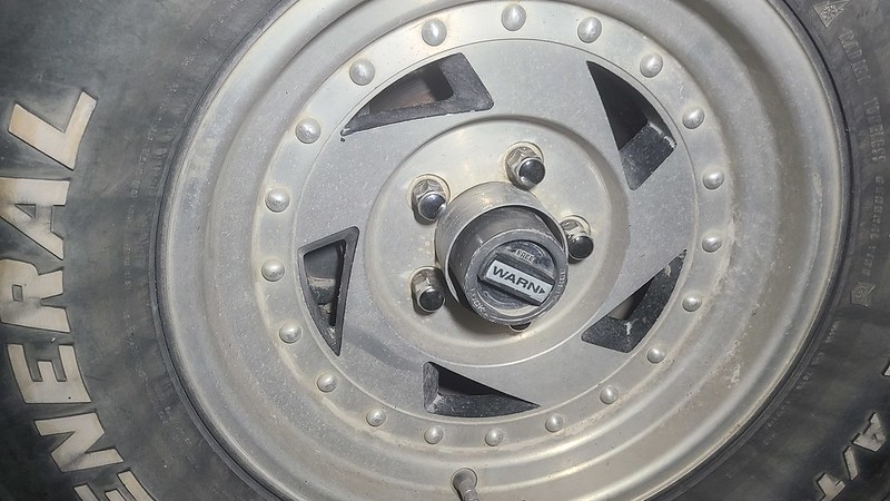

After:
'85 Ranger Restomod
I had lost four caps so far which has irritated me more and more as they keep coming off.
'85 Ranger Restomod
These could grow on me...
'85 Ranger Restomod

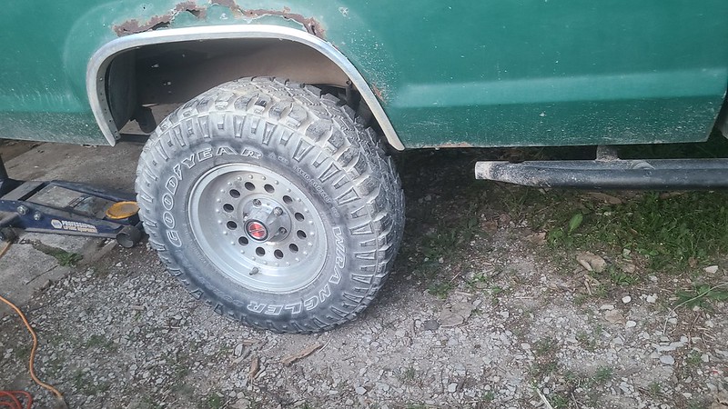

Its kinda sad how hard they got ran into the ground though. Back in the day I think that style was like "the wheel" to have, or at least the real modular ones. Ford stuck them on everything for decades though and kinda too the pizazz out of them.

Lugnuts are a small fortune, but it does make a difference when needing to remove wheel. Back in the day it was quite common to replace stock wheels with something different just to make the truck stand out. I still like some aftermarket wheels but putting to modern of a wheel on an older truck doesn't always seem right to me. The wheels grew on me, and it is period correct. I think you will eventually like them. How people get them so shiny is beyond me. Hope nothing is wrong with your diff.
What brand lugs did you buy? The Dormans haven’t held up for me considering all the repairs and rotations I do. Thx.
I was just using my spare as a crutch while I rotated tires.
Axle is fine, I think the oil was tired. Limited slip was doing the same thing back in 2019 after Ohio. I did the more aggressive clutch setup too.

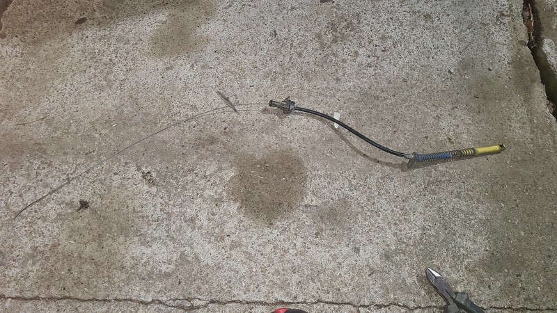

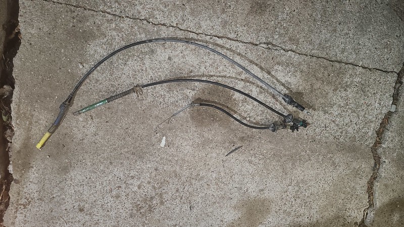

Playing with throttle cables tonight.
F-150 (application unknown) top
2.3 carbed center
2.8 bottom

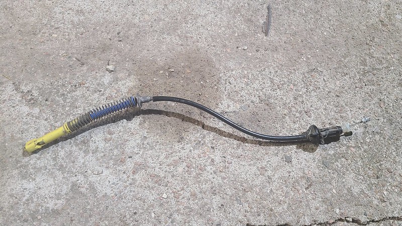

I cut the end off the long cable and put the cable into the 2.8 cable housing. The spring and guide fit perfectly.
'85 Ranger Restomod
It has more travel than the carb does too so that should help, about an inch more than the 2.3 cable.
I was measuring things up and the wind blew my pack of ferrels off my table into my gravel driveway. I had my back to it when it blew away and so far I have only found the double ferrels that I don't need... so I need to get more tomorrow if I can't find them in the daylight.
Throttle cable is rebuilt.

There is a show and shine Thursday so I washed it last night, really liking the non rusty lugnuts that are not missing caps.

Wheel shined up nice. It takes a lot of effort to get them there. I am eventually going to try the zip tie fix. Great job!!
I just sponged them, they need polished but that's a lot of commitment for a gravel traveller
