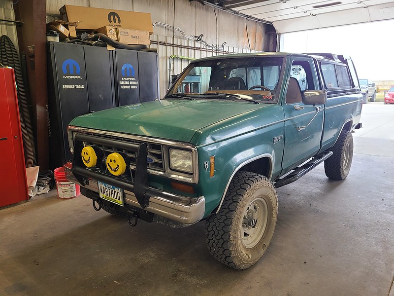

I should have started one of these a long time ago, so there is some catching up to do.
In late August 2000 for my high school vehicle, I don't remember what day it was but I got insurance for it on 9-11-00 (I remember being shocked right after 9/11 when I went to put the new card in it)
Just like this but with a black grille and an aluminum toolbox that has came and went several times since:
I joined here for the first time in 2002, when my first A4LD died. I got a parts truck for the trans and that is where I got the chrome grille.
In 2003 I made a grille guard from some salvaged steel.
In 2006 I added a 3" bodylift. In 2007 I picked up a set of 235/75-15Dunlop Mud Rovers (same size as the street tires it came with) I don't have a pic of it with the regular tires, take my word for it... it looked stupid. The front bumper bracket followed shortly thereafter.
In 2008 I picked up a much better looking set of rims at a swap meet for $75.
Later in 2009 I picked up rollbar for $20 off of craigslist
Along the way I had been gather things to replace the dying 2.8 with something that if it didn't beat 10mpg... justified it. I got sidetracked on an engine that needed a ton of work, eventually I found a good one.
Swap thread:
http://www.therangerstation.com/forums/showthread.php?t=61372&page=3
I finished that somewhere around March (it is in that thread somewheres)

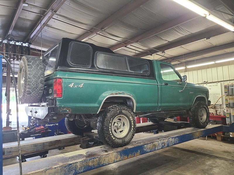

Ran it into work on my day off. While waiting for another guy to finish with the four post I cleaned the inside of the windows in my topper, holy cow what a difference.

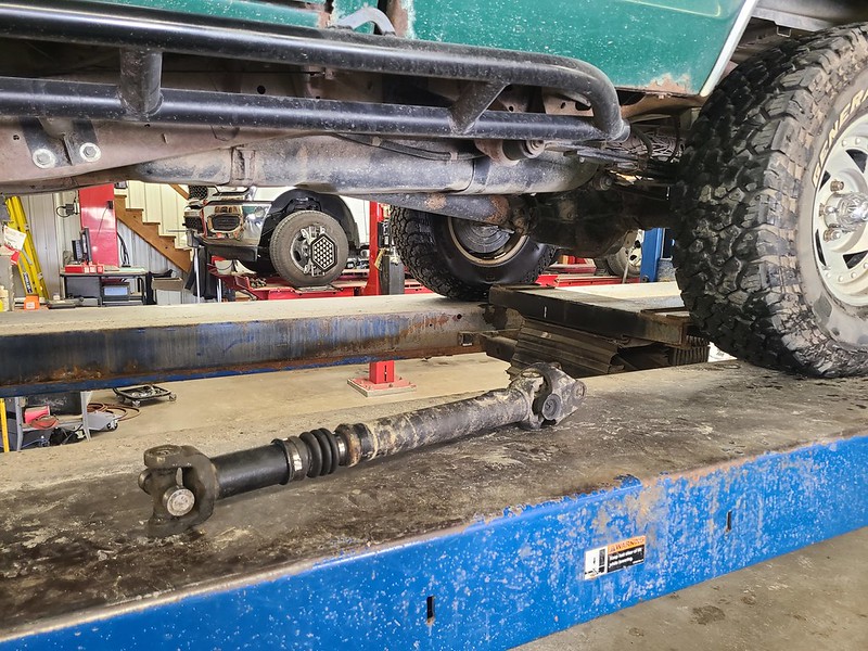

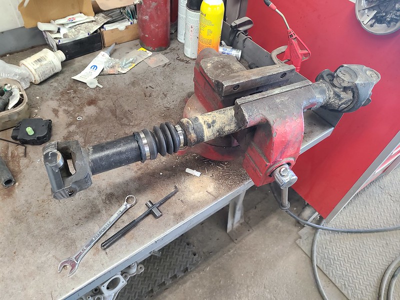

Also assembled my driveshaft.
Rotated tires, even washed out the inside of the wheels. Especially the rears were getting fairly caked up.

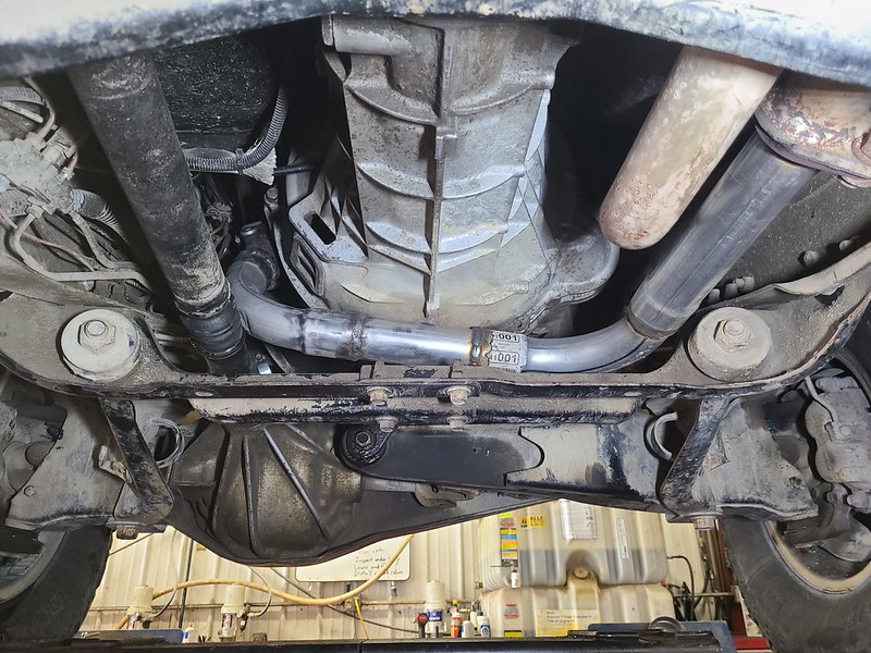

Drumroll please...
Poof, real 4wd any time all the time!
If it doesn't work I can find a driveshaft that just has a seal instead of a boot and go that route easily from here, it is close but I think it will work.
After I am sure it will work I probably need to put a cross in the front of it... but until I know it will work it can ride for now.

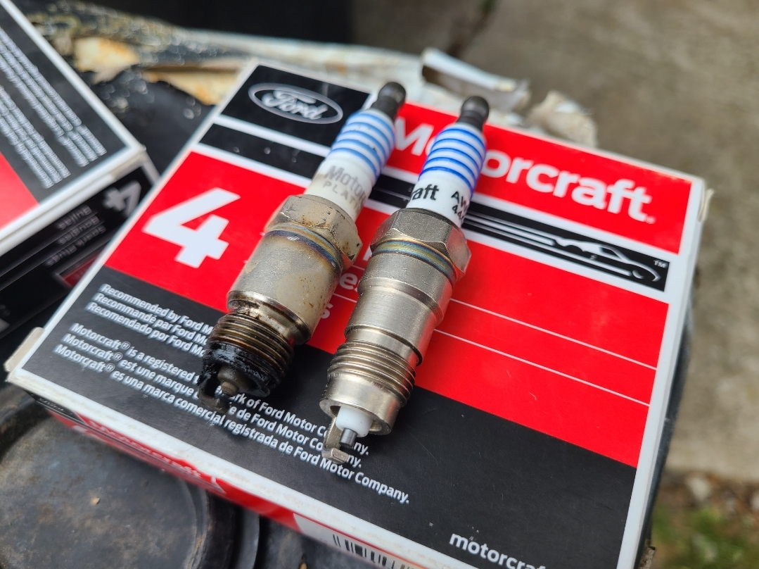

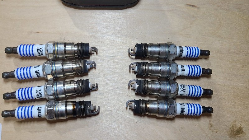

Finally got around to pulling the plugs to see how things were looking in there. I know the left bank/right exhaust pipe was smoking at times on the trip so I was especially keeping an eye on that side.

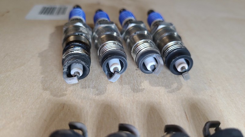

Sure enough, #1 was a little more crusty than the rest of them. Really not bad though, even at its best my 2.8 could oil fowl the plugs in like two weeks and I have like 2k miles on these plugs (they were new with the head swap)
Plugs are sitting as they are from the front of the engine bay, #1 is bottom left.
Bank 1 (passenger side)
Maybe kinda ashy, maybe kind of normal overall, maybe I just need more miles... I dunno
Something is going on with #1 I think. Probably trashed rings but I am going to go ahead and pull the valve cover and valve springs and make sure a seal didn't move. If not, then it is what it is until I turn up a fresher engine.
And yes springs, because I have dual valve springs I can't really see the seals in there...
Kinda miffed though, it is using less oil but smoking more... :annoyed:
Found the pic of my old plug, this was #1 before. It had also been in for several years.

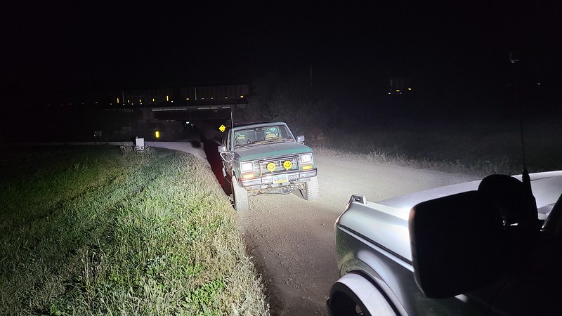

So we shot bluerock and rifles and grilled steaks in a hay field. Nice cool night and I don't have a ton of confidence in the truck so I just take gravel home. Make it like 3 miles from home, I downshift to go thru a railroad tunnel and the low oil pressure light comes on as I clutch it... the fire went out.
So I crank, it lights right off and dies. Crank again, lights right off and dies. Ok, likely something to do with the primary ICM wiring. In start mode the wire from the starter relay ques the Duraspark module to retard the timing so it starts easier, once that goes away it rolls over the main 12v feed. I get my little $2 harbor freight testlight out of the glovebox, pull up my diagram on flickr on my phone and sure enough, no power at the module connector, go back to the connector on the rad support... no power there.
So I call Amanda, she gets me as I formulate a plan. Get home, I grab my test wire roll and we get back, I just jump the ignition and sneak it home in second gear so my roll of wire doesn't shift and roll down into the header or something.
Cause of loss of fire identified.

So I throw a new set of plugs in it... bingo. Runs friggen perfect again.
I didn't drop them, I can see nothing wrong with them. I have no idea what happened but apparently something happpend when I pulled the plugs out last week.
If it comes back, I'd check the plug wires. Sometimes the connector gets seperated form the lead when/if you pull the wires to check the plugs. Putting in the new plug, you could have pushed the connector pack up into the wire and its working good, for now.
