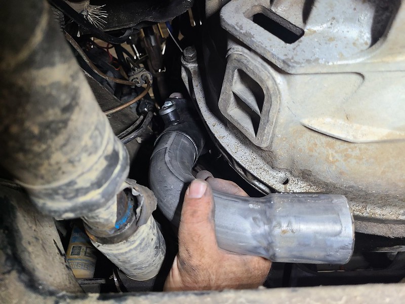

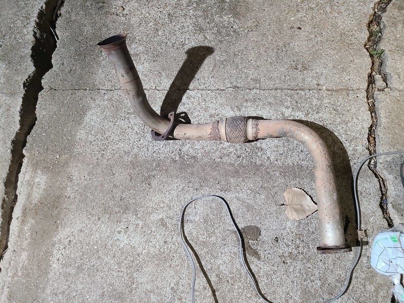

Ripped the exhaust pipe to-be-replaced out of it.

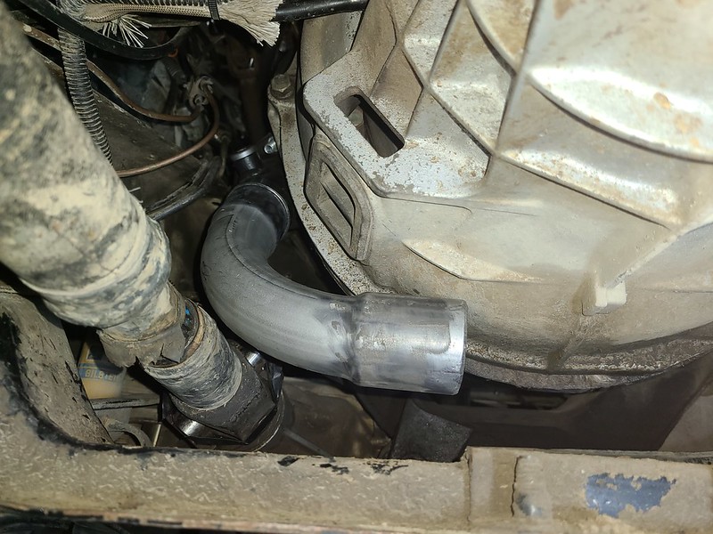

I splurged on the header reducer and snagged one that already has a bung for an O2 sensor in it in case I ever sneak up on a Sniper or similar down the road. Most only require one sensor to operate. Part hoarder coworker at work had a couple plugs that come in new cats stashed away and was kind enough to share one with me.
I need to get the one end of the pipe swelled (Hedman and Walker has different tape measures apparently) and it took all sorts of contortions to get to get the pic so everything isn't exact how I want it but this is what I am going for. Exhaust is about an inch ahead of where the boot will go for the front driveshaft with good clearance.
So yeah, it may or may not need an engine but it just might have functional 4wd without a hour long front driveshaft wrestle session.
