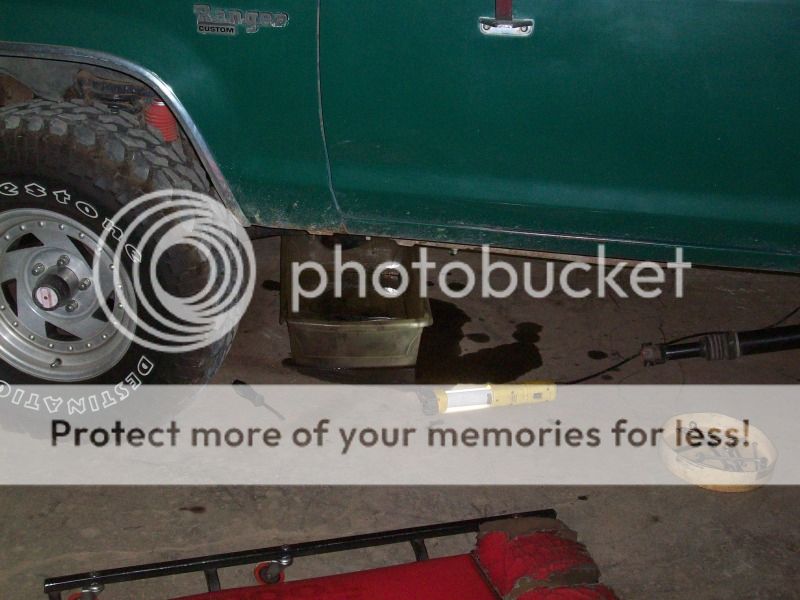

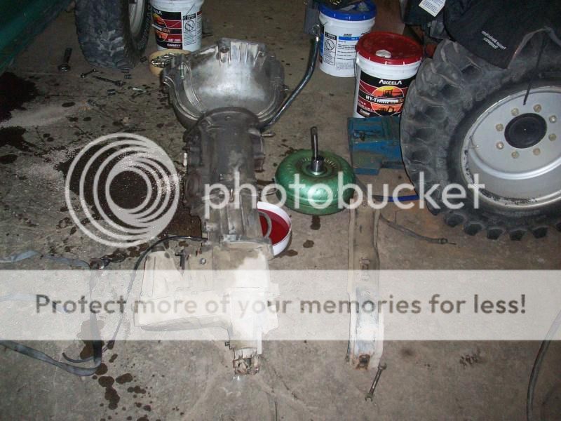

Overnight at the shop, all I did that night was yank the carb, put the engine plate on so I could use the hoist as a backup "just in case" and dropped the driveshafts out of it. That is the kind of a leak I am dealing with, it has been getting worse.

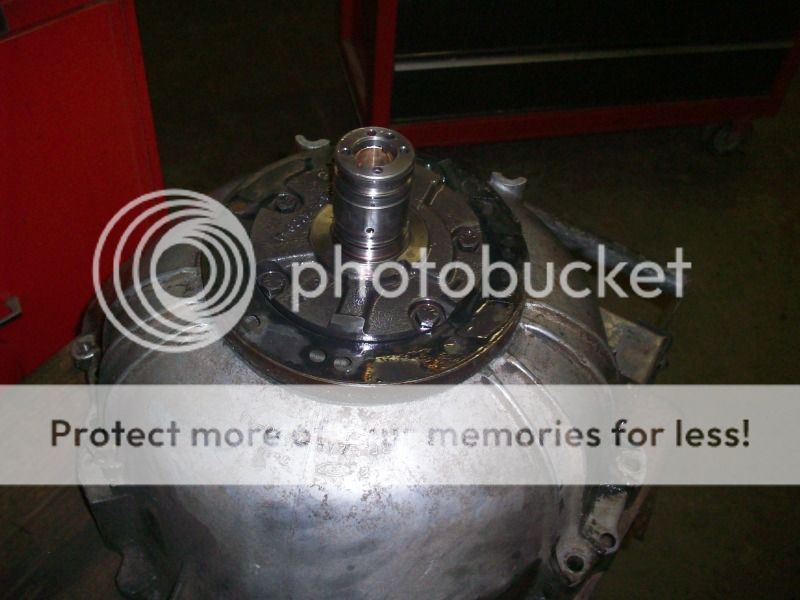

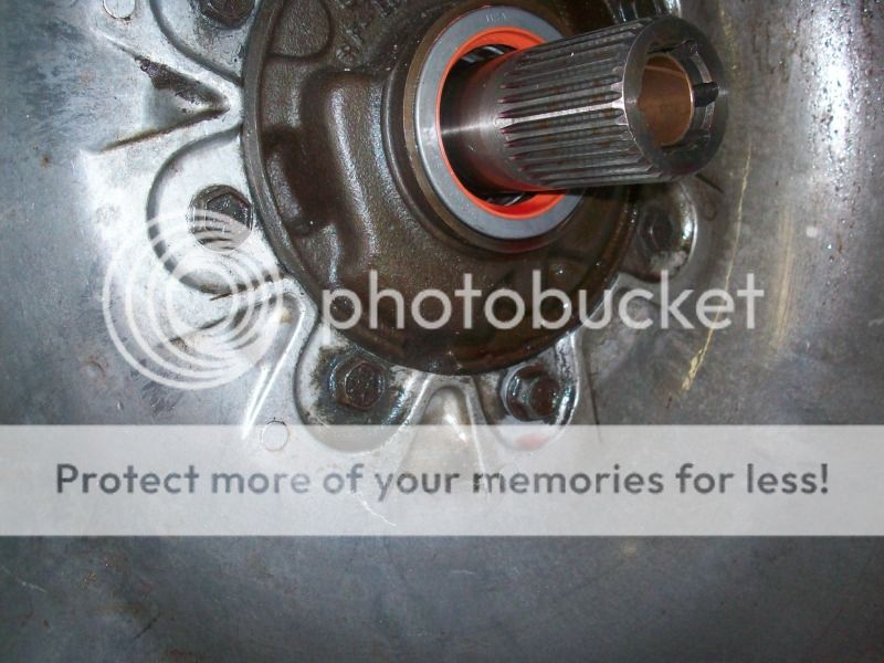

I take it apart and instantly notice things don't look right in the pump area.

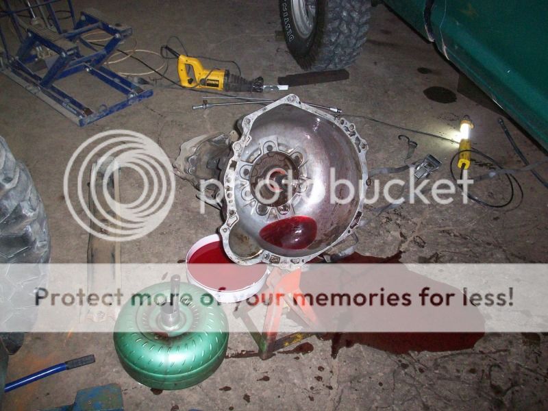

I take the bolts out slip the bellhousing off and the pump easily comes out with the bellhousing tearing the gasket. An ever so gentle love tap with a pastic deadblow and the pump came right out of the bellhousing.

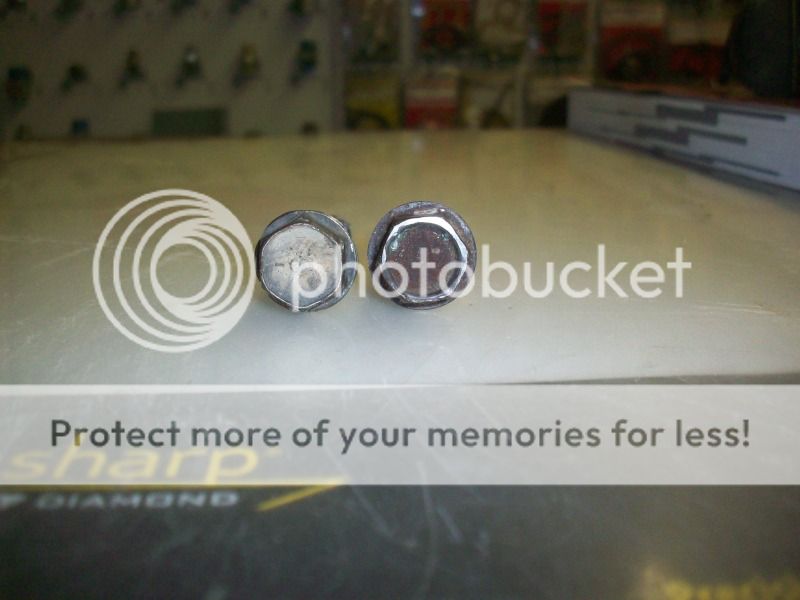

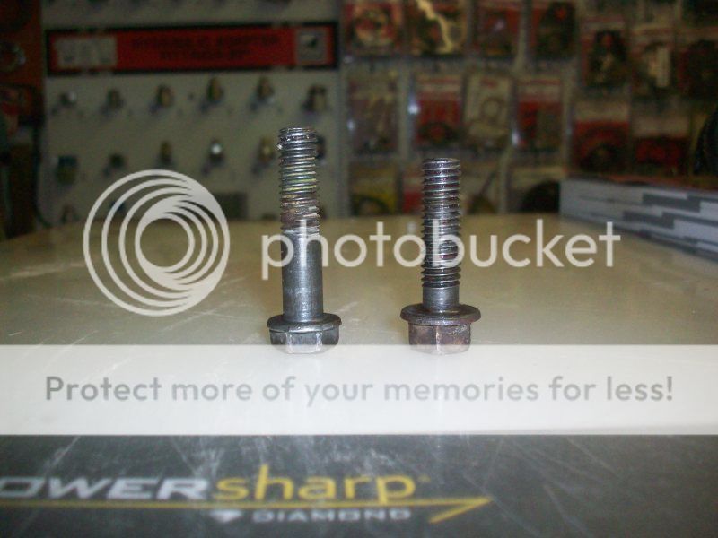

I get a new gasket, get everything clean and go to put it back together tonight. As I clean the bolts and set them on end on the bench I notice one is about half an inch shorter than the others. I probe the holes and cannot find one where there is a bottom remotely close to even the long bolts. I get on the net and look in my book and can find no mention of the odd sized bolt. So I go back to the bolt bin and find a flange head bolt and notice the head is quite a bit thicker... probably not a great idea with a torque converter spinning right there. So I go back to my morphadite bolt and notice the head is thicker... I smell a rat. Somebody lost a bolt and replaced it with a generic flange head bolt and one too short to boot. It would only get about 1/4" of bite into the housing, no wonder the thing couldn't hold.

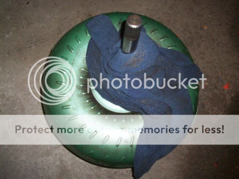

Playing with the bolt I noticed the bolt head was messed up from rubbing on something, go check the torque converter and sure enough it had been rubbing. I can't catch my finger nail on the scrape so I must have caught it just in time.

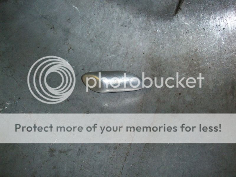

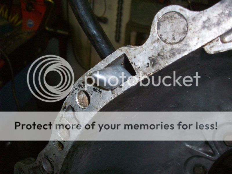

This is really odd, I was cleaning the bellhousing and found something in a cavity on the engine side. I thought it was a cocoon type thing but it was metal, feels to be aluminum. :icon_confused:
I cleaned it up before I poked it back in, it was way in the back though.
Near as I can tell it is either very odd flash from when the bell was cast or tumbling material from when it was cleaned at some point.
That looks like one of the stones/metal out of a tumble cleaner? either way its not suppose to be there so take it out. , i would suspect the bolts being loose
would be caused by improper torquing of the bolt from where somebody was in
the trans at some point in time...

Yeah, I knew it didn't belong although I can't really see where it would hurt anything. Kinda fun to play with though... I am pretty sure it is aluminum, it weighs practically nothing. Tumbling media is my best guess.
None of them were torqued to 20lbs per my book, I did it and broke one loose last night to sample it. I do think the major problem was one would barely start into the transmission case because it was too short.
most likely, dont forget the lock tight, then you dont got to worry about it...
