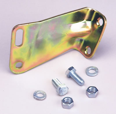

Did you have to order a throttle linkage adaptor for the gas pedal to be able to hook to the carb or did the carb come with it?
I looked up your carb from the link in your swap thread, and it says the linkage is universal but that doesn't tell much.
Here's what I'm talking about
http://www.summitracing.com/parts/edl-1483
Sent from my rooted SPH-D710 using Tapatalk 2
That is just for the kickdown on an automatic.
I got suckered into some stupid "universal" bracket for the throttle cable, it was a flaming POS. I hogged it out with a die grinder and bolted it to another plate to work and it did work pretty good. I ended up finding a stock bracket off of a 302 Mustang II that looked much nicer (it was also cheaper and didn't require any modification to fit) Pretty much any 302 with a carb will have the bracket you need.
I have no idea what the point of this thing is, it came with no instructions. The holes didn't match anything on the intake. :icon_confused:

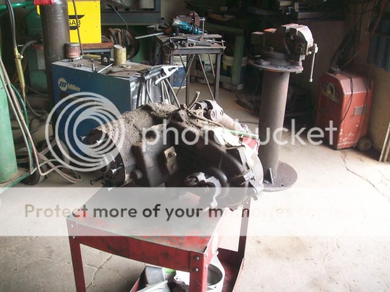

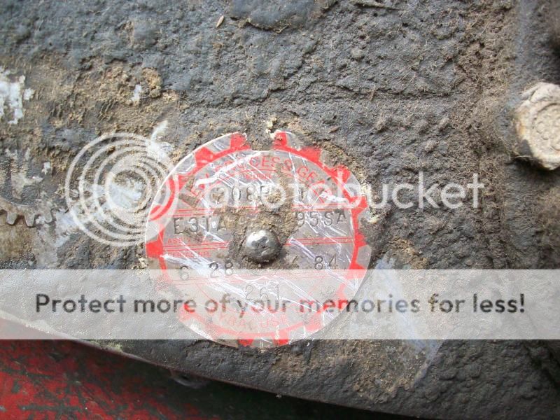

Found an '84 Bronco, 351W some sort of automatic... with a floor shift t-case. So I crawls underneith to investigate further, scrape off some crud here and some crud there... New Process 208F. :yahoo:
Of course I didn't have all the correct tools to get the thing out, a tranny jack would have been really nice. It doesn't look physically imposing and is herolded as being far lighter than a 205... it feels like it has close to 100lbs on a 1350. Granted I pulled it with the rear driveshaft and no doubt that adds to a t-case's natural awkwardness.
I also like the simplicity of its shifting, it is all straight and back with no dogleg in it to get to neutral/4low. While I do like the positive stop that the dogleg provides as a swap it greatly simplifies the linkage. I need a point to pivot the shifter on and a link that puts the shifter in a spot it doesn't hit anything and that is it. The shifter is also very long to allow for custom bending.

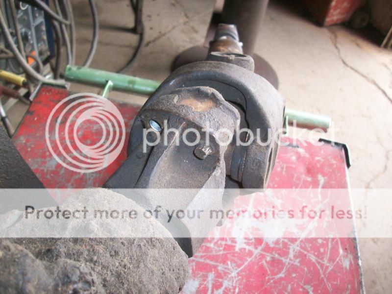

I didn't have 12 point anything, I worked out three of the rear driveshaft strap bolts with vice grips... but there always has to be one. I didn't know of anywhere around there go run out and get one quick and it was getting late... so I got stuck with a $40 driveshaft. Hopefully I can use it for the front driveshaft.
'85 Ranger Restomod
That should make a good front shaft.
Also you have fixed front and rear yokes, unlike me, I have a slip rear yoke.

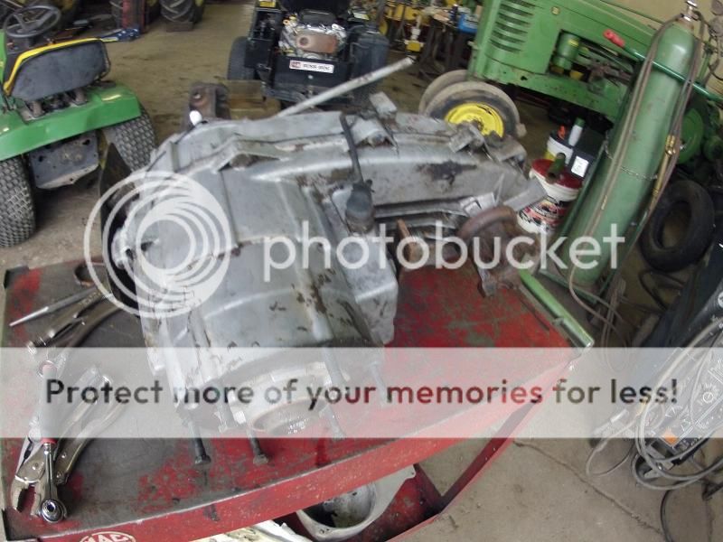

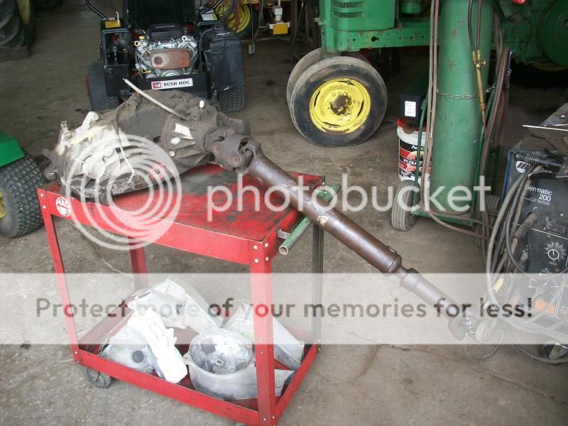

I posted the last post as I was applying liberal amounts of degreaser and high pressure water, here is some clean pics. I think it is undercoating dribbled all over it, I tried not to hit areas open (speed sensor, position switch...) too hard.
'85 Ranger Restomod
'85 Ranger Restomod
I dropped the fluid out of it, it was dark but clean (no water or filings) which speaks good of the rtv after I hammered on it with the pressure washer. I am really tempted to pull the rear housing off, split it and redo the RTV while I have it out in addition to putting new seals in it, reading in my big 1980 Chiltons it doesn't sound too bad. I really don't want another "oopsie" like my trans where I have to drop it out a year later because I didn't bother with it before I put it in.
I am also really tempted to paint it...
