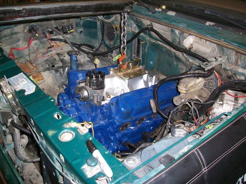

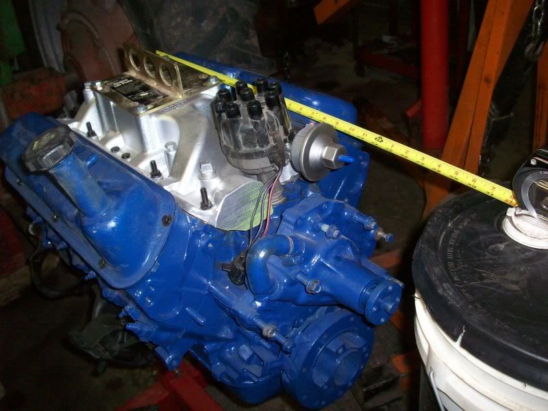

It was brought to my attention in the "belt drive system" thread that this FEAD doesn't really work well with the Explorer radiator. Since that is the radiator I wanted to use I wanted to check it out.
Of course this really rough, the engine measurements are from the back of the block to whatever sticks out the front the farthest. The 2.8 fan is barely on, so take off about 1/2" from its length. Engine bay is from the most protruding part (looked to be the passenger side firewall) to the radiator obviously.
Give it a couple inches of room between the firewall and the block and I think this radiator would be very tight for any FEAD the way it sits... that is if the FEAD wasn't sticking into it. Dunno how my engine will sit in there of course (maybe it won't be as bad as I think), you could get creative with a die grinder, drill and cuttoff wheel you might be able to tweek the radiator and get it a half inch farther ahead mounting the same way and run pusher fans (there is a shy 3.5" of room between tranny cooler support and radiator right now)
I will probably just try to stick the 2.8 rad back on, I think it might be narrow enough to clear. Then I can run it and see if this engine is worthy of a $400+ radiator or not. No point in having a new radiator laying around to get hurt if I gotta pull the engine back out. Not to drive it, just to start it.
Kinda crazy a brand new 4.0 rad is $100, one that is small enough to fit inside the radiator support is over 4x as much money...
