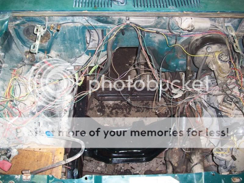

With the engine out I got the engine crossmember cleaned and painted.
85 Ranger getting some teeth...
I couldn't think of a better time to paint, especially since it kind of looked like bare steel.

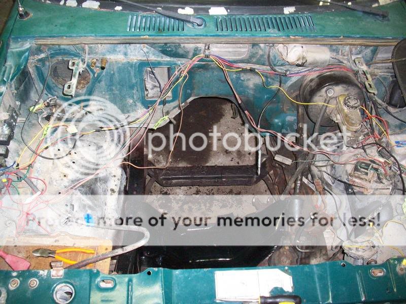

Broke out the sidecutters and eliminated all the extra wiring. I had everything I unplugged tagged... and didn't cut anything that was still plugged in.

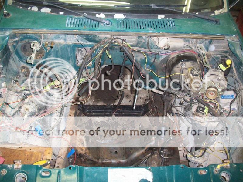

I got the engine and tranny hauled to shop so I can start getting them ready. I couldn't resist sticking my carb and air cleaner on for giggles though.
Carb (Edelbrock 1403) on my intake (Weiand Stealth)

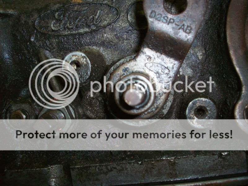

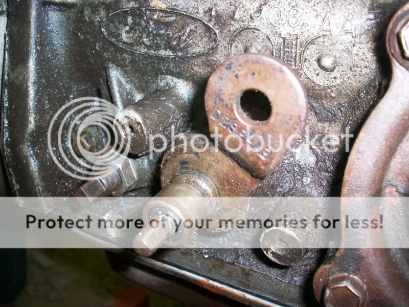

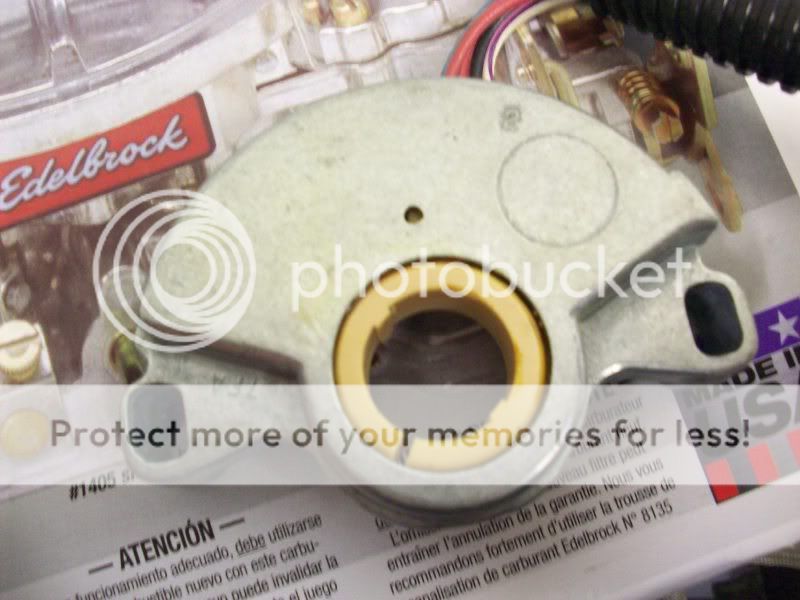

I did hit a little snag on my tranny though. I didn't get a neutral start switch with it so I orded one for a C5 and I don't see how it will work. The transmission isn't notched for the tabs inside the switch. I have been looking up different years of C4/C5 and most come up with the same switch or something drastically different. I am not sure how it would work without the tabs anyway... any ideas?

Any ideas on my NSS situation?
I have a C4 that has the notches, can I swap those parts to use it?
While cleaning up the engine bay I found a plug that fits the NSS perfectly, so I kinda want to use it if I can.
Well I looked up the bracket last night and since it appears it is darn near the last part out and the first back in it looks like I am not going to have a NSS.

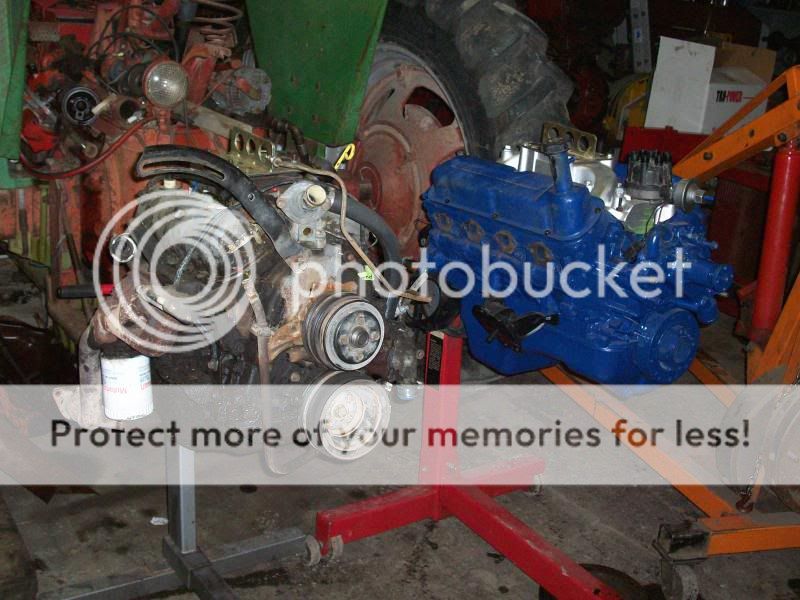

I got the rear seal changed and the better seperator plate stuck on so I didn't forget. I also put the 302 on the shop's stand and my 2.8 on mine until I decide exactly what to do with it.
I'm using a B&M shifter that a NSS built right in as well as a back up switch....Just a thought....
What shifter do you have? Any pics?
I have the regular C5 shifter, but really I am not quite thrilled with it. The base floorplate has been hacked up for some reason, they cut out the part that holds down the 4wd boot, and the knob is kind of nasty... I don't have the proper bezel for it. I will probably just bypass the NSS for now and regroup after I get the thing running.
