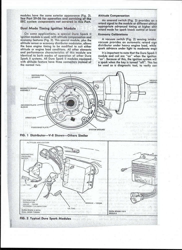

A 2.8 duraspark distributor is from the years when power wasn't as important as emissions compliance, you can probably improve it more by recurving the centrifugal advance. With the engine running, a timing light attached, and the vac hose removed and plugged, slowly raise the rpm's while watching the timing advance. For best performance you want the centrifugal advance all in by around 3000. I'll bet it isn't, my 77 Mustang distributor wasn't all in until 4500 rpm's. The centrifugal advance mechanism is under the breaker plate and you can tune it some without a teardown. There is a rectangular hole in the breaker plate( not really a breaker plate but it's what the stator bolts to) and with the distributor rotated by turning over the engine you can see the tabs that anchor the springs. One spring will be fairly stiff and ride loose on the tab, the other is lighter and should be at least slightly under tension. If you bend the tabs in the direction that loosens the springs it will advance faster, I'd try just the tab with the stiff/loose spring first. Go easy, one tab at a time, a little at a time. You can see the hole in the attached picture.

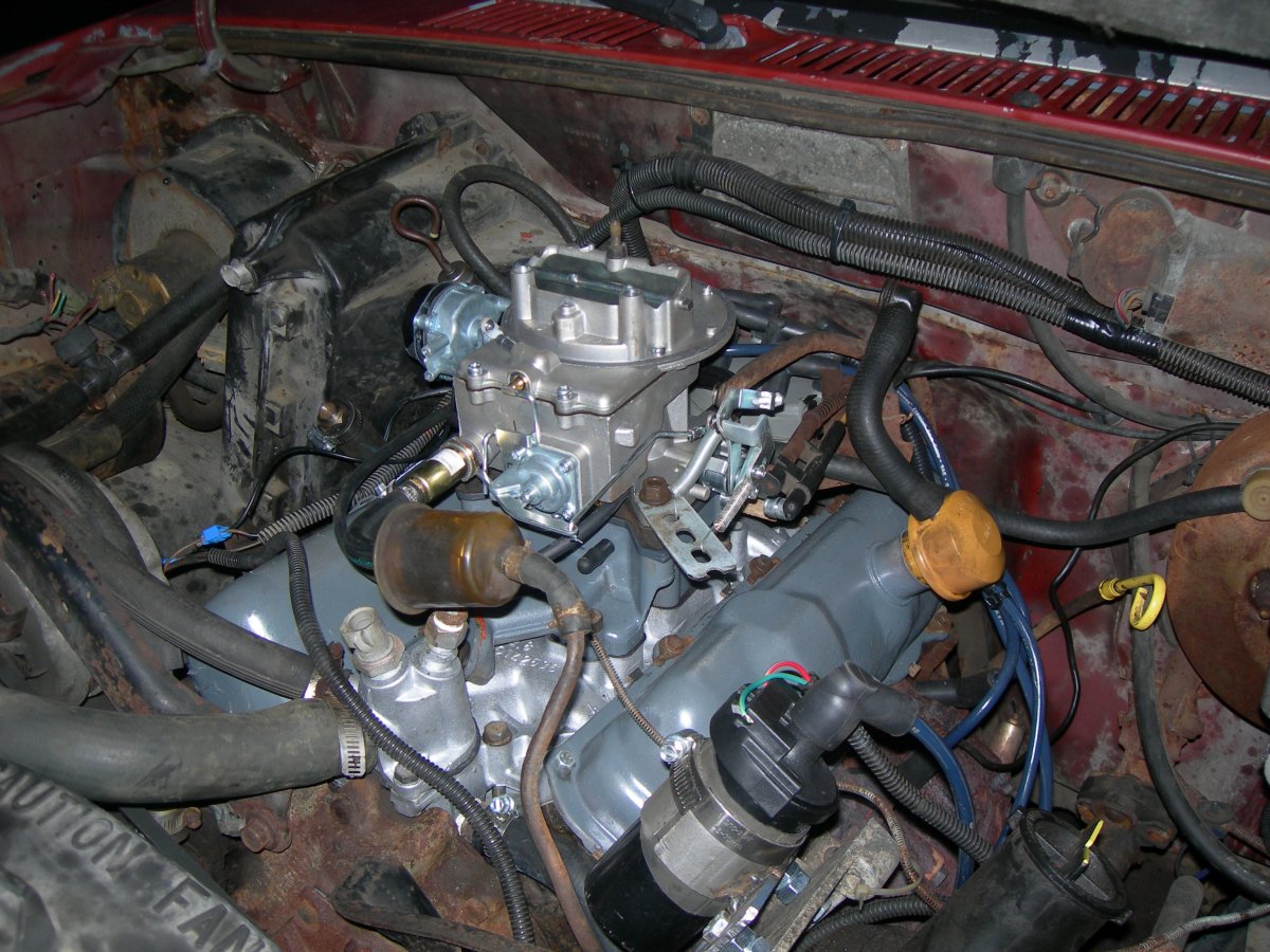

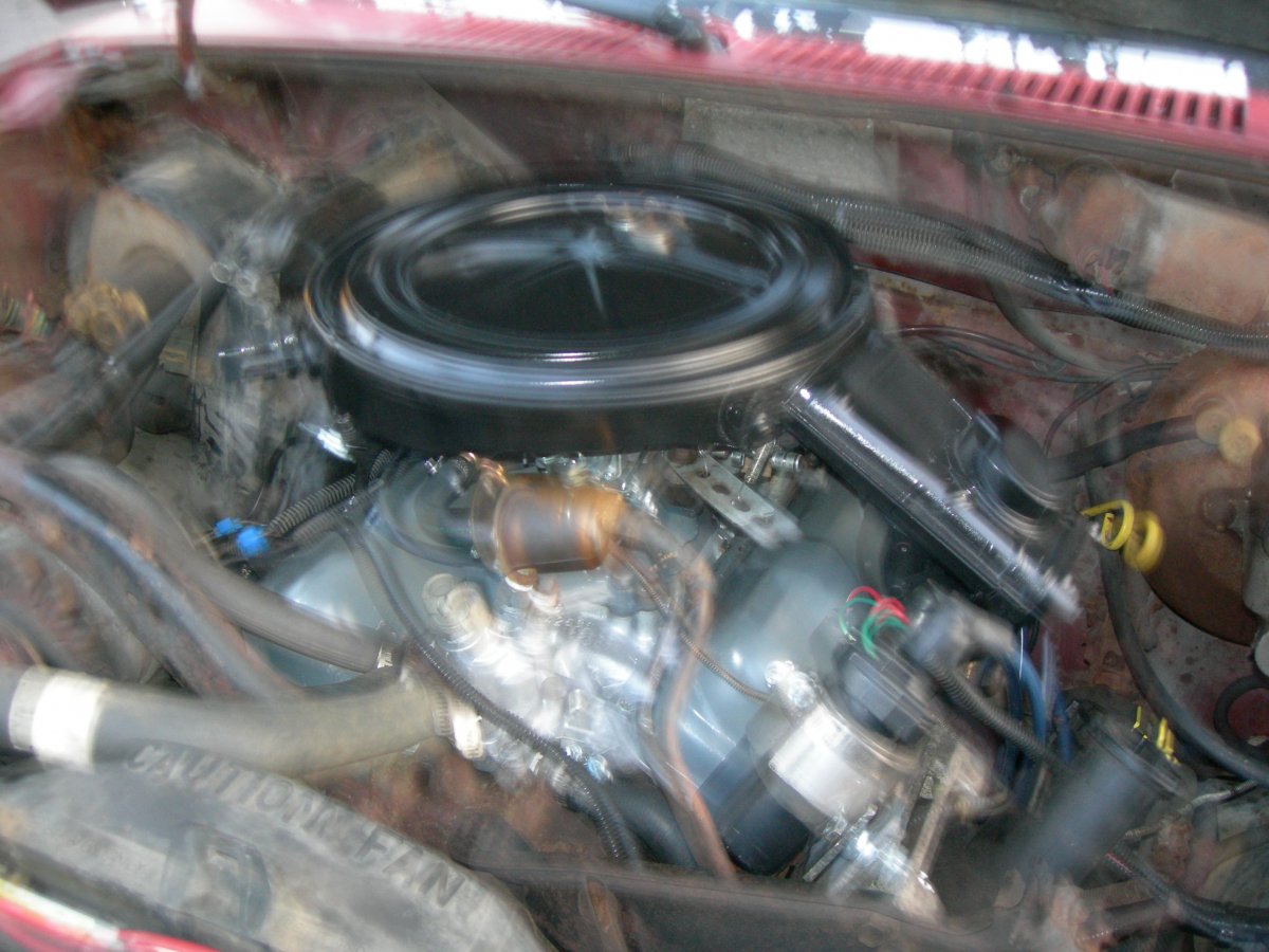

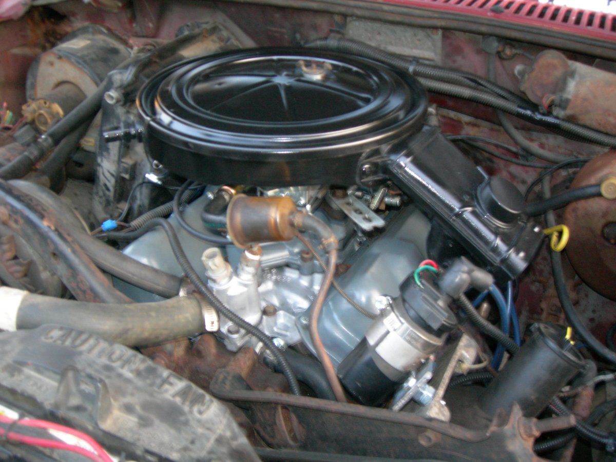

so above are what it all looks like, she's not pretty, but it gets the job done and runs 100 percent better after the conversion!!!
UPDATE: small storm rolled through today and had a whopping 1.5 inches, enough that i had to scrape our community road off and salt....we have large hills, but the B2 performed flawlessly........best it's ran in years!!! conversion was well worth it!!!
Ford guys aren't supposed to be surprised when they run right.
no, we're not....but when you buy a cheap china 75.00 carb.........you expect it to have issues and not work, but this surprised me at how well it runs and works with very little adjustment.......this has breathed new life into this truck!!! :)
Thanks for the pics. You did a good job with the conversion, and I like your B2; bet it makes a good plow truck.
Change the inline fuel filter please, that thing's as dark as a politician's soul.
